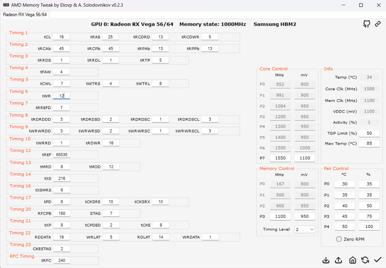

  1. I know this thread is a year old, but this is literally the latest active thread on vega 56/64. To start I also have a Powercolor Red Dragon 56 that already has a 64 bios on it. Is there anyway that we can push HBM voltage apart from physical mods? I can get my card up to 1150mhz hbm stock; relaxing the timings I can reach 1200mhz, but not stable in stress test, but enough for Helldivers 2. Although I run 1100mhz as I can tighten the timings really well here. HBM temps seem to max out at 55c-56c. My core clock is kind of crap as even at 1.2v @ stock 1630mhz it crashes on my stress test so I'm assuming bad bin or needs better cooling. I'm about to put liquid metal again on the card so I'm hoping I can get the hbm temp max to around 50c, but truthfully on I'm expecting 2c-3c drop. I've been trying to stabilize 1200mhz, but the timings are so atrocious that the synthetic benchmarks put the speeds lower than my tuned 1100mhz.
