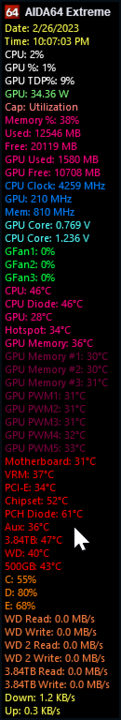

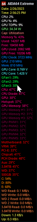

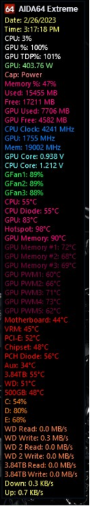

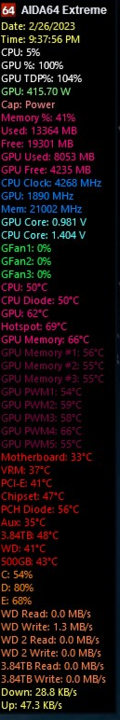

  1. I haven;t had a chance to write things up but here are some results I got. between a 20-30C drop in temps across the board. All load temps were taken after 20 runs of speedway in 3dmark after 30 minute preheat using heaven benchmark. Before Idle: GPU: 30C Hot Spot: 37C Memory: 38 Other memory temps: 31C VRM: 32C Load temps before: GPU: 83C Hotspot: 98C Memory: 90C Other memory temps: 68-72CC VRM: 60-65C Hotest 73C With AIO: Idle GPU: 28C Hot Spot: 34C Memory: 36C Other memory - 30-31C VRM: 31C Load GPU: 62C Hot Spot: 69C Memory: 66C Other memory temps: 55-56C VRMs: 54-66C - 66C highest. Here is idle before Load temps before idle temps after Load temps after
