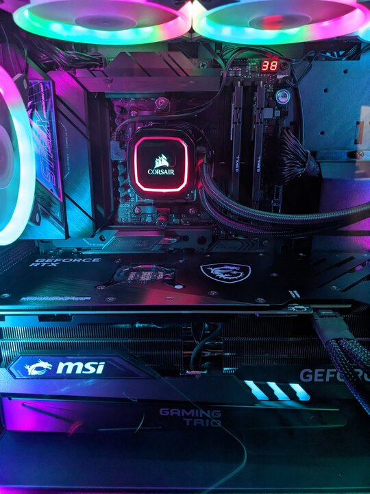

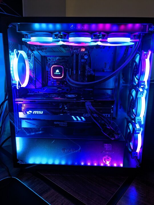

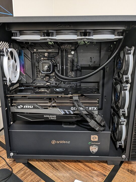

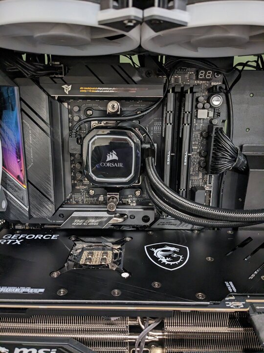

Sorry for hijacking your thread Nikado.
We rebuilt Ai Crystal yesterday from 2pm til like 8pm. Actually, to be fair, my wife rebuilt it. She took the old Arctic rad out, took my rgb fans off it, put them on the new H150i (we tested and yes the Arctic would not fit because of the top heatsinks on the board), she removed the old board and put the new one in, and she did cable management and did a particularly great job at hiding the Corsair fan splitter cable, power cable, and Corsair Link cable.
I basically just put the new CPU in the board, the RAM in, and took my boot drive (m.2) out of the old board and put it in the new board under that giant heatsink. I did a lot of walking back and forth to bring her tools etc. So my legs and butt are quite sore. But it's done.
Best part? I use Linux as my main OS and despite it throwing some errors that seem to be related to USB when it boots, it loads fine. The board has an Intel I255-V 2.5gbps lan port and I was afraid it wouldn't be supported. Well, on first boot it was there in the system tray and I set my static IP and tested streaming anime to my Pi and it worked perfectly. All drives showed up etc. The funny thing is that the Ethernet adapter did NOT work in Win10, my wife had to get the drivers from Asus website and put them on a flash stick, lol
I can now answer your question about the Q-Latch: it's basically a round plastic button on the right middle of the board that when pressed will release the top pci-e slot clip.
Anyway, I have it set up with PBO and memory OCed to 6000Mhz cas 36. Unfortunately, with the memory OCed, every time I reboot it hangs on a 15 post code for like half a minute before proceeding to boot. Hopefully Asus fixes this in a later BIOS.
There's my update, sorry it was long. Here's the pictures:
That card is huge lol.   It all looks good.  I keep reading that Linux loves the x3d's.
