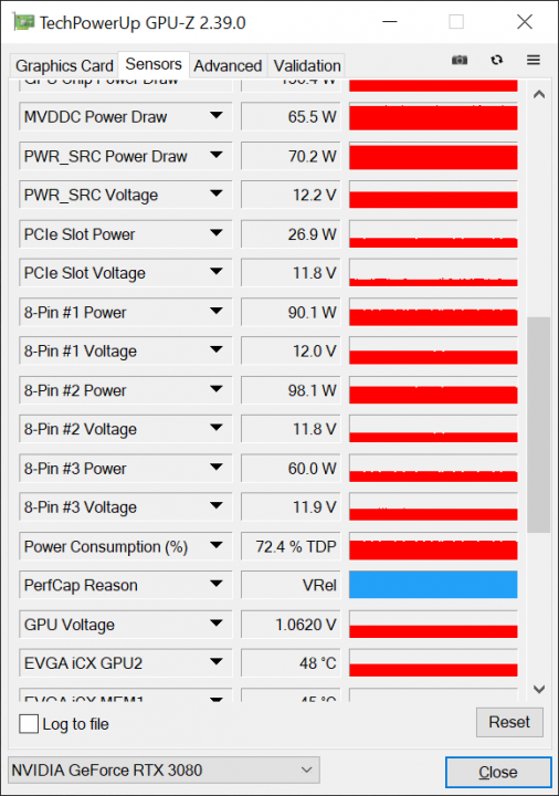

Am I seeing a problem with 1 of my split 8 pins? I'm using a split stock 2x 8 pin cable and a 2nd one that only has 1 of the 2 8 pin plugs in use.
or
Is it just too much power for the hardware?

Vrel perfcap is voltage reliability. What PSU are you using? Single or multi rails? A 3080 really should have 2x8 pins not split with anything.
Is the card on a riser?
Your explanation of your wiring is confusing. Can you snap a pic of the config?
It uses 3x 8pins, but I did try 1 plug from each + 1 from my bench PSU and there was no change.
https://www.pcpowerandcooling.com/product/silencer-1050/
