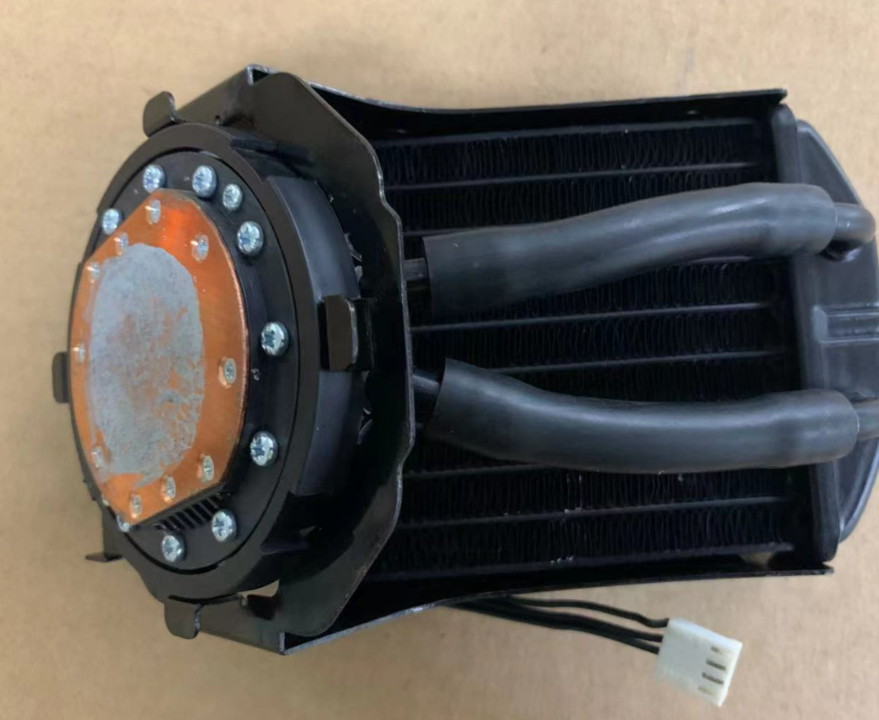

I found the perfect prototype for testing. This is a z820 liquid cooler and it's ultra compact design lends itself well for being a test bed for Galinstan. Also, since it's so compact it wont require very much liquid metal for the tests to proceed.
Image 1 - HP Z820 Liquid Cooling CPU Heatsink 635869-001 002 003
I am buying a couple vials of Galinstan (which is nearly identical in composition to LM thermal paste mostly gallium, some tin and one other alloy) and should be able to keep the costs under $100.
The z820 liquid cooler has two lines coming out of the back of the radiator, down to the pump, making it very easy to drain the old coolant and replace it with gallium.
I suspect the HP radiator is aluminum so these will be short and quick tests to measure baselines under stress loads.
If the performance data looks good, I'm going to go ahead and purchase a couple of these copper rads to replace the pre-existing rads. at that point we will have to just monitor the pump and make sure flow rate is good. ( can add another pump later if needed)

Oh that ways less than i was expecting!   The worst part i think is corosion because i don't know if Copper rad are really 100% copper. I know that liquid metal can corrode copper/zinc a little that why some people have to sand down heatsink before reaplying liquid metal.
Performance wise i think the waterblock may be an issue. Since the liquid metal is thicker i dont know how the flow gonna contact with the surface of it without just bouncing back on the Galium already in contact with the fin.
I have not dismantled the z820 cooler yet so I don't know what the water block looks like but I'm hoping it will be fine for this purpose. I know it's full copper, so that's good.

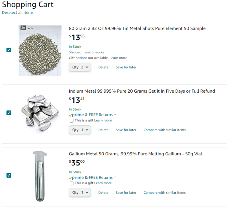

Just ordered all the ingredients I will need to make Galinstan.
Good down to 32*F. So I can use the chiller, or at least test with the chiller and see what we get.
  • 4 months later...

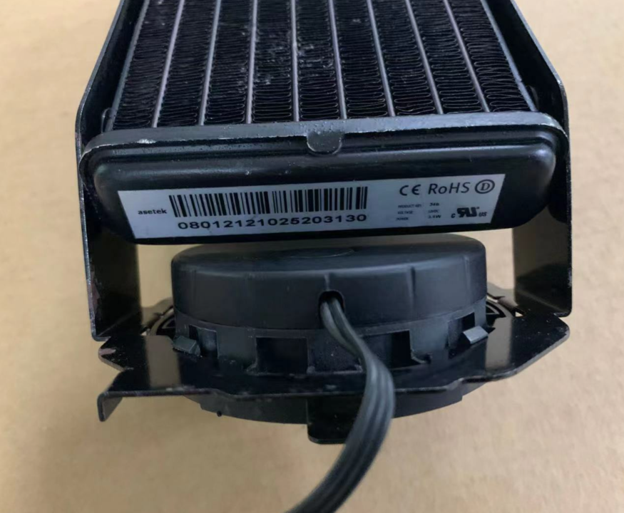

Just picked up the last of the gallium I need to fill the cooler.
I will be using a Z820 water cooler for this. It's easy to open the loop and it's a very low volume system, so I don't need a whole lot of gallium for this test.
I converted the gallium to Galinstan by adding a quantity of tin and indium. It should now be good down until about 40*F.
