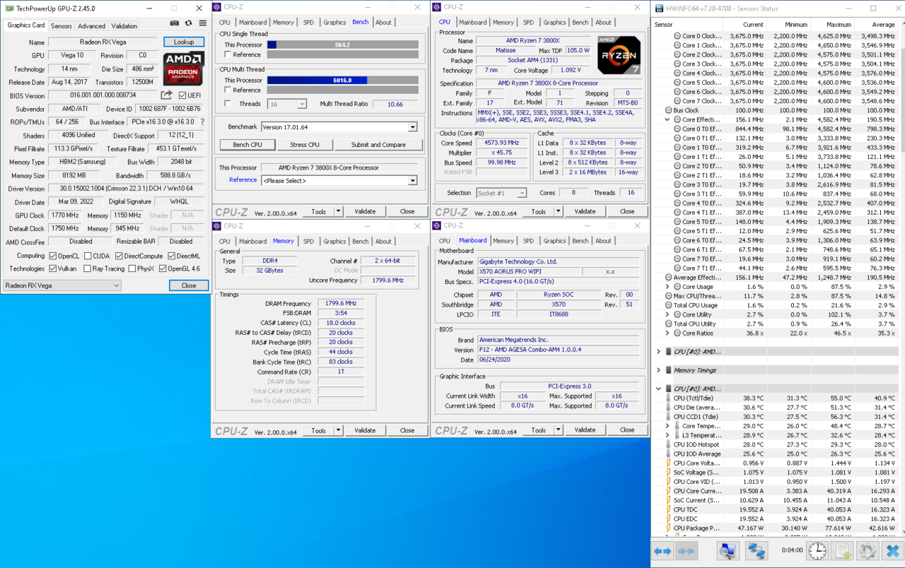

  6. Whelp I wanted to add my CPU into the mix. Nothing too fancy. A 3800X. However I am not manually OCíng. I am running PBO with a 10x scaler and 200MHz offset. And undervolting with -0.05v. My ram is at xmp settings of 3600 18-20-20-44 2T. Which is basically already full afterburner for Sammy Cr@p-dies I mean C-dies. I broke 6000. Really proud! 4650Mhz max boost. 4.4-4.55GHz all core depending on the stress. (13754CB R23 for reference.)
