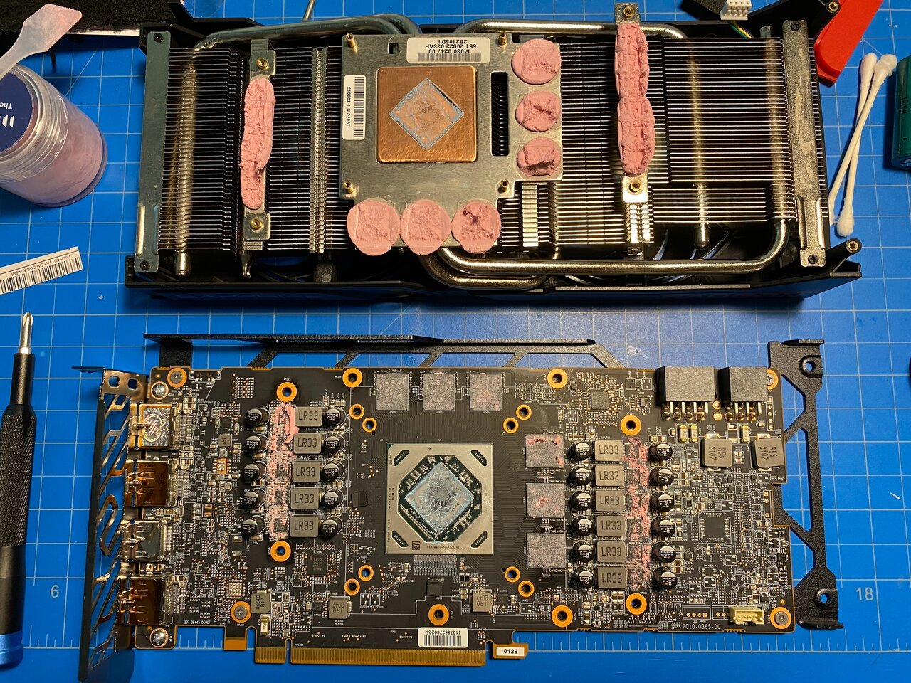

I'm also a big fan of thermal putty as a pad replacement. It removes all the guesswork and allows for the best possible contact and pressure on the core. A very common issue that people run into when upgrading to high performance pads, is that they are more stiff / harder to compress than OEM. Even if you get the proper thickness, they can prevent optimal core contact. Good putty matches or outperforms high end pads, so there's really no downsides AFAIC. Sure it leaves a bit of residue, but high end pads do as well. IME, it's easier to remove and clean after it has been on a card for a while, because it will stiffen up a bit and come off in complete pieces. Depending on the age, you may be able to reuse it too. You can knead and mix it back together to soften and even out the consistency. Not too long ago, the only decent choice was TG-PP10, but it has since been discontinued. Fortunately there are quite a few options on Aliexpress that outperform PP10 now. Snarks Domain on YT has done some nice testing of different putties. Based on his results, I snagged some U6 Pro and it has been great. More gooey than TG-PP10, which I'm not super fond of, but once it bakes for a while, it becomes more cohesive. (I take my cards apart a lot for experiments. lol) Just today I got in a shipment of CX-H1300 because I wanted to try one of the cheaper less hyped products. The consistency is more like a non-Newtonian fluid than U6, and it isn't nearly as gooey or sticky, which is a plus. It's very dense like U6 Pro and I expect it will perform about the same. Will update when I test it on my 6700 XT. Here's how the paste print looks with perfect contact. The unevenness is caused by the warped die. It may not look that bad, but putting a razor blade on it shows that it's far from flat EDIT : One other great product I forgot to mention, is PTM7950. It's a paste alternative that comes in a 0.2mm sheet that you cut to size. It starts to melt above 45c, allowing the excess to flow out and creating a very thin bondline. The big benefit is that it doesn't suffer from pump-out like regular paste, and can maintain its performance for a very long time. It will actually improve over time as the bond gets thinner from heat cycling. With air cooling, you can reach ~95% of the performance in just a few minutes of Furmark with the fans turned down. In my testing against KPx paste (which performs identically to Kryonaut Extreme in Luumi's tests), the PTM runs about 2c cooler after giving it time to fully seat. With water cooling, your results may vary, since the block may never get hot enough to allow the PTM to achieve optimal bondline thickness. You could try turning the pump and fans way down, but I'm sure some people wouldn't be fond of letting their blocks and coolant get above 45c. If you're interested in PTM, I got legit stuff from "passionate girl store" on aliexpress. It's much cheaper than other sources. Here's an Nvidia engineer discussing the PTM used on the 4090 FE :
