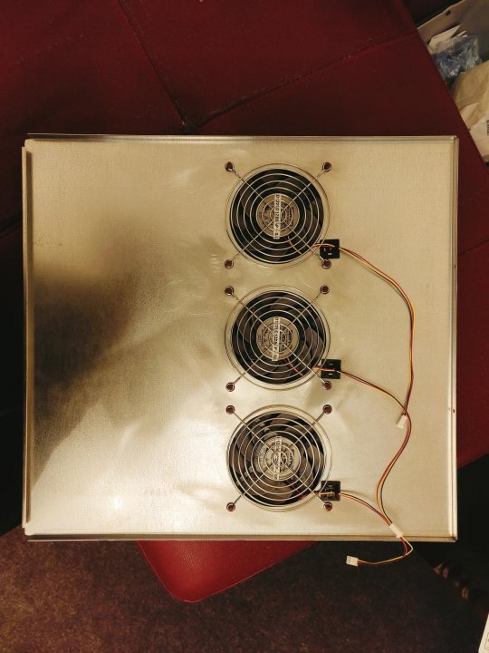

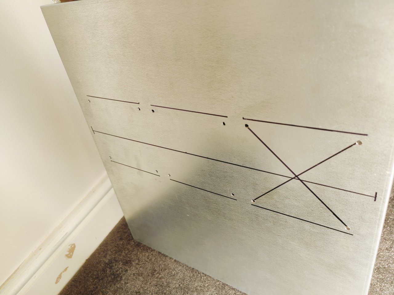

Now as part of a cunning plan, im modding up the lid panel so I can pop in 3x120mm fans. As not a lot of heat rises out of the case as it is pushed through the back, im initial thinking of having these fans blow down onto the GPU's. Either way the fans position will be central over the GPU allowing for airflow to blow down directly on the GPU core section. May make no difference at all, but it should help cool down the back plate exterior of the cards.

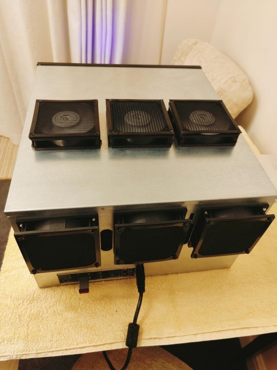

An update for my fans... lol.
So a little case modding later, installed 3x 120mm Gentle typhoons into the lid and it made a huge difference. Even with the small fans I was hitting 75-80 but now around 64-66c.
Clearly the cool air blowing directly on the exterior of the gpu and the backplate help's.
That's a great improvement!
And it beats turning all those fans around :classic_laugh:
Too bloody right!

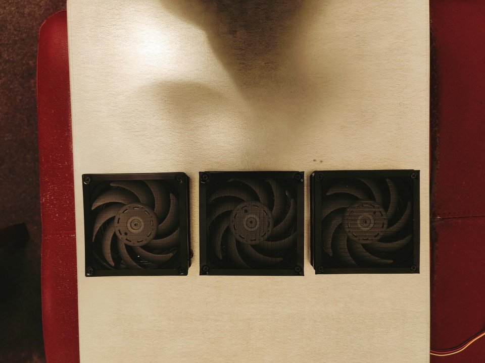

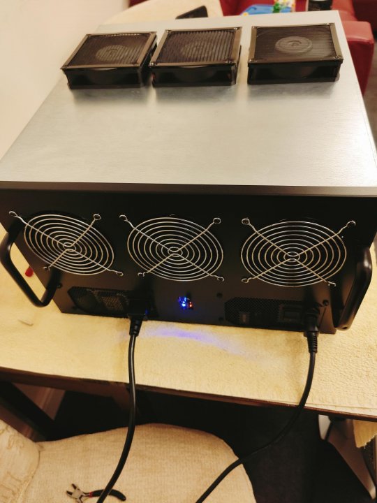

Update time.
So I am pleased to say that we are virtually there now, modding of the lid is now complete with its dust filter and grills. Grills are in place to stop any loose wires from getting snagged up in the fan if anyone was wondering lol. What you see below is pretty much the finished article, now just to set it up. Did I mention this things weighs a fair bit lol.

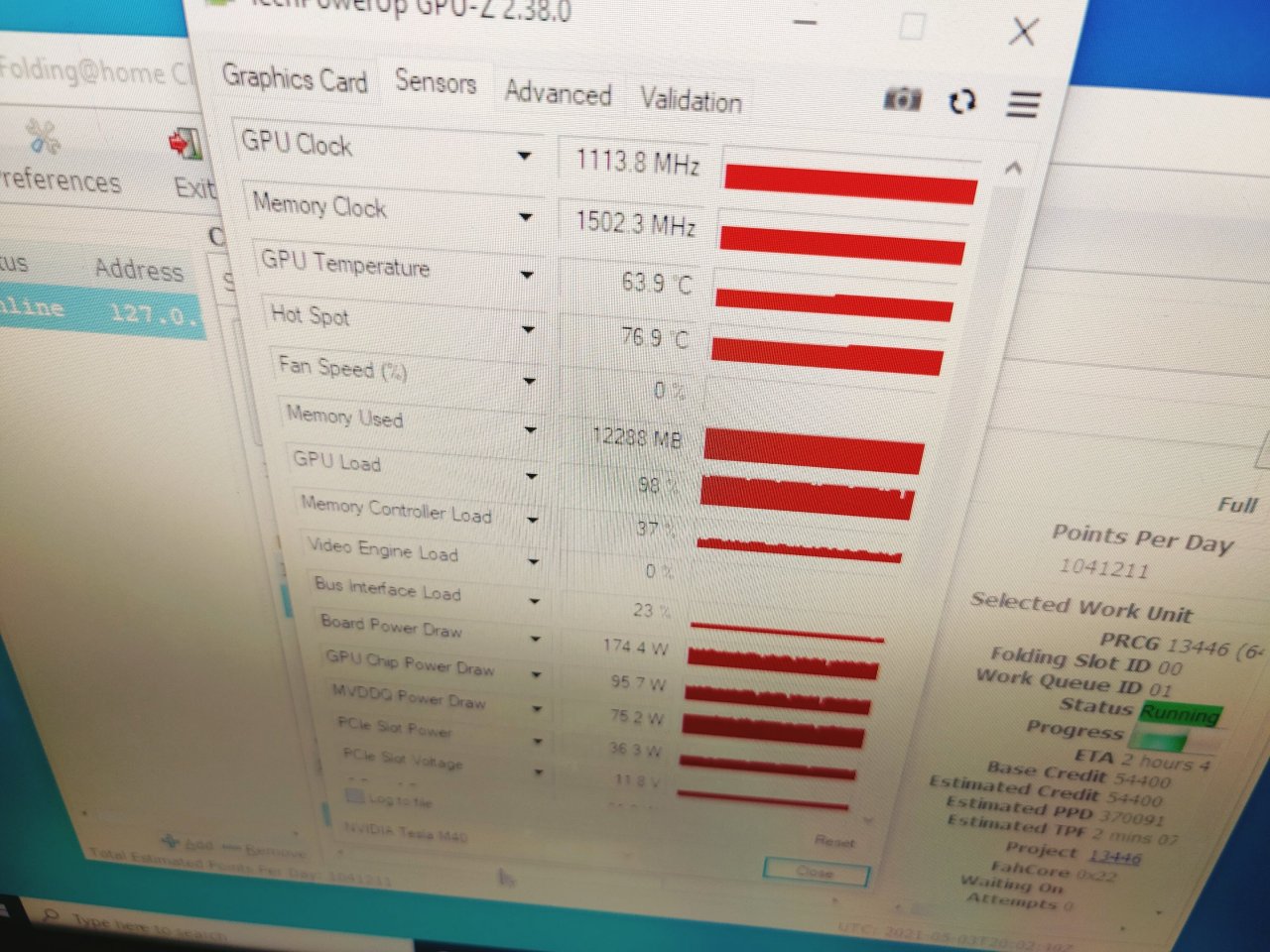

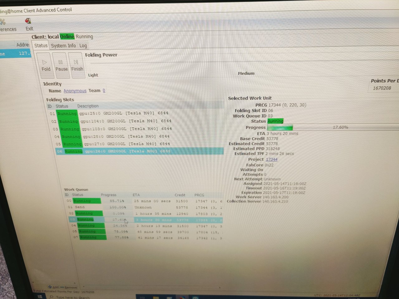

Question my good chaps.
Now this is possibly down to having a tougher work unit, however I am getting between 1.3 and 1.7 mill PPD with all cards folding, all at max clocks as I did check. Took a quick snapshot as below.
Is the project listed in the client one of the tougher ones ?
Fyi this is a vanilla install of the client, so there are no flags/optimization set. Are there any I should consider ?
Wondering if I should check to disable RBAR.
If needed I will dump logs on my next test run.
1st, double check that you have your passkey saved. It really looks like you don't have your passkey on, or you might not have reached the threshold to gain your early return bonus yet.
2nd, change preference to COVID WU's (It may not assign them, but helps) I don't immediately recognize any of the current WU's you are crunching. The 14300's are the bread and butter on the M40's.
3rd, make sure you are adding the advanced string to each GPU. I don't run Beta string on them. "unit_type:Advanced"
4th, These cards take forever and you really suffer when you download the next projects even 2 minutes before completion. You are going to want the string "next_unit_percentage:100" so that your new units don't DL until the previous is finished.
Can you give a GPU-z Screen shot of the Tesla's? Make sure they have the box checked for CUDA and aren't running Open CL. I had a few driver issues early on that I had to deal with.
There is no difference between base credit and estimated credit, though you are finishing them in time. So like Avacado said you are missing the QRB, most likely because of missing a passkey or not enough units (10).
Besides that you are also folding for Anonymous and team 0, might want to change that :classic_tongue:
Thanks guys.
Will make those changes. I always forget about the big difference the passkey makes along with the minimum WU submission. Will also pop those flags in and take a look at GPU-Z to make sure CUDA is being used and not OpenCL.
