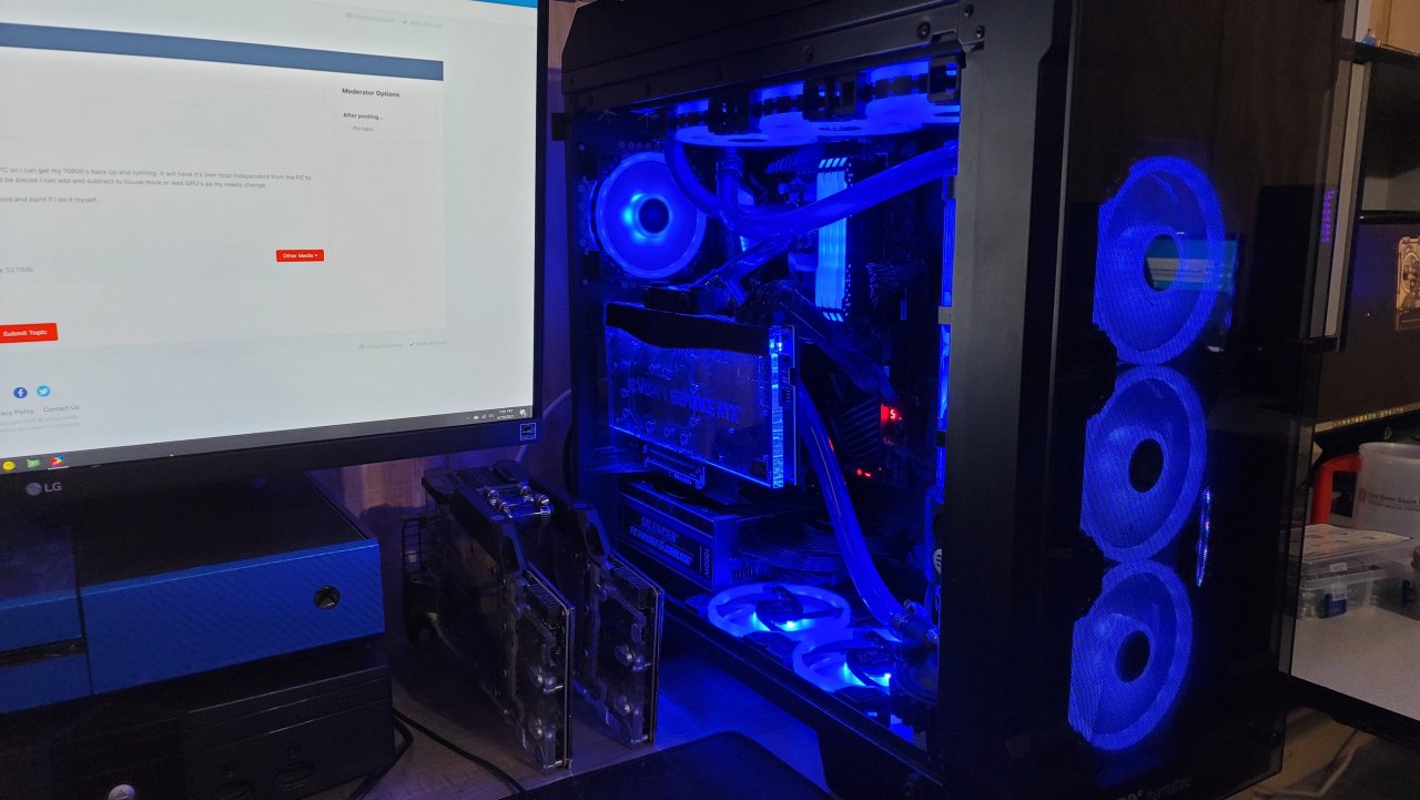

Well, I ended up settling for these because they had a 50% off promo. (I'm a sucker for sales) Now I'm looking at those splitters and thinking this could expand! I'll have to take a minute and do some math and research, but this whole concept will be an ongoing project of mine. I kind of like the idea! I'm going to get these on Friday though, put 2 in, hook them to the ti's, then see how it all gels.
Got 4 because I have another PC that I'll likely do the same thing to when the 3090 arrives.

That looks like a good deal. Damn, I might buy a few. Is 30cm going to be enough for your needs?
660
Yeah, should be an inch beside the PC. The run from slot 2 was 10.5 inches to the desk and under the glass door.
I think I'll prop the GPU's up a bit for plug access.
Might even flip them so the plugs face me for vr stuff lol Yeah, no.

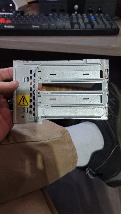

@Avacadotell me about this GPU rack you're getting.
I have a few cases that are pretty much scrap, so I was thinking I may cut them and make a gpu mount or 2 out of them and some wood. Anyone ever do such a thing in here?
3.50
GPU: EVGA RTX 3090 FTW3 Ultra
The 2 cases are from the Tesla thread, post from April 1
The only case I ever built myself was made out of cardboard when I was a teenager.

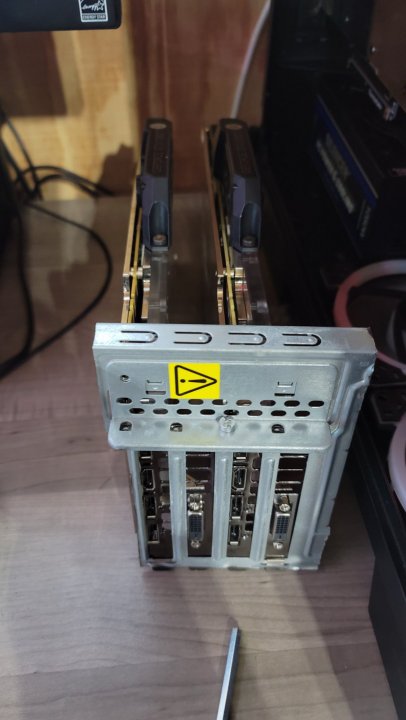

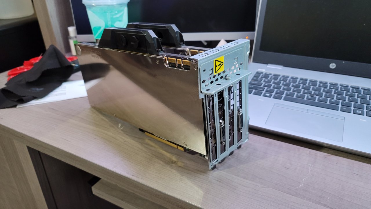

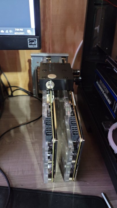

41 minutes ago, franz said:
A little late to the party, but HighSpeed PC has tech benches and junk.  I have 3 of them so far.
Here is something that may suite you @BWG
https://www.highspeedpc.com/category_s/1844.htm
OMG Yes! I know I cut that case up, but not having a slot in between them required me to use a distro block to easily connect them. That led to a whole nother issue that came to light yesterday when I tied them into the loop. When I broke those block screws free, I heard that awful cracking noise, and I tested them out, and they both leak at the terminal. One of the screw holes on each looked a little black too. I think the prior owner torqued them too tight when he took them off to clean the blocks.
Luckily, I just bought 2 used off reddit for $100 shipped for both, so I'll go ahead and order one of these @franz and use it instead.

On 4/21/2021 at 1:27 PM, BWG said:
Oh boy. Gonna grind it down.
1 left allegedly... snagging after work.
Make sure you air pressure test that FC Terminal block before using it, had 1 before that couldn't maintain a proper seal.
660
How many PSI should I hit it with when I get it back together?
Hey, I'm going to have Spotswood build me a GPU bench custom instead of getting one of those things. Did you ever see his work? He used to give away benches in the FAT's on OCN.
