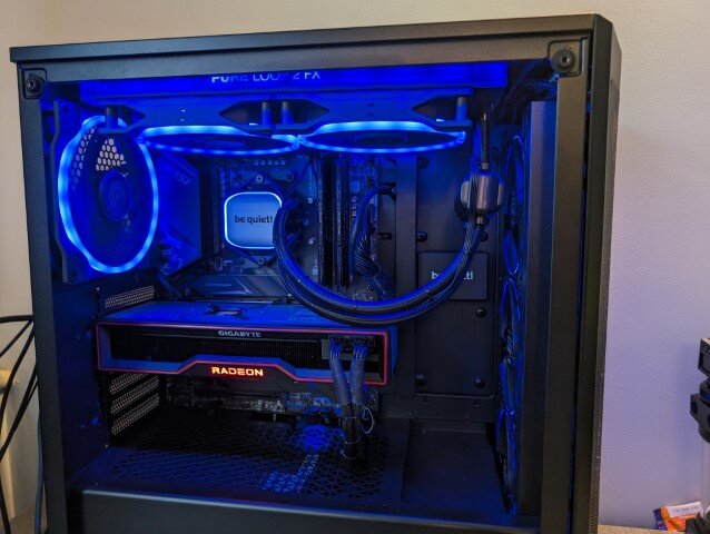

So I manage to get my hands on a 6900xt.
It my first AMD GPU and we are not getting along
I have a recurring issue where my PC crashes while gaming, which is mostly Call of Duty Modern Warfare 2019 at the moment, but a crash did occurred while playing F1 2020 the other day. A crash can happen at any moment. When it happens the game freezes for about 20 seconds, before the PC reboots. After the reboot the driver for the 6900xt  disappears (yeah!  I'm serious). All the sensors for the 6900xt on my sensor panel disappear too. Max temp on the 6900xt under load is 45-50 degrees.
What I can understand it is either a power issue or a driver issue. The PSU is an overkill for my system as its 1300 watts. So it cannot be an issue with a lack of power. The VGA power cables for the GPU don't seemed to damage too but I will check them with a volt meter tomorrow and for good measure I will swap the out for others if I have spares. I cannot repeat the crash while using bench mark software (3DMARK and Furmark).
Hoping if anyone could help my out with this.
My rig specs are:
CPU: AMD 5900x
GPU: AMD 6900xt
MOBO: MSI 570X MEG ACE.
PSU: 1300 Watt EVGA Super Nova G2
RAM: Crucial Ballistix 3600Mhz 32GB
CPU: AMD Ryzen 9 7900
GPU: AMD Radeon 6900 xt

As you know Call of Duty is alI I'm playing at the moment or F1 2020. It's only happened once it in F1. But when it come to resources F1 uses nothing compared to Call of Duty. I will probably load up CP2077 tonight and see if I get the same result. If I get a crash, I will roll back the driver. I always use DDU now, otherwise I'll get a tiny you in my mind tutting at me :D.
I agree that it's not a PSU issue, but could be the one pin has come loose for the VGA cables. I'm doubtful it's this however still worth a check.
I've gone into the game files of Call of Duty and lowered the VRAM usage, as for some reason it uses the full 16gb when should only needs 8gb.
I am currently stress testing the VRAM with OCCT, been on for an hour with no issue.
For the time being I have contacted AMD customer support hoping they will share some insight into the issue. I'll keep you posted.

Update
Rolled back to 21.2.3 driver.
Manged to play Assassin's Creed Valhalla for an hour with no interruptions. Played COD for 10min and it crashed. However the driver didn't disappear,

Another Update.
I think I found the culprit.
I have disabled a few programs running in the background one of them being AIDA64 Extreme and  have had no crashes tonight. I thought I ruled AIDA64 out last week. I will have a few more runs with the program disabled to make sure it is the culprit. It will be a bummer if it is as I used it as sensor panel.
