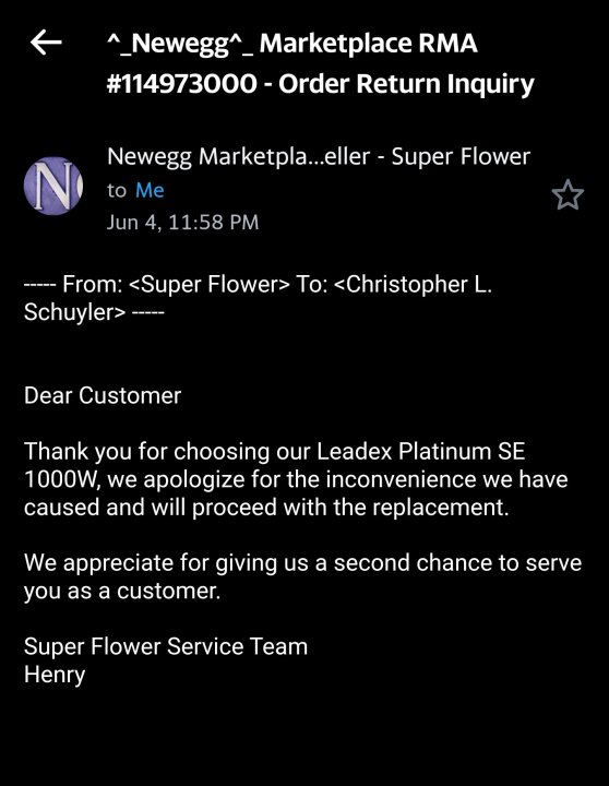

They have great customer support as well. My 4th SF was DOA, I returned it to newegg, no hassle and even got a personal apology message from a SF rep.
