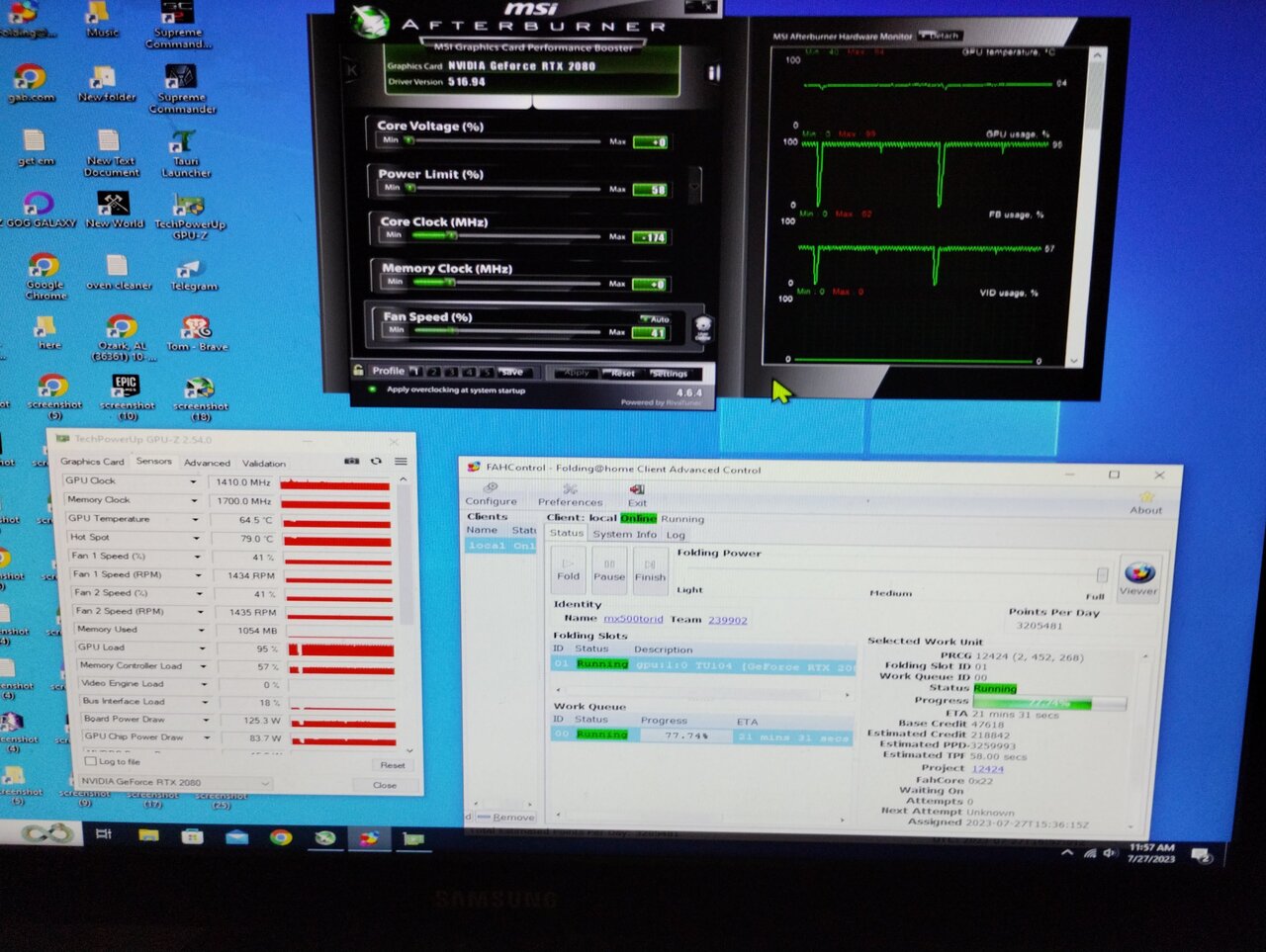

Thanks to damric for the idea. My 2080 went from 225 watts to 125-130 and ppd did not fall that much. Tower was pulling 220 watts.
Play around with lowering the memory clocks if you can. Folding isn't very bandwidth intensive compared to gaming or mining, so finding the spot where you can drop the RAM clock and keep the same performance will also save some watts.
