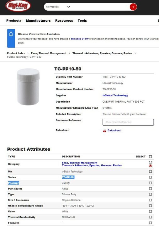

...for VRAM, VRM (not GPU die)...
To this day I still don't know the proper clearances to change out the terrible foam they used. I keep perusing the EVGA forums and I can never get an exact answer. I have two 85x45x1.5mm and one 85x45x0.5mm thermalpads (12.8w/mk) -- any idea which thickness goes where?
