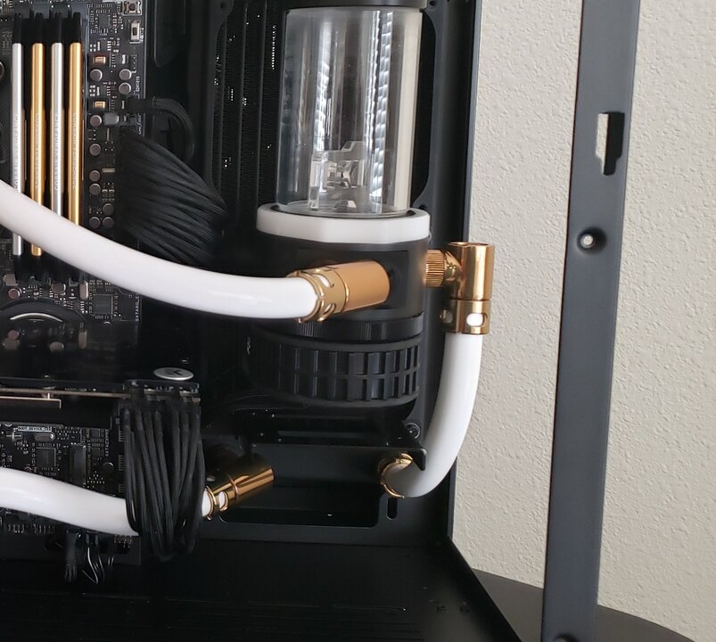

I have a drain port on my GPU right now. I'll let you know how to goes when I drain it.

I'll be tipping the case toward that corner when I drain it, but I don't see a reason for it not to work well, given my current setup. Retrospectively I should have just installed this on the other port on the left there, oh well. Will see how it goes come drain time.
It'll probably go back on the reservoir when I do the rebuild though as I will be mounting and orienting it a little differently, whereas this would not fit on the res as it is now, partly because of the way the 45 degree Monsoon fittings are, blocking one of the inlets from use. I'll be using different fittings for sure.
