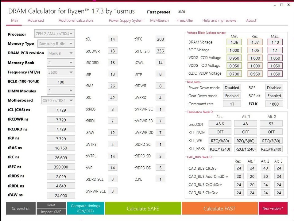

I am trying to find timings that will work on Samsung B-die ram at 3600mhz.  I have managed to get a kit of 2x16 to play with, but my Ryzen Dram calculator is spitting out some weird numbers I know won't work... like 0 cas latency type numbers.  So what I want to know is, what works for you?  Thanks will be given to all answers, even if they don't work for me lol... thanks for reading

Ok, problem solved.  I deleted my old Dram calculator and re-downloaded first just as a precaution (thinking it might have saved some settings)  Next I downloaded the freeware version of Thaiphoon and exported the xmp profile for my ram... next ran Dram calculator again and imported the xmp profile... hit calculate fast and voila, working timings.  I have included a screenshot in case anyone wants to try them.  Going from 3200 to 3600 gave a 5-10% improvement in many places I didn't even expect, like cinebench...

My kit is a cas 14 kit with stock timings of 14,14,14,14,34....  I actually managed to get the dram calculator to work finally... after a re-download and using Thaiphoon to get my xmp to import into it.  I still can't get 3800 working though even with the dram calculator finally giving reasonable numbers... I was thinking my Fclock couldn't hold up to the 1900mhz needed, but then I was looking at supported RAM for my board and there are no 3800 kits listed... just skips from 3733 to 4000 so maybe it's just my board has a "hole" in frequencies it can handle on the memory traces... IDK. but with the tight timings that I have now, I'm feeling pretty good about just keeping it at 3600 14,13,13,13,26.

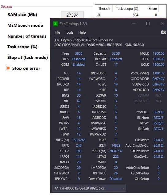

3600Cl14 is nice ! Just in case, you can try the timings below which work on both my native 3866 and 4000 kits, noting that a.) I'm using 4x8 GB B-die and b.) you might want to relax tRFC/2 a bit compared to below to begin with, and then tighten those w/ intermittent testing.
