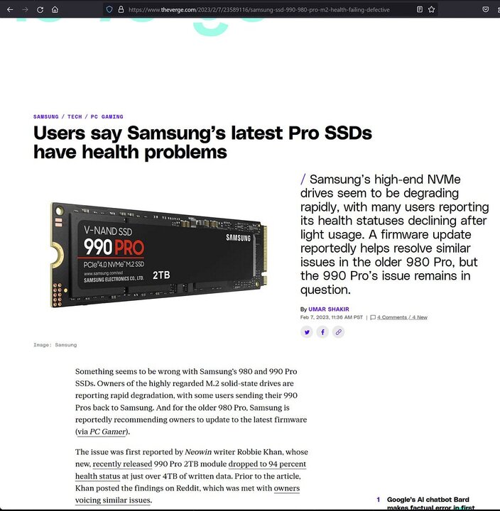

What is Happening Despite historically being some of our most reliable parts, we have received a surprising number of reports of failing Samsung drives,
I suspect a number of us out there use these drives, the 2TB Pro versions of the 980/990 drives...
What is Happening
Despite historically being some of our most reliable parts, we have received a surprising number of reports of failing Samsung drives, specifically with the 2TB version of the 980 Pro. We have been working with Samsung to investigate these failures, and they have recently confirmed that there is an issue affecting the older firmware that some 980 Pro drives were shipped with.
The most common failure mode that we have found is that the drives are suddenly locked into read-only mode, rendering the drive unusable. If the failed drive is the primary drive, then the system becomes unbootable until the drive is replaced and the OS is reinstalled.
Source.
Updated intro

The new 990 Pro are apparently affected as well (2 TB again); firmware update still a question for the 990s:

Has anyone read the comments where some working 980's with the old firmware are locking up after getting the new firmware installed? 🤣 It's like they're chasing their tail.

From what i have read so far, it seems specific to the 2 TB  980/990 Pro models.
