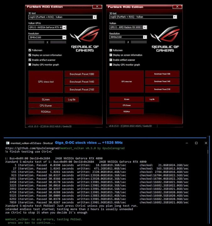

3DM's TimeSpy / Extreme, Port Royal and Speedway are very good tests for VRAM, though memtest_vulkan is a bit more sensitive in picking out VRAM OC that doesn't quite measure up, IMO. Below / bottom screen is the Giga vbios for the 4090 in memtest_vulkan, the Galax HoF vbios is similar.
Another interesting test is the ROG Furmark version (I usually set that to Vulkan instead of Open CL). The ROG Furmark also has a built-in artifact scanner !  Note of caution: ROG Furmark can REALLY test the outer limits of your card's power and temperature handling - so best to keep PL at or below 100% - at full bore, I have seen > 670 W on the GPU 🤪.  Finally, OCCT's VRAM tests is also pretty sensitive.
