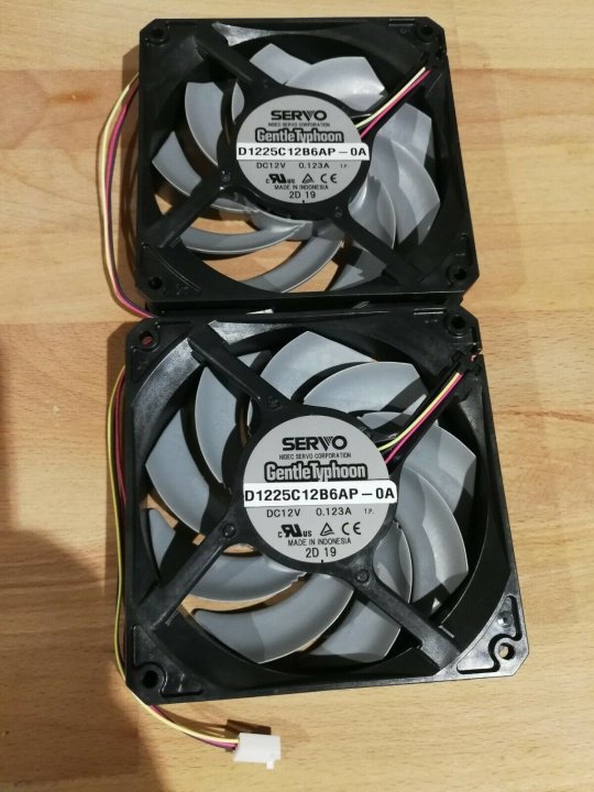

As it happens I still have some of those Gentle Typhoons hanging around never used lol. Wish they were PWM but generally speaking a decent DC control is fine if through the motherboard or external controller.
" As it happens I still have some of those Gentle Typhoons hanging around never used lol. Wish they were PWM but generally speaking a decent DC control is fine if through the motherboard or external controller."
...ohh, but there's a solution: https://www.overclockers.com/high-speed-gentle-typhoon-pwm-mod/
Oh, that is fairly wicked ! I may have to take a look and do that when I next need a decent fan and see if I can mod some of these. Thanks for that.
Oh man I got like 20 of these things in my parts closet. They might actually go with my upcoming build theme again haha.
Ha, if only they fetched an inflated price like everything else right now.
You could make some money lol.
