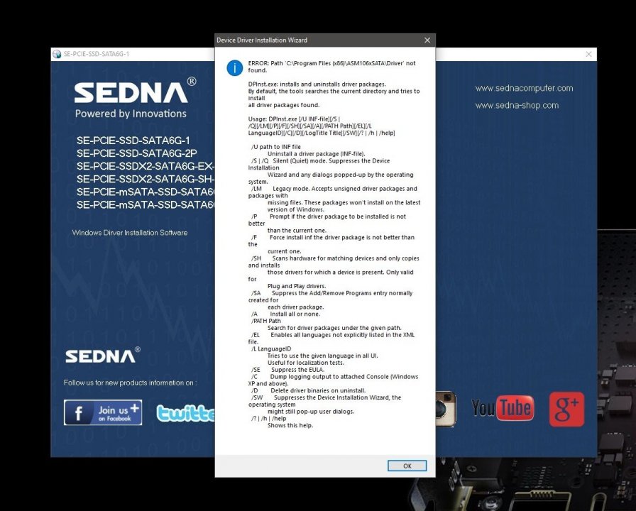

I was able to get the drivers installed and now windows see's the controller, but once I install an SSD it won't boot.
Looks like it installed the SATA controller OK. When you put the SSD back on the adapter card, when it boots does it cycle to a windows repair and keep rebooting ?
Do you have a spare SSD that you could attempt to do a test of install windows on via this adapter card as a test to see if a fresh install works ? If it does then Windows is fine with the controller card and this tells us that your current windows install still needs looking at.  If it does not then we need to look at drivers again. You may find that when installing windows fresh via the adapter card you may need drivers for it to see the drives, but I am thinking it should just see the SSD drives as normal.
