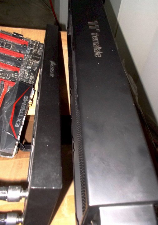

So far, I'm amazed at the build-quality of the all-copper core TT Pacific CL480s (the CL360 is the same, only shorter) but I reserve final judgement until I've actually used this new (to me) type of rad. But take a look at the shot below - on the left is the rad of a Corsair H150i AIO (360mm), on the right is the big CL480...obviously it's not just the length that counts, but also thickness. Of course having a thick rad, especially with dense fpi, also means appropriate fans.
