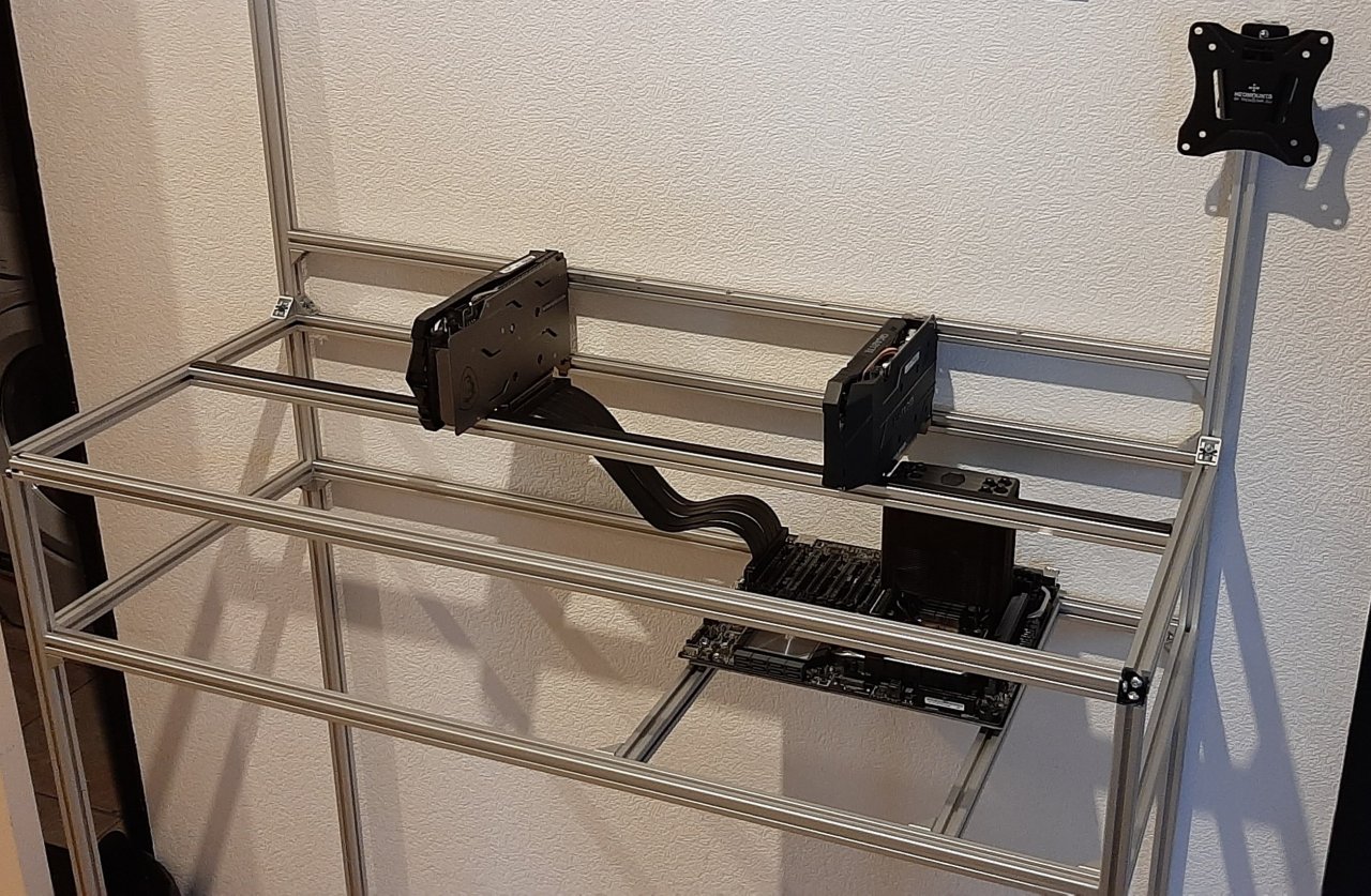

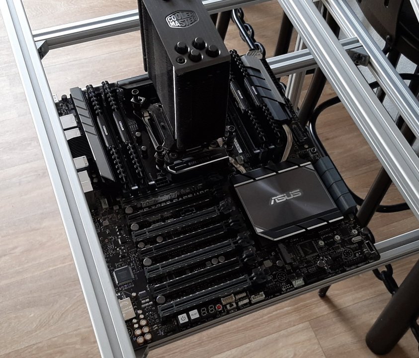

This is the hardware I received, 20x20mm aluminium profiles in two sizes: 100cm and 40cm (39.4" and 15.75") and a few bags of hardware to connect everything.
This is the basic layout, every profile can be moved besides the 4 top corners.

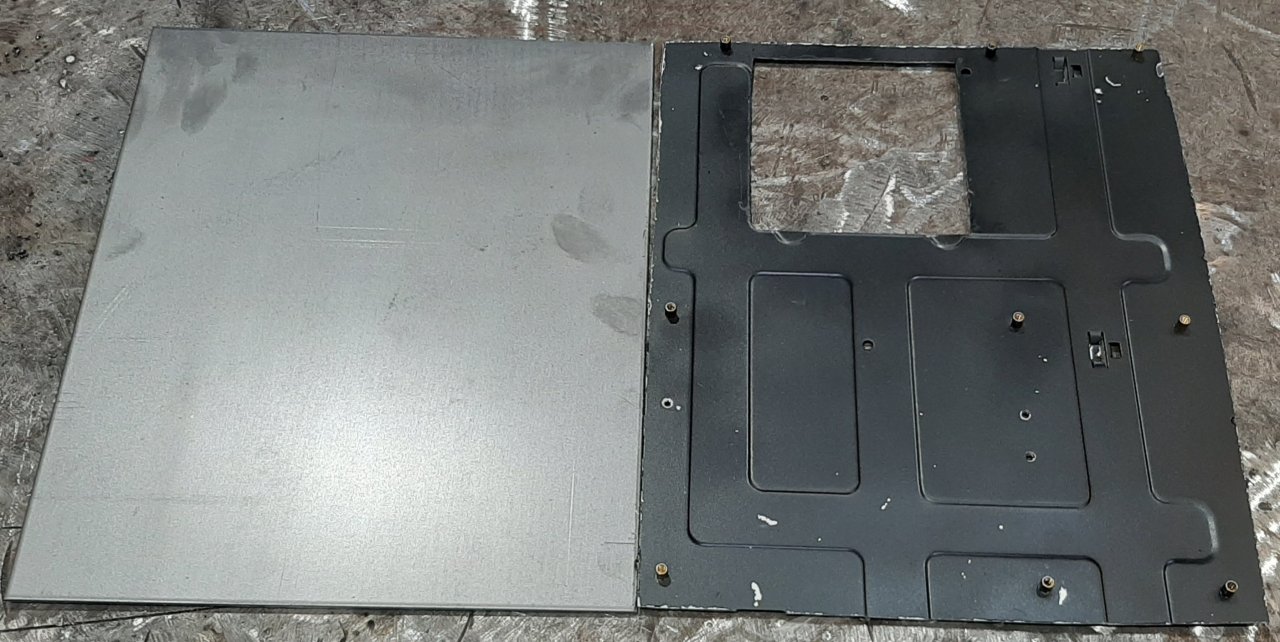

I took apart my old CM690 for templates, the first one being the motherboard tray. I used a piece of 2mm sheet metal cut to 25x30cm and drilled/tapped holes for the standoffs.

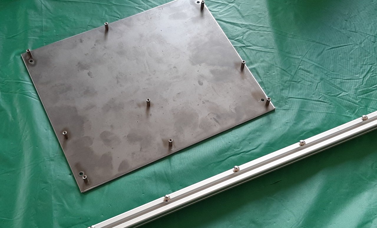

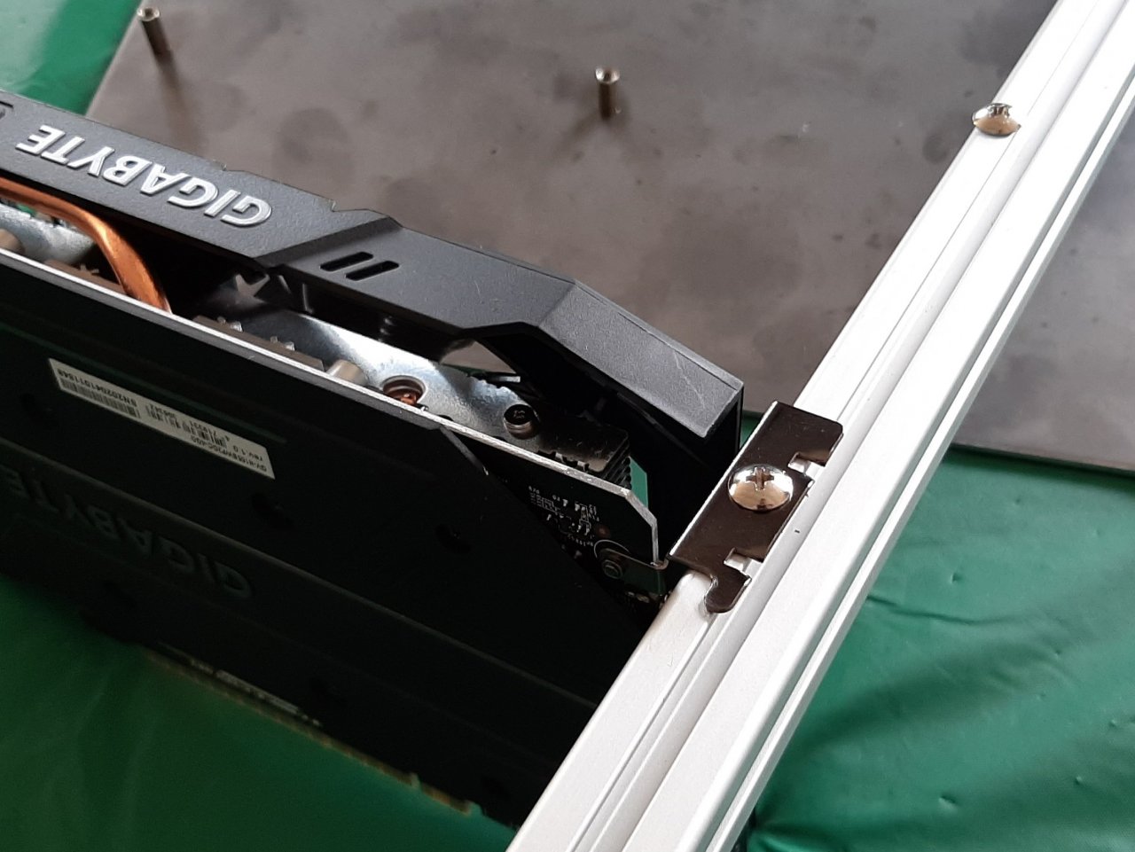

The finished motherboard tray and the graphics card mounting profile with threaded holes to secure the cards.
Passed the QC 😄
The motherboard fits perfectly on the tray, and the tray is attached to the profiles with the same locks and hex bolts as the other profiles.
Looks empty, but when I'm done there should be five graphics cards, 2 PSU's, a monitor, keyboard and mouse on this frame. The monitor mount will be on the left, and once the final state has been reached the other standing profile will be cut down to the GPU mounting profile height.
The tall frame makes it easy to work on, and I'll have some storage room under the frame.

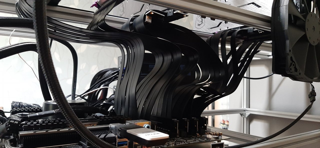

3 black Noctua NF-A20 fans showed up a few days ago. I haven't had time to look at ways to mount them, work has taken most of my time (and building 2 systems for a coworker, plus selling him one of my systems and some hardware). I'm in need of a big PSU, would love to own an EVGA 1600W T2 but that doesn't seem to be easy right now...
The system was online with 4 cards, of which 3 were using risers. 820W with 3 GPU's on an 850W PSU did work, but it did not make me feel comfortable for some reason.. At least I'm happy that it works, though I hate the dual PSU mess and inconvenience.

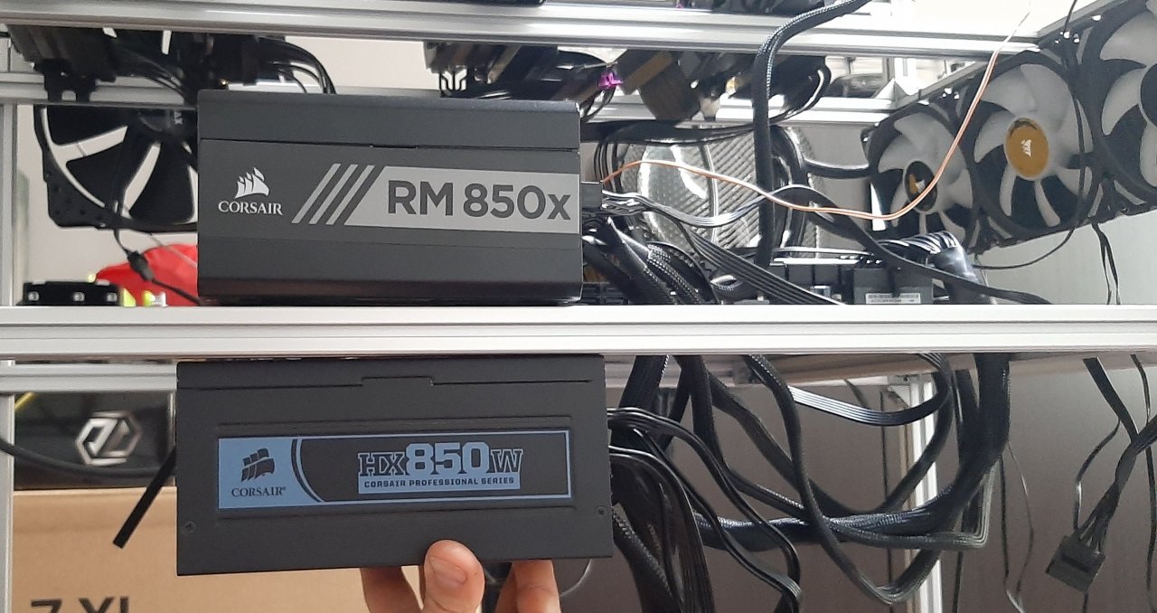

I understand the frustration. I use http://www.add2psu.com/ to eliminate the need for manually switching the 2nd PSU. It does add a 2nd 24pin and molex cable to the rig, but makes on and off much easier. The 1600w Superflower has served me well, they aren't cheap, but for the 450$ price tag it beats every other 1600w on the market.
Expand
I ordered the add2psu. There was one place selling it for €6,99, that's pretty cheap 🙂
As for the PSU's, I couldn't find the Superflower for sale but I did find out that it's basically the same as the  EVGA SuperNova.
I can only find a few Silverstone and Be Quiet units available, so I'll use the dual 850's for now.

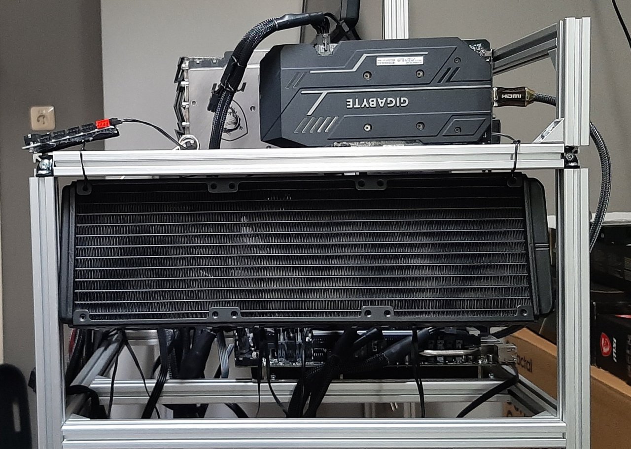

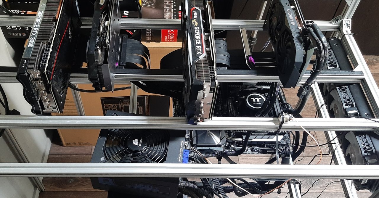

The progress on this build is a bit slow, because it has been running without any problem for some time.
As I'm using the system I get an idea of what I need to change or improve.
So first of all, I've lowered the lower level 4cm to create a bit more room. The extensions are long enough for every slot on the upper level, so why not?
I am running out of profiles and hardware, though I ordered a lot more than I needed for the initial build. So I guess I'll have to order more..
As I'm slowly progressing with this build I realized that it's pretty heavy to lift the system (doh..), so a set of caster wheels might not be a bad idea.
I've not been able to find the perfect PSU, so for now I'm still using the pair of 850w PSU's. I want to mount them in a tray below the lower level, hanging like this:
For that I'll have to make a bracket that'll fit 2 PSU's side by side, with a few holes to secure them with screws. Something like a cable tray wouldn't be a bad idea either if I want to make it look somewhat decent.
The AIO radiator will need a bracket too, it is hanging on one of the profiles right now. It's a perfect fit between the frame, almost like it was on purpose :classic_rolleyes:
One of the last purchases was 3 extra CoolerMaster PCIe extension cables. There are currently 4 GPU's in the system, and with the Tesla M40 that'll soon be 5. Once I have a decent PSU and the GPU shortage is over I would like to change at least the 1650 super for something 30xx and maybe the 1660ti too. At least I have all the extensions I need for that, and they are all the same.20210515_154408.thumb.jpg.a420e8d8124b133d8aba8b183aa7dc1b.jpg
And since I have enough extensions I upgraded the 1650 super to the penthouse which will improve the airflow over the motherboard and it'll look a bit more occupied on the upper level of the system.
That's it for now. More idea's in my head, and a lot to do to make that happen.

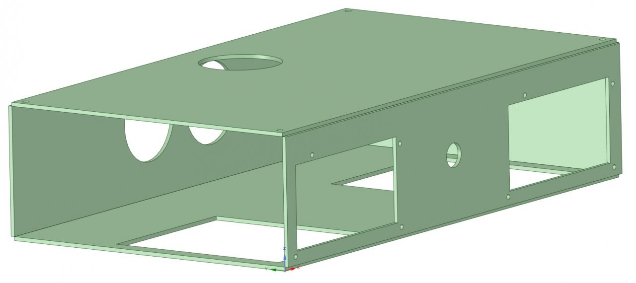

And an other little update, I decided to draw the PSU box and the radiator mounting plate. (All that to make @ENTERPRISE happy 😄 )
I'll see if I can get this made from normal aluminium instead of diamond plate. I'm not sure if I'll like the diamond pattern.. And hopefully our 'metal' shop can cut this with a laser, would save me a lot of time!
So first the radiator panel. I decided to mount the power button on the PSU box, so nobody can press it by accident.
And here is the PSU box. It'll fit 2 PSU's, a hole on top and 2 holes in the back for the cables. I've used a common size for grommets, so I can just insert those and make it look clean.
The open side will remain open, it's on the back anyways. That's the only way to install the PSU's after welding the box. I might have to extend the box a bit after looking at the size of the PSU I want (was not expecting it to be 225mm 😂)
Between the PSU's is a hole for the power button I am using, which is in the previous post. I might weld the box myself, not much experience with aluminium but maybe a fun project to try it again.

The open side will remain open, it's on the back anyways. That's the only way to install the PSU's after welding the box. I might have to extend the box a bit after looking at the size of the PSU I want (was not expecting it to be 225mm :classic_laugh:)

That is awesome man, that looks to be a half height version of the CFP case almost. Well played for using Solidworks haha, I have been satisfied...wait that sounds weird.
  On 16/05/2021 at 18:40, J7SC_Orion said:
...^ noice - soon, you're out-competing builds like the one below   (though definitely choose different GPU blocks ? , and add more serial D5s)
Expand
I feel sorry for that pump, that's a lot of restriction to overcome!
But that PSU on the other hand, I know a way better system it should go in... 😛
Expand
Haha, don't worry. We all have things that make us "happy" 😂
I was using DesignSpark, not sure if that uses the same engine as Solidworks but it gets the job done. After using it for several hours I still don't feel comfortable using it, might have to do with my lack of experience with 3d drawing.
It looks way bigger on the drawing than it actually is, the dimensions are 10x30x43.5cm (I updated the design to fit the longer PSU after posting the images).
