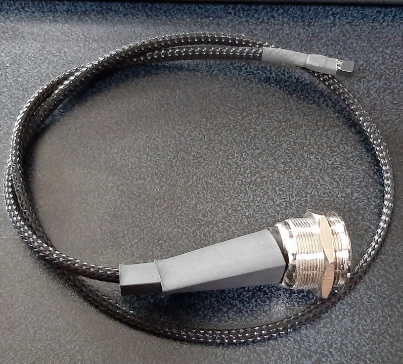

And after putting a sleeve on a few cables I'm a bit sad that most of the cables are already black, I somehow enjoy doing that stuff..
This one needed a sleeve anyways, the heatshrink will have to wait until I install it in the PSU box.

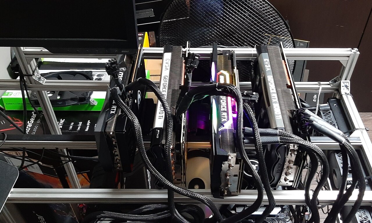

The GPU's, from left to right: 3060, 3070Ti, 2080Super, 3080Ti. Soon the air cooled 3090 will join them:

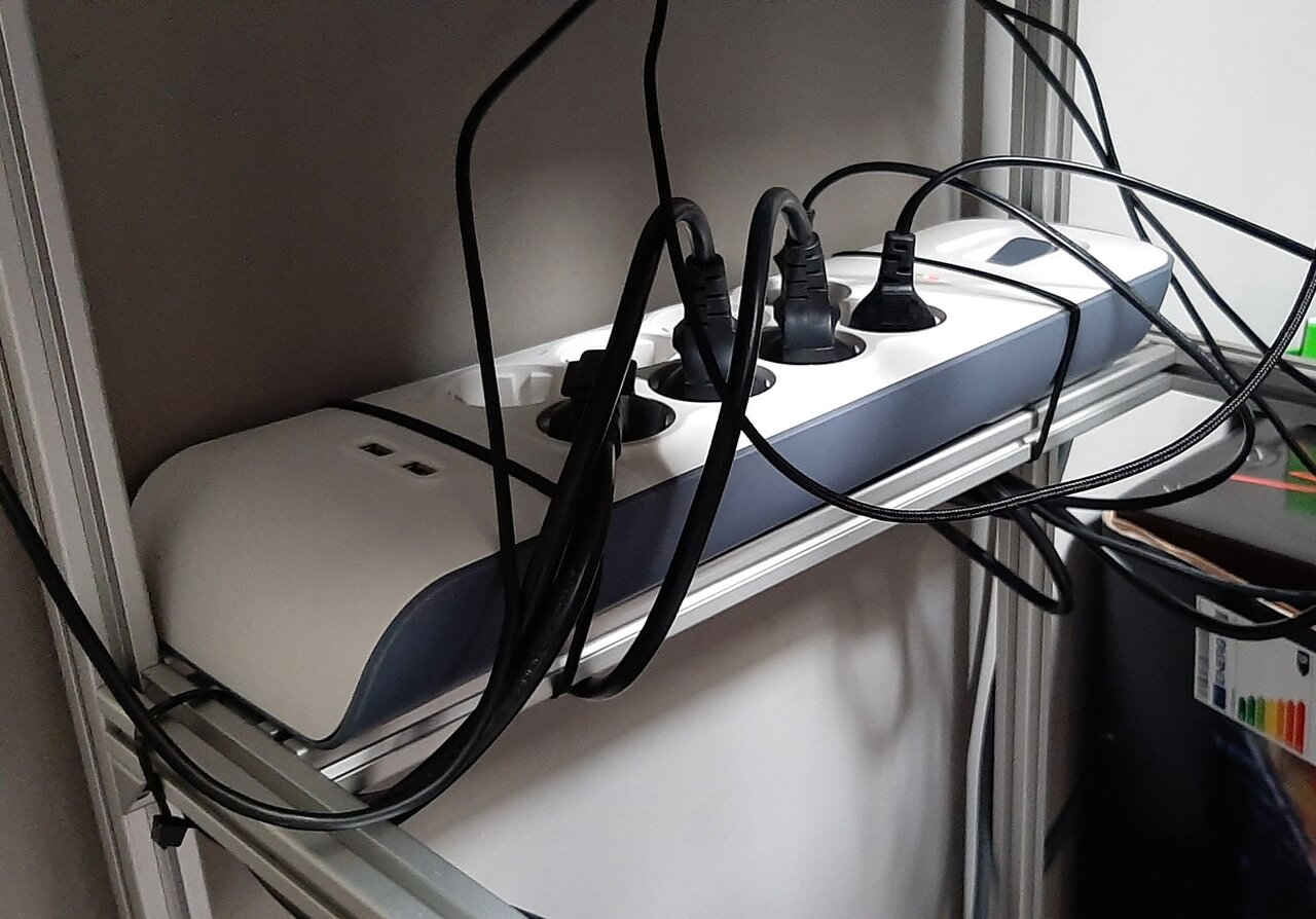

A new power strip, the cable from the old one was a bit warm with 5 GPU's pulling close to 2kWh.. (I thought I cleaned up the cables, but it still looks like a "rat's nest" 😂)

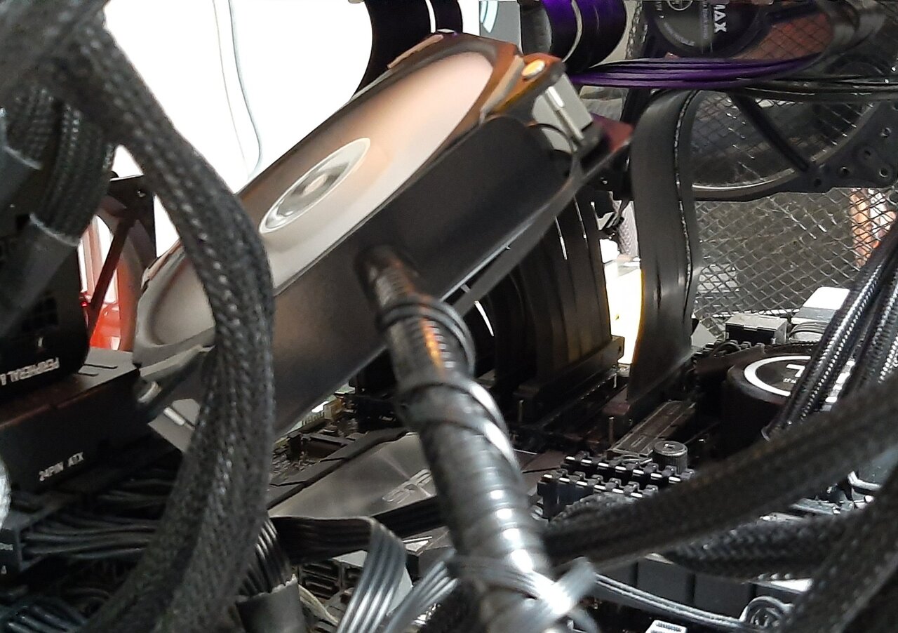

An extra fan with a DimasTech FlexFan 140 mount to blow some air on the motherboard:

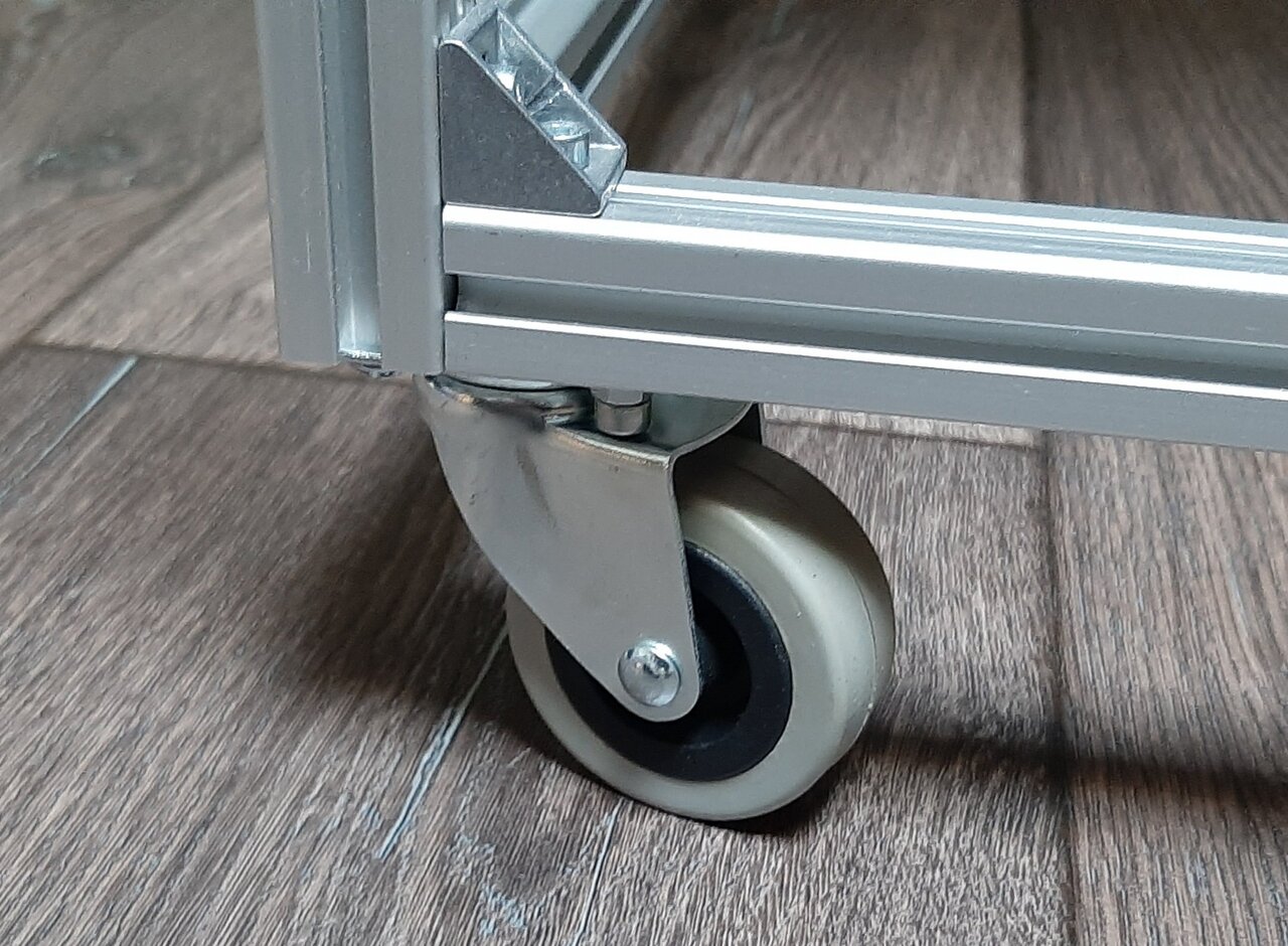

New caster wheels, the old ones are plastic and smaller diameter which makes it hard to roll the system:

Looking good, was waiting for an update on this one. I imagine the casters make life easier.
Thanks, progress is a bit slow though (same as all my builds actually 😂).
The casters are really easy, I like to move the system out of the way if I'm cleaning the room and it makes it easy to work on the system too.

...re. casters, 100% agreement ! ...I've learned it is best to have my custom builds (some close to 100 pounds w/ temperate glass) and all related peripherals on wheels. Apart from the weight, none of these are regular 'boxes' and tricky to pick up re. their irregular shape and sensitive components on the back.
yeah, it's so easy to move it around! Even outside the room, I can just move the system to the living room if I want and it only has one power plug to get it all up and running.

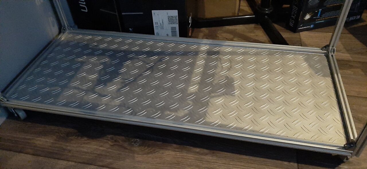

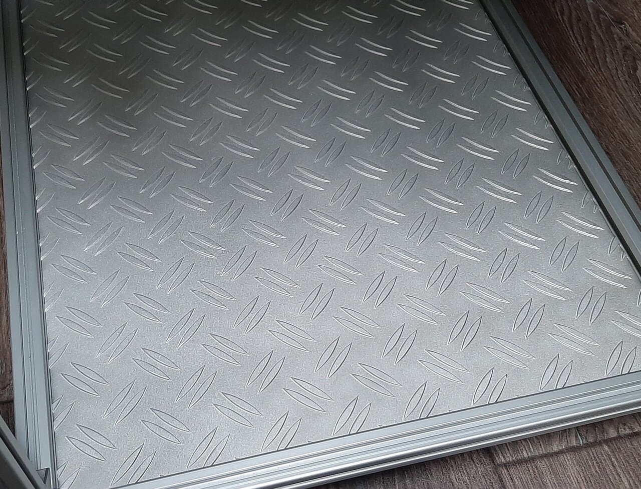

And a small update, a coworker was working on some floors for an engine room so he cut a 100x40cm diamond plate for me. It saved me some trouble and I offered to help him with his slow laptop in return.
I sandblasted a little test piece which looked pretty good, so I did the whole plate.
It looks pretty good imo, just needs some support in the middle before I put weight on it.
[edit]
Daylight picture, still bad quality. (I need a better camera..)

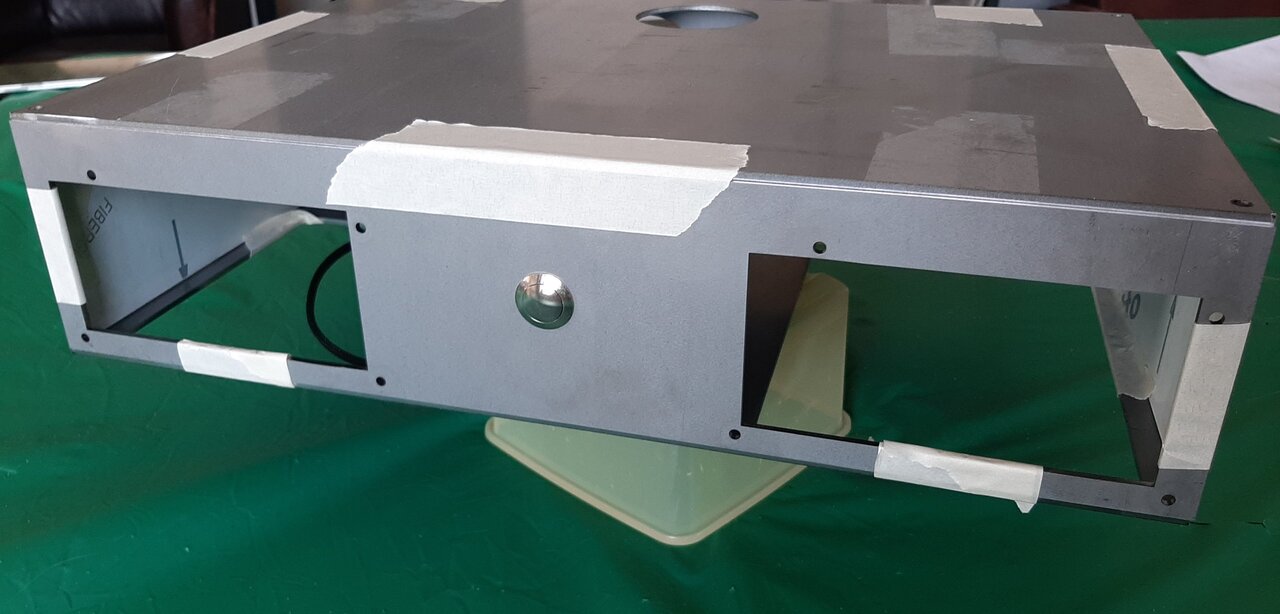

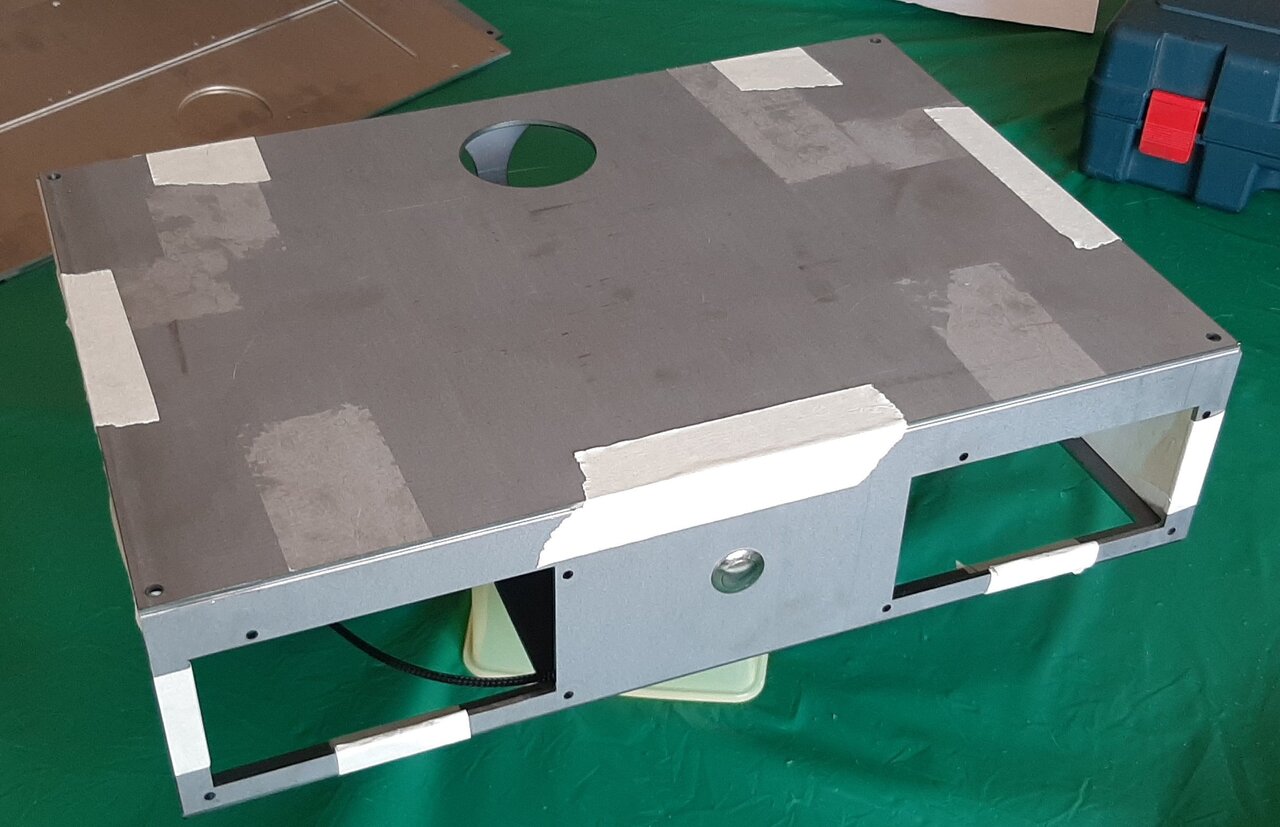

After waiting for a long time because 'reasons' this box is finally here.
So I taped together all the parts to get an idea of how it'll look before welding it together.
I have all the panels in steel and aluminium, though I don't have the tools to weld the aluminium myself so I think I'll go with steel.
Steel will be better to drill and tap holes in the top panel for mounting the waterpumps for the dual loops, and a bit more weight won't be an issue with the upgraded caster wheels.
Four mounting holes for some bolts to go into the frame rails, will be a bit hard to mount but I don't think I need to move it that often.
Three holes for cables, I'll order some grommets from a local hardware store (holes are cut to fit one of their grommets):
A power button between the two PSU's, of which one will be for the water loops and the second PSU will be for the system:
The PSU fans can breathe through the holes on the bottom:

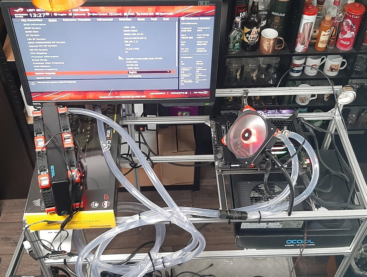

And this is what the system looks like for now, not much folding going on but a lot of benchmarking instead:
There is a lot to do, some of you might have seen the watercooling hardware I bought recently. That'll go into this system too, but I'm not done figuring out where to put it.. 😄
