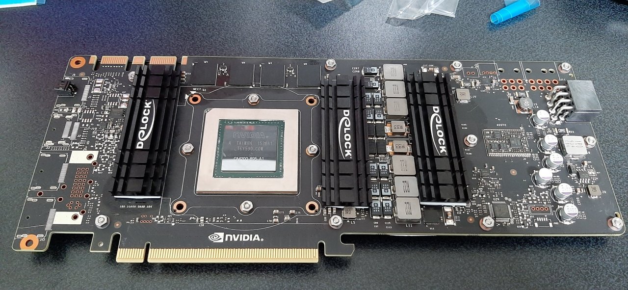

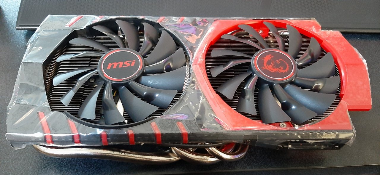

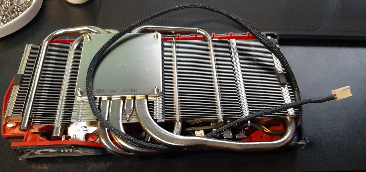

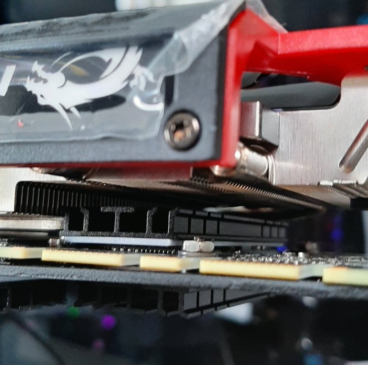

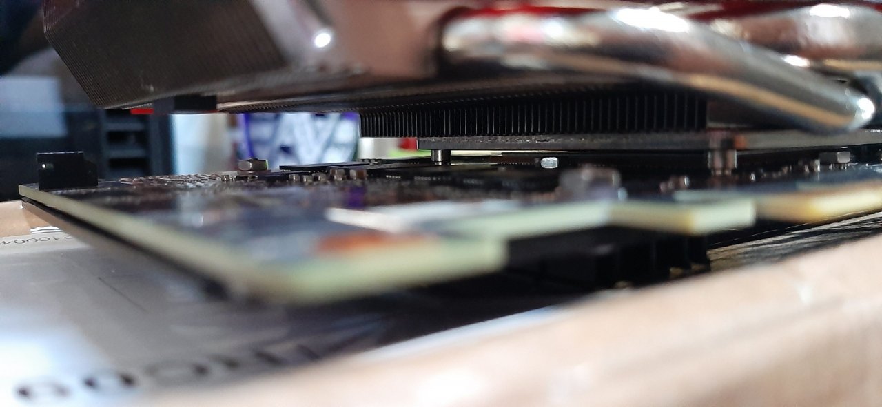

In the downtime of the forum I did some things with this card:
The cooler, unused with the thermal paste still on it:
I replaced the connector for a 3pin, soldered longer wires, used heatshrink to protect the wires and sleeved the thing:
There was enough room between the memory and the cooler, so I ordered 3 extra M.2 heatsinks:
The only memory I can't cool directly is the row above the GPU. There is a heatsink on the back though, should be good..
And the final product, MSI M40ti sounds good 😄
