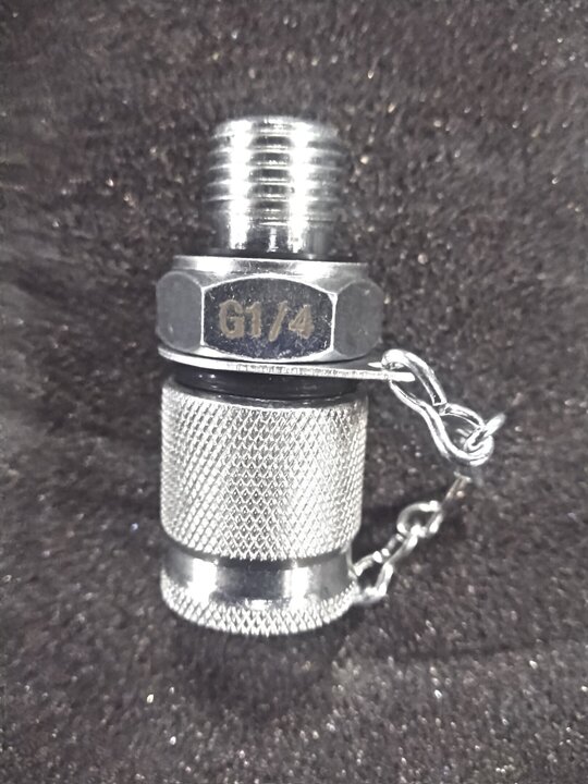

This is the exact fitting I require:  4-4BSP | Lenz (lenzinc.com).  Sadly, Lenz appears to be the only manufacturer of these that I can find, and they don't do retail sales, only wholesale to a distributor.  So, Motion Industries, the closest distributor to me, plans to send me a couple in two weeks.  I guess not even Lenz itself keeps them on the shelf.  C'est la vie 🙂.

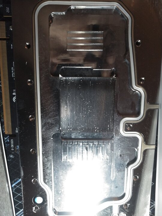

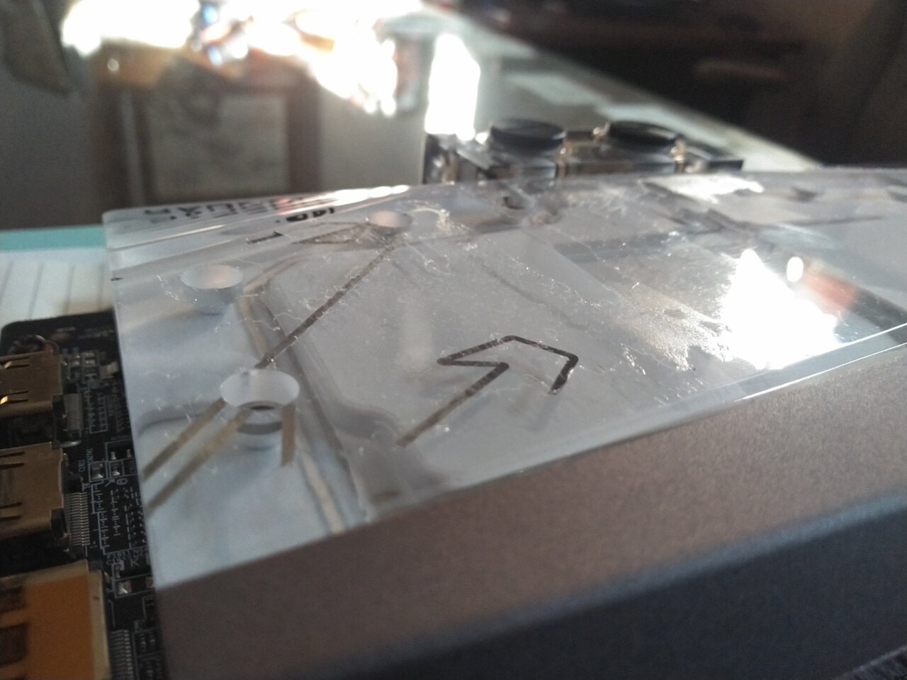

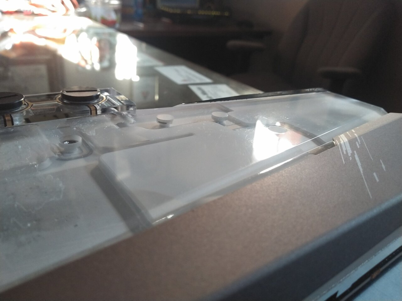

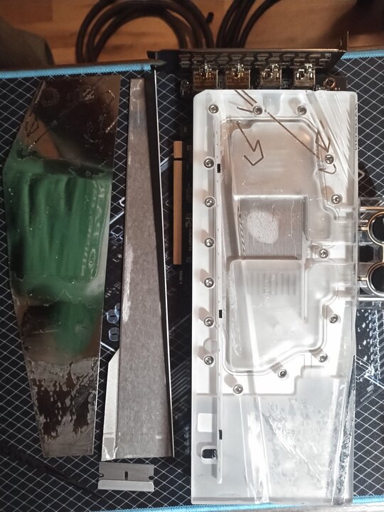

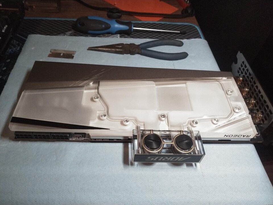

Curiosity got the better of me last night, and despite my initial misgiving I decided to investigate the state of the GPU more thoroughly.  I was somewhat pleased to discover that in a dark enough room with a directable light source one can get a decent view underneath the reflective foil backed translucent plastic cover (provides that oh so cool mirror shades effect that convinced me to buy the card in the first place.../end sarcasm) that Gigabyte decided they should glue to the acrylic top.
Those ZMT slivers are pretty small though, and I wanted a better view. So, razor blade + plastic dish scraper + patience = items preventing access to the acrylic top retention screws removed without any significant permanent damage (heat gun would have probably helped as well).
Now let's clean all of EKWB's gunk out of my poor baby.
Except there wasn't any gunk inside the GPU...Either my bi-directional flushing had already removed the material, or, more likely I think, the "micro" channels in the block are so much larger and coarser than those present in the upstream CPU block that anything managing to pass through the CPU block wasn't going to get trapped here.

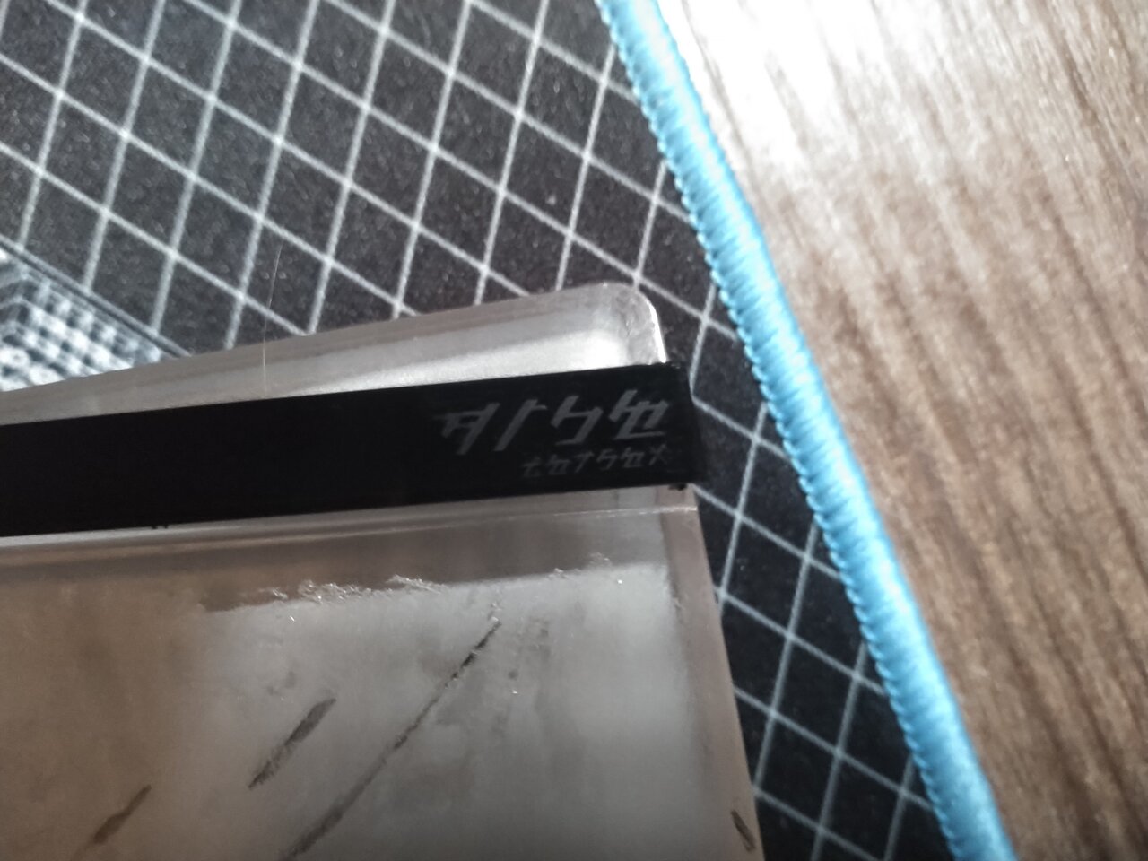

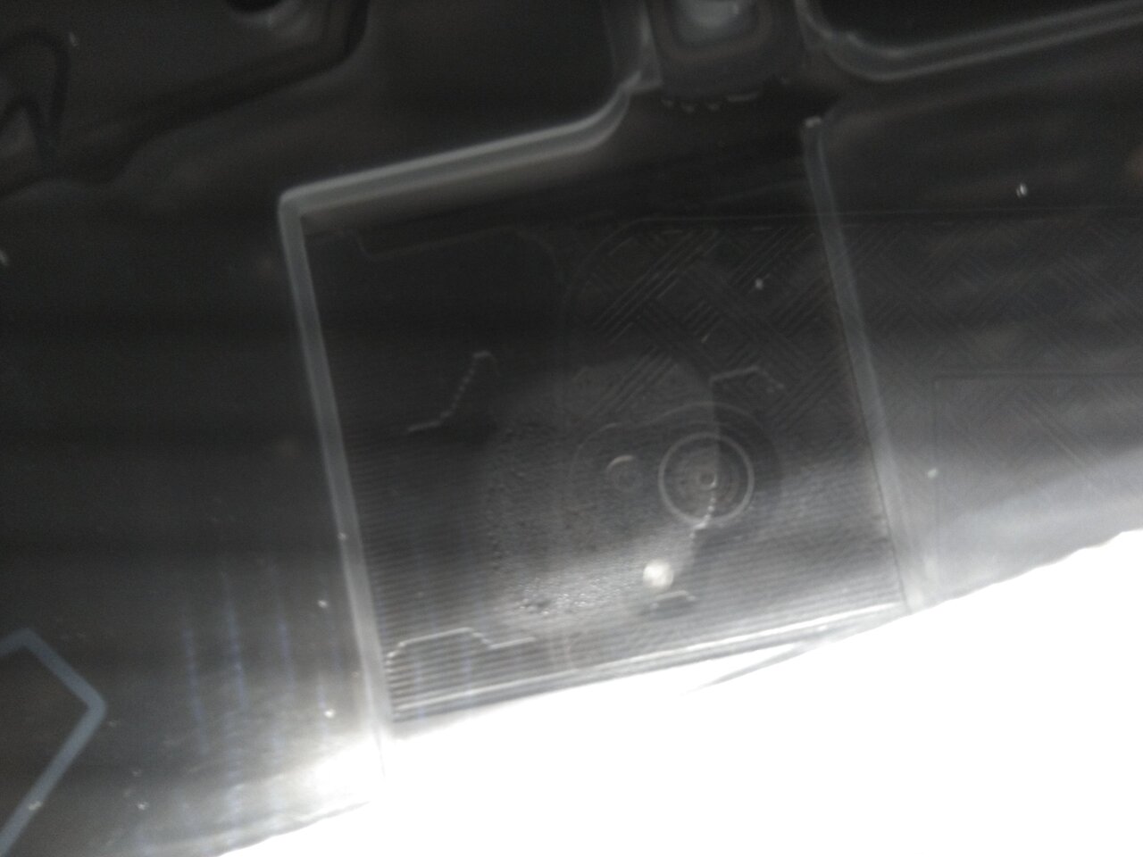

Anyone know what this says?  I haven't the faintest idea.

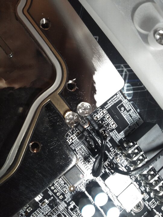

Prior to purchase, I had read a few comments to the effect that the leak detection system could be overly finicky.  If I ever need to disable it doing so would be relatively simple.
With a ridiculous amount of patience, cotton swaps, Scott towels, and Goo Gone, I have managed to clean about half of the adhesive off the acrylic top 🥳.  I will do battle with the remaining half tonight, as I have decided I'll keep the "mirror" plastic without reinstalling it at this time.

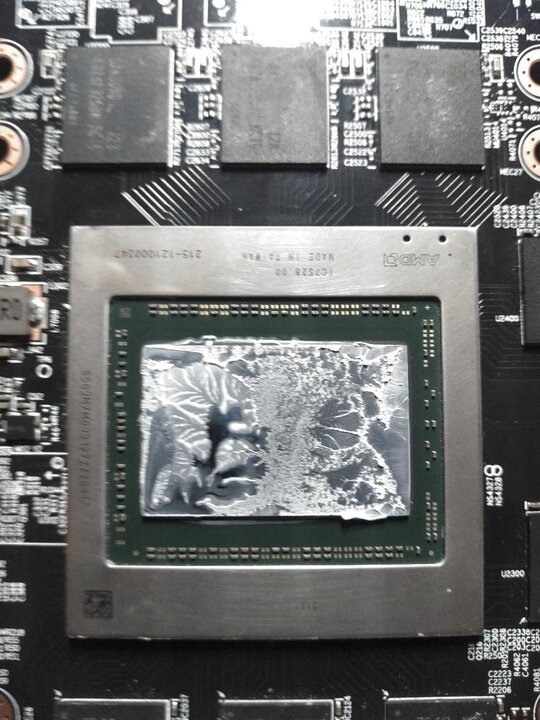

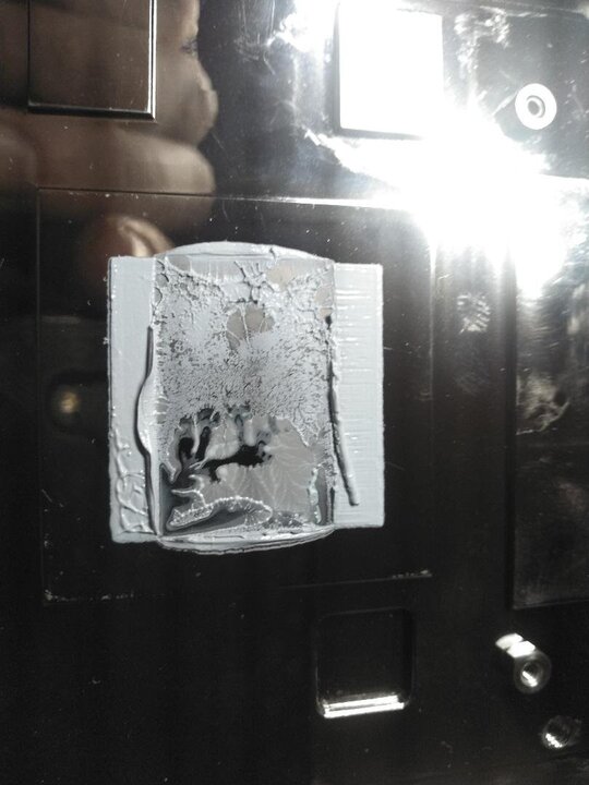

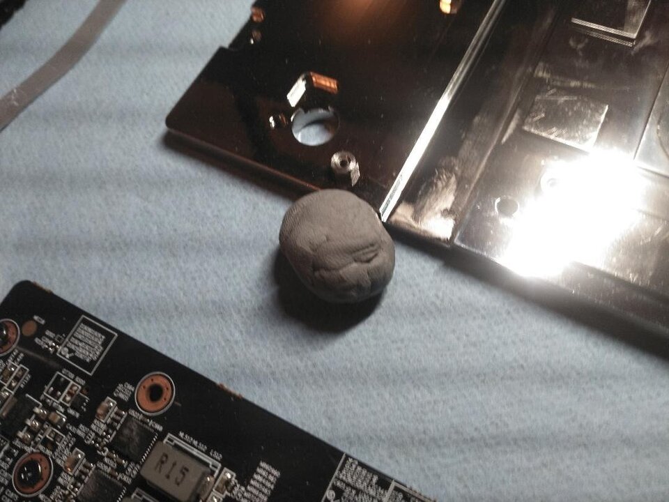

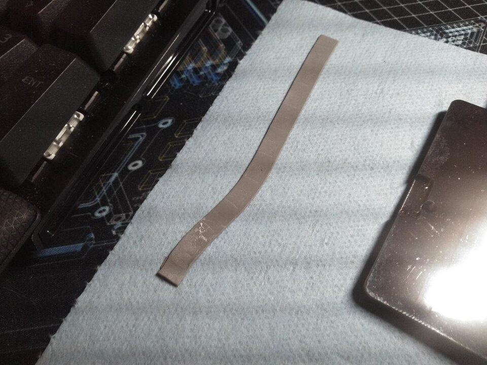

I did go ahead and tear her all the way down.  The paste on the GPU looked like it had some voids.  It also appeared like it had possibly been silk screened onto the waterblock during assembly.
The VRMs had a thicker grey putty on the waterblock side and nothing on the backplate side.
These little strips that look like pads are about as resistant to deformation as "play-doh" that's been left out a couple hours too long, but they will still ball up.
The backside of the GPU die had a 3mm thick square pad between itself and the backplate.  I went ahead and replaced the stock paste with MX-5, the grey putty and 3mm pad with TG-PP10, and, since TG-PP10 has a limited shelf life (or claims to, not sure how it can go bad if properly stored, but whatever), I used the remainder on the backplate side of the VRMs.  It may be of little benefit, but better there than expiring in the little bottle it came in.
For my first open GPU surgery, I am pretty pleased (assuming I have a video signal when I finish reassembling the rest of the system) 😎.
The TG-PP10 does have a shelf life, but that seems to relate to application rather than endurance; the oils added to the putty to make it easier to apply eventually 'vacate', but it apparently does not affect longer-term thermal performance once applied. Since I had read the same thing, my 6900XT has one area where a bit of thermal putty is accessible externally to check. I also added a line of MX5 onto each thermal putty and thermal pad application.
The thermal putty jar itself does have an inner airtight lid but of the four jars I bought (for four systems as each Raven is actually two systems), I have two and a bit left over...whatever was left over from an opened jar was placed into a freezer bag w/ the air bled out, then back into its jar with both lids on. It joined the rest of the thermal gang (spoiler) for future reference and also maintenance.
My Gigabyte OC also had the 3mm soft pad on the back of the GPU die - which I had never seen before. As I used a custom backplate after mounting the w-block, I filled that void with thermal putty and MX5 on top, mating it to the backplate and the additional heatsink on the back. I also added putty w/MX5 on the back of the VRAM areas and where the 3x8 pin connectors are on the back (and of course the corresponding front). Thermal performance is more than I could have hoped for, though I felt a bit queasy pushing putty (gently) onto the back of the die with all its tiny fragile components...it was necessary though to establish a full thermal bridge to the backplate, the extra heatsink, related fans etc.
Final point: Like yours, the front of the 6900XT die also seemed to have voids in the factory thermal paste application, with the 'added feature' of a thumbprint on the die (not mine) 🤪

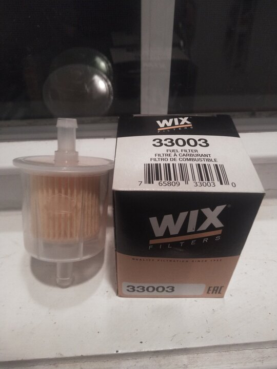

I've made quite a few changes to the loop (will detail them in subsequent posts).  One of these changes is the inclusion of a filter.  Rather than one of the items offered by manufacturers of PC water-cooling gear, I choose to use the unit pictured below.
I choose this particular filter for several reasons.  It has 3/8" (10mm) barbs.  It has zero metals used in its construction.  It's cheap and readily available.  It will filter out much smaller contaminants than a "mesh screen" type unit.  I can see inside it.  It is very large (greater surface area = minimal restriction at the relevant flow rates in the loop).
I have installed the filter just upstream of my CPU block (but hidden it behind my reservoir, as it is rather unsightly).
Scan it with the google translate app! I tried to scan the picture but it couldn't read the text, but I bet it'll do it when you scan it yourself 🙂
