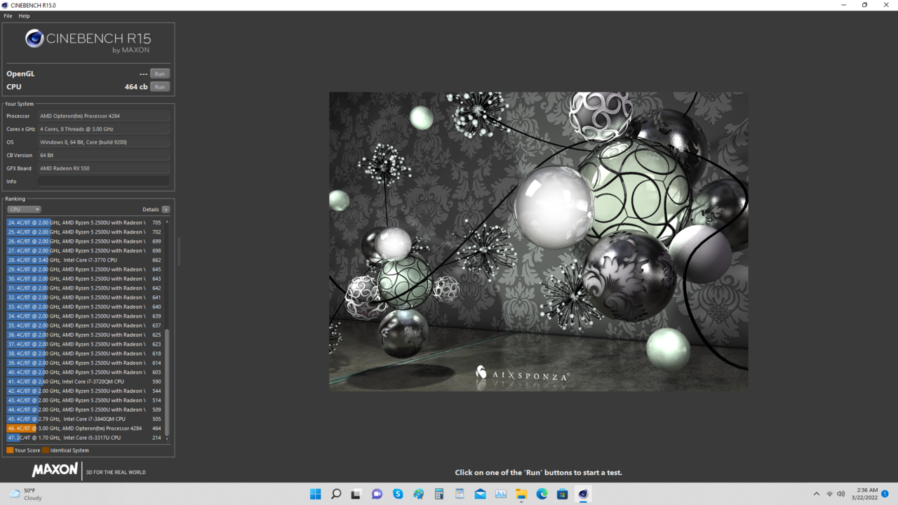

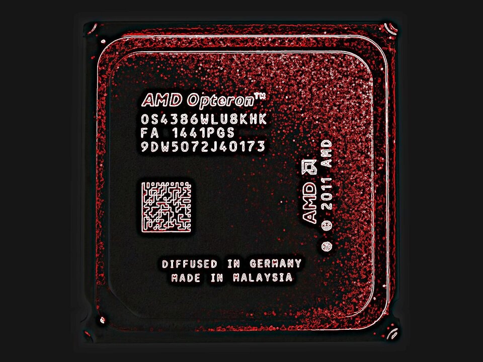

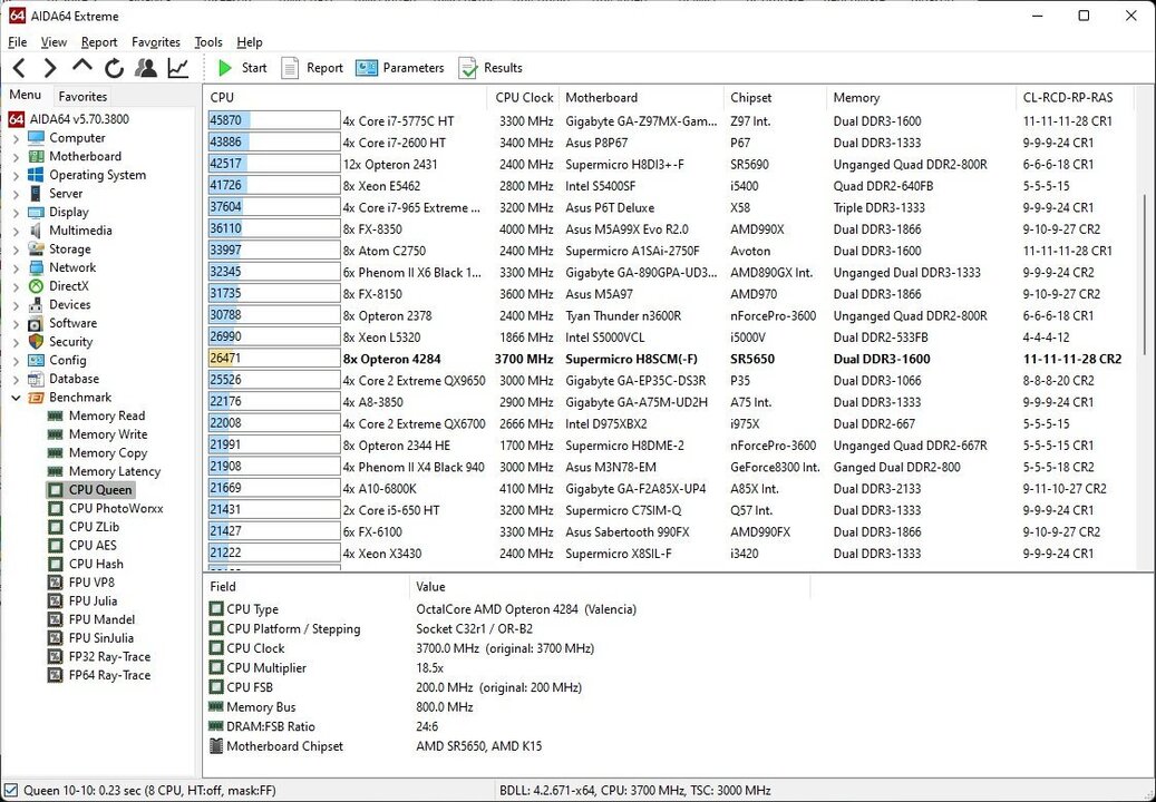

Here is some benchmark data of my new AMD Opteron 4386 8-core up to 3.8Ghz, which beats out my AMD Ryzen 5 2500U which is great.  The Dell OEM Low Profile AMD Radeon RX 550 4GB under-volted down to 950mV & 1250mhz core 1875mhz memory with 75w tdp & reduced hot spot down to 84°C from 105°C.  Only 5 fps less than 1375mhz core with 105°C.  It also runs 20°C cooler at 950mV from 1050mV but set to 1075mV via stock vga bios.

I have a modded Acer laptop with a 2500u in it funny enough.  Once setup and overclocked, that darn thing does things I never expected to see a budget laptop do! :lachen:  Your rig should be handily beating my laptop, looks like it probably is.  So yay!  The GPU in the 2500u is just BARELY underneath an RX 550 in performance, and your CPU is definitely stronger even with the 2500u at 3.6GHz speeds.

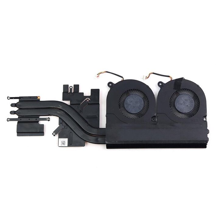

Can you post pictures of your modded heatsink on your Acer Aspire with the Acer Nitro heatsink?  That's really cool.
15 minutes ago, HeyItsChris said:
Interesting.  Yeah my eGlobal AMD Ryzen 5 3550H Mini PC has Vega 8 GFX as well & its way faster than my HP ENVY X360 AMD Ryzen 5 2500U.  My eGlobal AMD Ryzen 5 3550H Mini PC has an unlocked BIOS so you can tweak the memory speed & timings.  I run DDR4-2933 on the AMD Ryzen 5 3550H with 3200mhz module's.  Not to mention they replaced the motherboard & put in a T-Bao motherboard with unlocked TDP settings in the BIOS so I set it to 54W & added a copper shim to the Core Diode to cool it down at 54W TDP.  It performs amazing now.  It holds 1200Mhz core on the GPU Vega 8 & 3.7Ghz on the AMD Ryzen 5 3550H.  Which smokes the AMD Opteron 4386 on Cinebench R15.  It scores almost 800 points on Cinebench R15, while the 4386 scores 511 points.  I'm happy with the performance of the 4386 though it's amazing & cool running too only 48°C max temp.
I don't have any unfortunately.  Did this a few years back, 2019 I think?  But its this cooler here off the Nitro 5:
9f4a5c62-4515-4822-99f5-75d3674259b9.29fab2591d8c835ba4556c8cc9a37f11.thumb.jpeg.59b77ed37f735739662788178f686632.jpeg
The factory heatsink on my Aspire 3 was aluminum and only had 1 fan on it.  I don't have it on me anymore, and the laptop is put up on my shelf of junk until I get around to replacing the battery again lol.  The Nitro was solid copper with 2 fans on it, rated for a higher TDP / wattage.  It fit, so I put it in there lol.  My particular model Aspire 3 came with the 2500u in it, and its identical to the Nitro that had the 2500u / 2700u + GTX 1660 or whatever GPU it was in there.  Wired in the second fan to a USB header 5v and put it on a toggle switch so I could turn it on or off (full speed only for the second fan).  Used liquid metal for TIM (VERY carefully surrounding the area with tape).  I was hitting about 61*C full CPU load, and in the low 70's p95 + furmark load with the CPU locked at 3.6GHz and the Vega 8 locked at 1.2GHz.

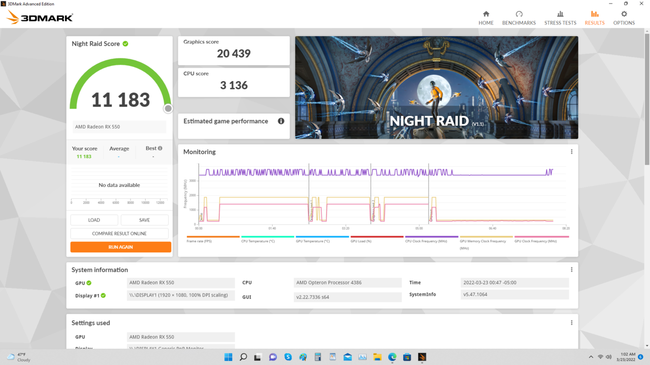

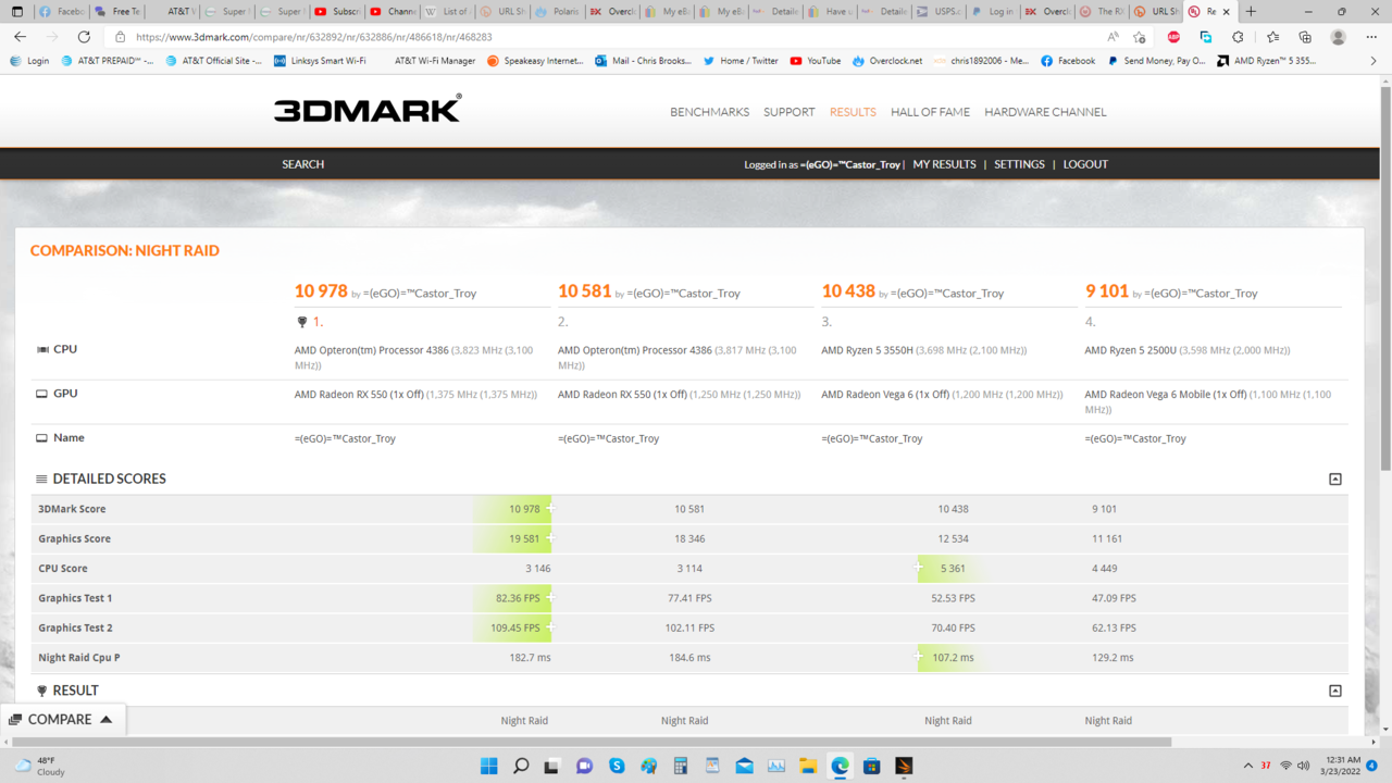

Here are my results comparing the RX 550 at 1250mhz core & 1375mhz (not much so ill leave it under volted and at 1250mhz for safety purposes).  Against my 3550h mini pc & my 2500u laptop.  Looks like the Ryzen chips surpass the Opteron 4386 on the CPU test.
WWW.3DMARK.COM
This one I overclocked the RX 550 to 1400mhz core & this is the result.
WWW.3DMARK.COM

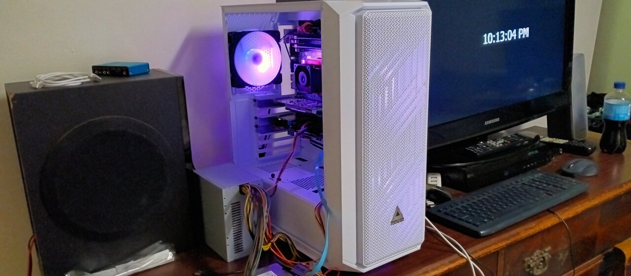

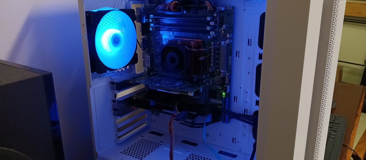

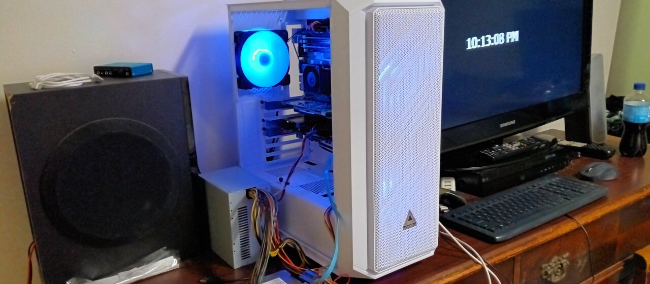

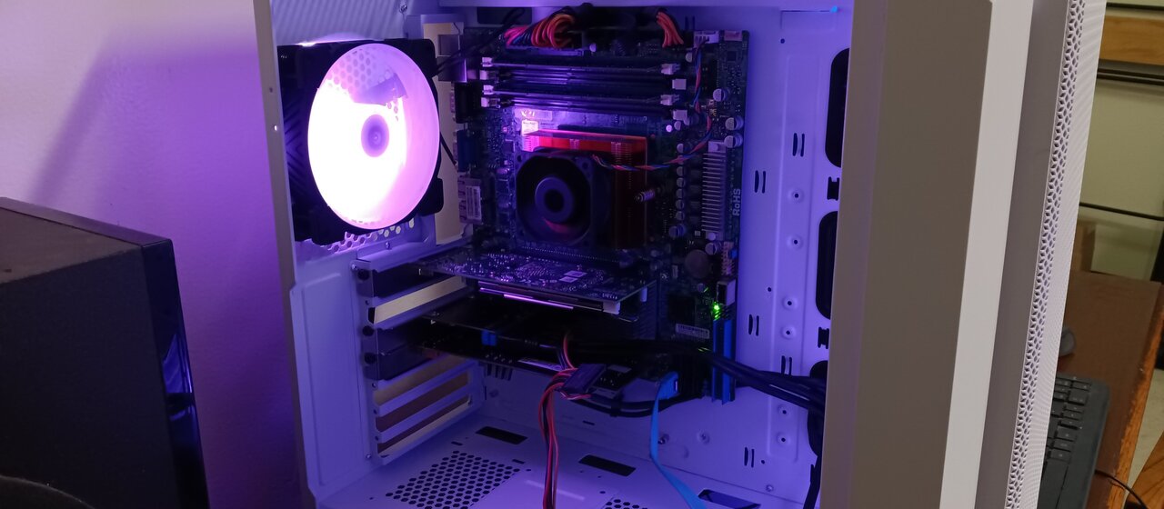

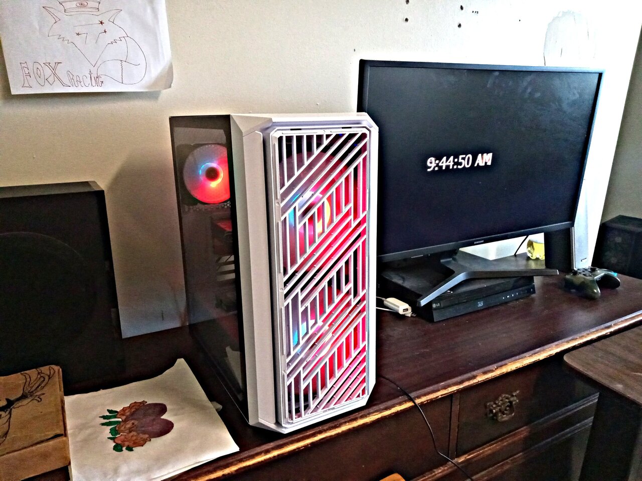

I took some more pics including the damaging of the case to fit the larger than typical ATX power supply, the Dell Precision T7500 1,100W PSU.  It's an amazing power supply for the money providing very solid 12v rail capabilities & 16 AWG thick wires ensure stability, continuously under load.  I know it's an eye soar but later on I'll take it to a shop & have them cut out the metal & weld a brace to reinforce the chassis.  So far I'm waiting on my 12" Molex Extension for my PCIe x1 USB 3.0 adapter with front panel 3.0 header & my 12" 24-pin power supply EPS power extension for the short 24-pin on the Dell Precision T7500 or it's only because the motherboards power connectors are at the very top & the PSU is at the very bottom of a standard ATX case so it just can't quite reach.
Great looking build!
What kind of heatsink is that seem like a chunk of copper?
CPU: 13900k
MOTHERBOARD: ASUS Z790-AYW V2
PSU: Cybercore Platinum 1300w
GPU: Sapphire 9070xt nitro +
CASE: Corsair 7000D Airflow
@bonami2Thanks man.  I'm glad you didn't think that bending the metal to fit the large 1100w psu wasn't too much of an eye soar.  It sure is a PITA getting the side panel on though 😂.  By the way, that heatsink came with the motherboard but I'm thinking it's a Dynatron full copper 2U? heatsink for C32 socket.  I also love this socket & build as well.  I always look forward to getting on it even without it being overclocked, it's 99% faster by stock than my other AMD A6-3670K overclocked to 3.5Ghz Quad-Core.

It's a 1U Dynatron T319 Copper Heatsink for C32 Socket.
EBAY.TO
Solution 1U Server. CPU Support AMD® Opteron™ 4100 & 4200 Series Socket C32, Six-Core and Quad-Core AMD Opteron™ Processor Socket F 1207 up to 105 Watts. CPU Socket C32 & F 1207. Material Copper...

I bent a micro atx once to fit a 1000w psu hahaha.

@bonami2 Right on man.  Glad to hear I didn't make a poor choice.  I had to do it or else this machine wouldn't work properly.  It's very stable now it reports 12.094v at idle & max load of 221 watts on the core alone not including the rest of the PCB is 11.813v which is just fine & dandy for a $39.99 power supply shipped.  Stock clocks it doesn't budge 12.000v load which is amazing.  It's because I have the TDP TDC limits at 999 watts so its unleashed & delimited power limit for maximum performance.
*Update on the PSU Voltages*
After turning up the voltage on the RX 480 to 1.275v, it reached more than 315 watts on the Core alone!  The Core temperature was 79°C & the VRM was 76°C & the minimum 12 volt rail voltage was 11.750v.  Still quite capable power supply.
I recently pulled the motherboard to repaste the super-hot running Chipset which before I pulled the dust mesh filter off the front of the case front panel, would hit 80°C.  After pulling the dust mesh filter off the front panel it went down to 67°C, but I since have repasted the Chipset & it's running at 63°C now which is fine with me.
I also made a new video of the Supermicro H8SCM-F in action with the AMD Opteron 4386 8-Core CPU which clocks up to 3.8Ghz which conditions are right, but most of the time is 3.4Ghz.  I also have the MSI Reference Blower AMD Radeon RX 480 4GB Hynix running at 1.2v vCore which is set in the VGA BIOS, from 1.175v max vCore stock.  There is a -25mv offset by stock on my card so bare that in mind when viewing the GPU Core Voltage.  I have the core set to 1375Mhz & left the memory stock at 1750Mhz to minimize memory errors.
I still have yet to receive my 24-pin EPS power supply extension cable which is 1 foot long & 1 foot long molex extension.  So I cannot upload pics of the machine yet until it's fairly complete.  Still need to upgrade the RAM to 128GB DDR3-1866 ECC Registered Buffered & possibly a GPU upgrade would be nice.  Maybe a RX Vega 64 or RX 5700 XT or some such RDNA or RDNA 2 GPU.

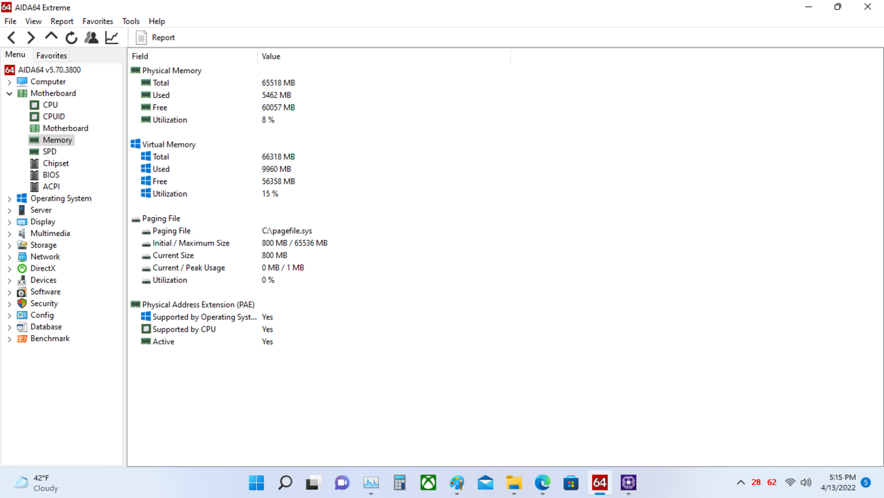

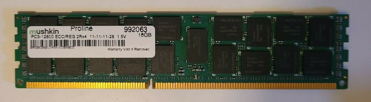

Tomorrow I'm ordering 4x 16GB sticks of ECC Registered Buffered Mushkin ProLine RAM for 64 Gigabytes of total RAM for $10 a stick, total $40 shipped for 64GB, Can't beat it!
Not to mention my Guardian is holding my mail now because I'm not compliant with my newly found diabetes apparently, even know I'm never going to succumb to treatment for it ever.  I'll die before I get treated for diabetes.  So I couldn't receive my 1 foot long 24 pin power supply extension cable.  So I have to re-order it all under someone elses name.  I live in a lock down facility because I yelled at my parents about Jesus Christ, our Lord.

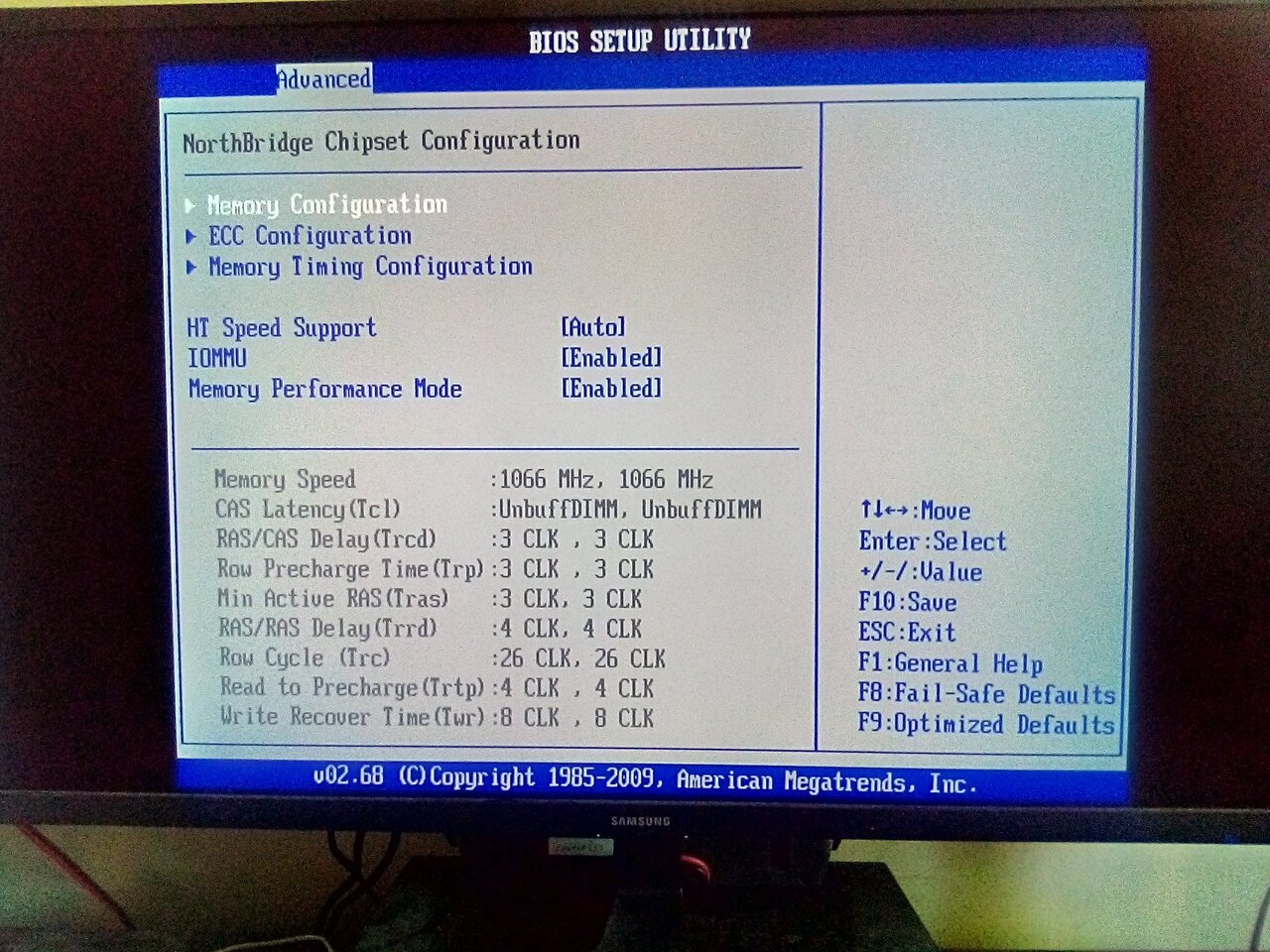

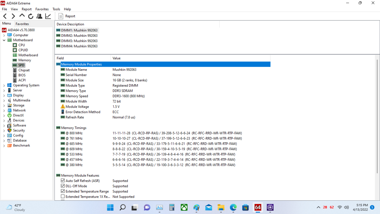

So I got my Mushkin Proline RAM in & it BSODs if I have all 4 module's installed & boot loops continuous but will boot but reports the 1600mhz module's as 1066mhz unbuffered DIMMs.  With 2x module's installed for 32GB it reports 1600mhz & works fine.  I contacted Supermicro & they said the memory wasn't on the QVL list for memory.  I should have bought Samsung Module's because of their higher compatibility.
*Update*
For some dumb reason the Supermicro BIOS is at fault here with this Mushkin RAM.  It uses the wrong timings at 1066mhz, way too tight is why it BSODs & barely gets to Windows most of the time.  So I dialed the RAM back to DDR3-800 & Its using the right timings now its working fine with 64GB installed, but the RAM is slow as heck bro's!  Can you help me mod the BIOS so it uses the right timings with the RAM installed?IMG_20220412_142001.thumb.jpg.6b563e1481a0bcae71e83fcafd99f06a.jpg
1216400310_SupermicroH8SCM-FAMDOpteron4386CPU-ZMemoryDDR3-800Timings.jpg.24d9467124590a2e7a080d081ad29c68.jpg608932414_Screenshot(2).thumb.png.d1cc9102c4c5603cc97baa41d03cf407.png186543353_Screenshot(4).thumb.png.e08823a042b4cf95afaeb4d317f6f4ec.png
I wanted to thank everyone for contributing to this thread.
By the way I wanted to let you know if you have to use just 2 sticks of RAM to use 1600mhz to 1866mhz RAM on C32 socket Processors.  Since with all 4 slots populated it runs at a max of DDR3-1066 & nothing can help this not even Thaiphoon Burner.  I think it can handle 1866mhz RAM since it has the option for it in the BIOS.  I would use 2x 32GB sticks on this socket instead of 1600-1866mhz.

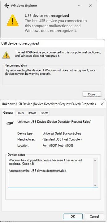

By the way I am having USB 3.0 issues on this Opteron system... Code 43 for some reason, why?  Sometimes it works sometimes it doesn't.
VIA USB 3.0 eXtensible Host Controller - 1.0 (Microsoft)
PCI\VEN_1106&DEV_3483&SUBSYS_34831106&REV_01
Edited by HeyItsChris
The Supermicro H8SCM-F hates 4 sticks of RAM, so I reduced it to 32GB which runs at full speed DDR3-1600, otherwise with 4 sticks it has USB 3.0 PCIe card issues & BSODs galore & the RAM only runs at DDR3-1066.  So now that I have 32GB 2x 16GB in there all the issues went away.  So now I need to order 2x sticks of 32GB DDR3-1866 for 64GB SK Hynix RAM from Cisco.
