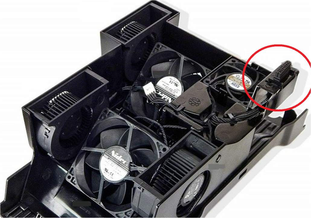

a common problem with the z820/z840 heatsink shroud. The fan connection where it plugs into the motherboard has two little feet on it. Common to have it slip out and not make a full connection.  In that case, the fans will run at full throttle until the proper connection is made. Most of the time, you just slip the two feet back into position and you're good to go. Other times, the feet can be broken, which will not allow for a good connection.

The cooling shroud connection is circled below. Once you take a look at that closely, you will see what I'm talking about when I mention the two little feet that keep it in place. I have used JB quick weld or tape to keep this in place,  Another common problem with the CPU shroud is that since the entire case is tool less, people neglect to take the GPU cover off first and THEN the CPU shroud. The order of operation is important because if you try to remove the CPU part first you can release some of the clips that keep the two halves of it together (yes, the top cover can be removed separately) and as a result the entire shroud will feel like it's about to come a part. This normally don't break, so in most cases you can just pop the top cover back into place and that should tighten everything up.

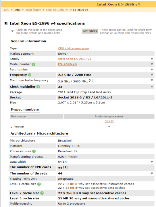

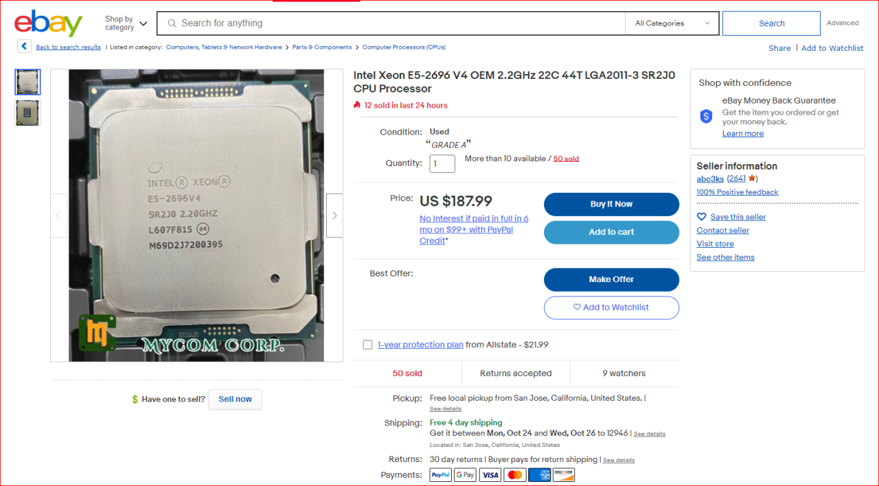

Since I already have 2400MHz memory in this Z840, I figured I would upgrade to E5-2600 v4 series chips to capitalize on that. The memory speed limitation on v3 chips is 2133MHz (which is what I have in it right now).
I will be going from two 18 core E5-2696v3 to two 22 core E5-2696v4 chips. 22nm to 14nm (Broadwell)
Stay tuned. I will be ordering these around the first of November. Benchmarks to follow!
Hoping to hit around 130GB/s memory read - which should be good enough for a top 5 finish at hwbot.org

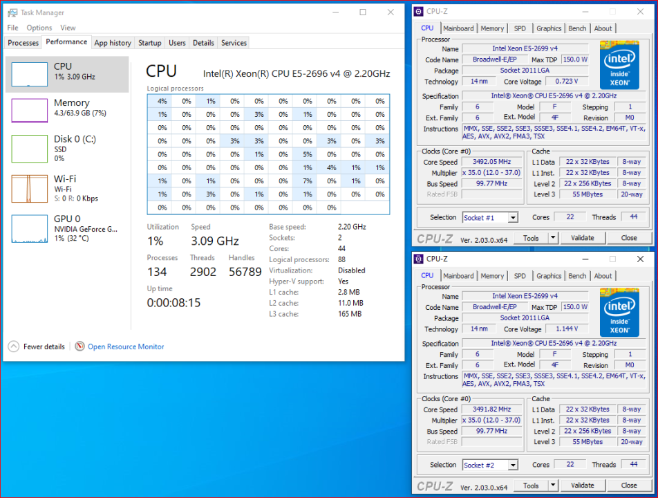

On 07/11/2022 at 01:58, Storm-Chaser said:
Also looking very good in CPUz benchmark.
Nice, almost makes me want to get one for Windows rig lol. But ultimately my main rig is fine. That being said it makes for a decent power rig in the cheap.
