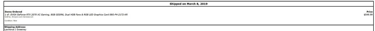

My build started out the opposite way, I purchased a RTX 2070 for an upgrade and it wouldn't post on my Dell. Posted fine on anther build with the same cpu/memory configs so I knew the card was good. Ran across a comment in nvidia forums about how they were having issues with some older dell bios not working right with the new cards. Wife convinced me to build a new comp since the dell was a 2nd gen i7(2013 purchase) and my parts for the whole comp weren't much more than $50.00 over the cost of the card from EVGA.($549.99 +$50.32 tax)  Comp parts were Ryzen 7 2700x ,16Gb ram,X470 Aorus Ultra Gaming Motherboard,120Gb NVME m.2,2Tb sata drive,Windows 10,computer case,EVGA 600w psu. Aurora Fan kit I won from InWin here on the site in a contest. 🙂  Edit: EVGA and Galax have a bunch of 3000 series RTX cards back in stock at semi reasonable prices. 🙂
