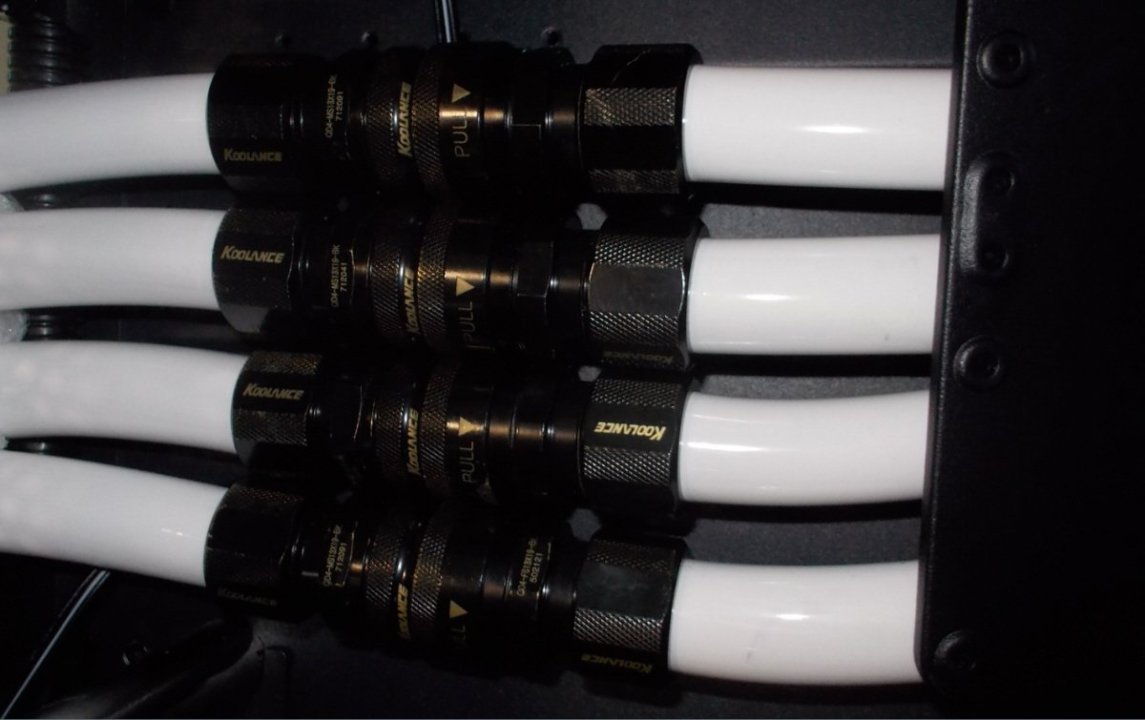

For Quick disconnects, I highly recommend Koolance QD4s (pic below) - not cheap, but work great and offer low flow resistance for my 1/2 inner 3/4 outer diameter loops. I also use Koolance fittings for the tubing...QDs and fittings is not s.th. you want to go cheap on, re. potential leaks, especially with rotary-style fittings.

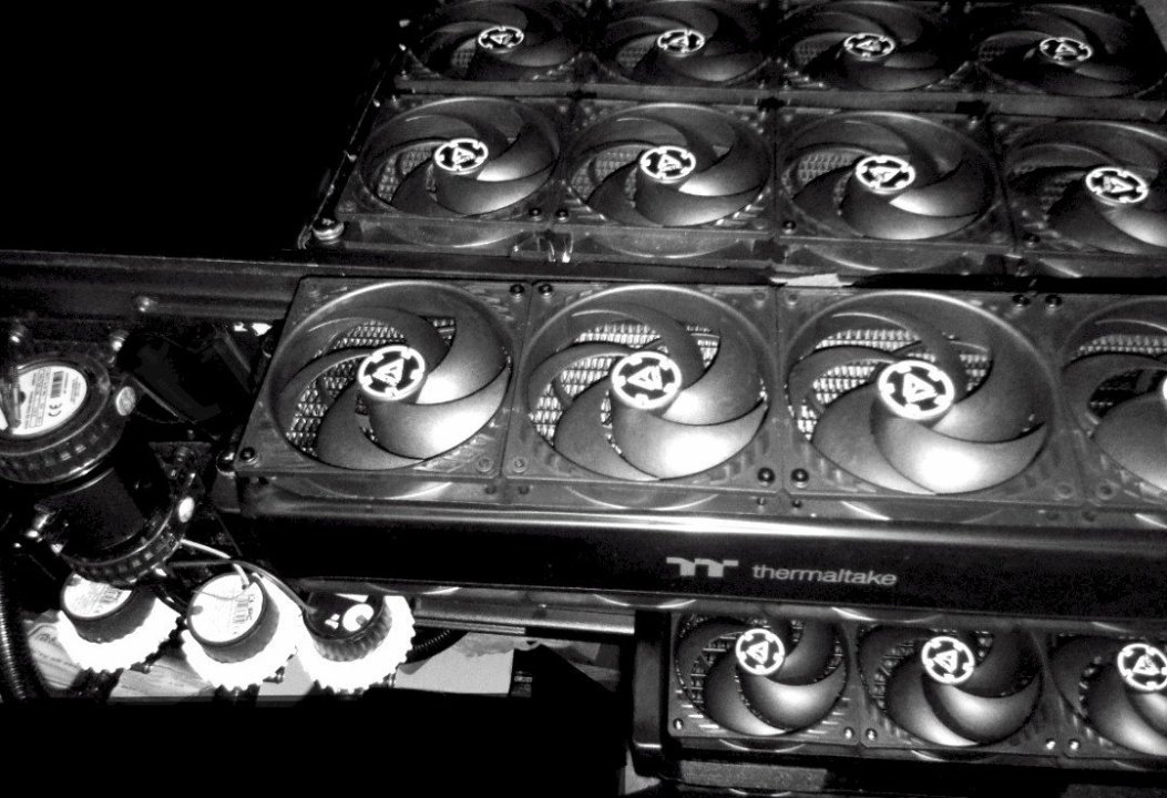

For fans, I seem to have developed an Arctic P12 PST PWR addiction (have over 50 of them across two loops). I buy the no-RGB cheapo 5-packs at Memory Express and/or Canada Computers, btw.

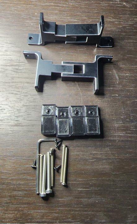

Here the feet i got for the rad on aliexpress.
...Amazon.ca sometimes has better prices for the 5-pack P12s (bought a few there as well), though sometimes Memory Express was a bit cheaper. Anyhow, I use them in push pull on the rads with high fpi / triple cores - in push / pull even at ~ 1800 rpm, they deliver as much cooling as my old GentleTyphoon 3K rpm 'push' fans, but are much quieter 😀
As to QDs, you might find that they come in handy down the line even beyond adding a GPU block. Then again, I switch systems and parts around a fair bit, so to me, they are an 'essential'.
I like those 'feet' you got from ALiExpress a lot !

Il think about those quickconnect am not moving stuff often since am lazy haha.
Yea the feet are great and it aluminium 😁
