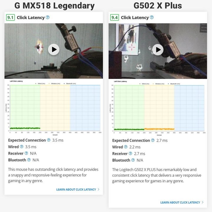

I've had three Logitech MX500 series mice (MX510, MX518, G MX518 Legendary) since I'm guessing 2005, and for whatever reason, I never seriously looked into upgrading them when there was reason to get a new mouse. I've gotten better mice for other purposes (Logitech Performance MX for my laptop, Logitech MX Master 2S in switchable Bluetooth/RF mode between the work laptop and my main rig as a backup), but I held onto old adages when it came to gaming mice such as wired being better than wireless, and just being content with the form factor and relative affordability of the MX500 series to not really consider other options.
I got the G MX518 Legendary just under two years ago because my MX518 had a DPI down button that was getting increasingly stiff to actuate. About a month ago, I started to notice the same thing happening with the G MX518 Legendary's DPI down button too. Also, the cord was getting on my nerves because the cable management solution I put together for my desk limits the amount of extra slack I can pull back towards me, but the natural behavior of the mouse cord during enough use is to retract back into the cable bundle away from me. Well, "enough use" happens multiple times a day.
If I was going to upgrade for real this time, I wanted a mouse that had side-scroll and freewheel capabilities that was still good for gaming. Also, it needed to have at least as many buttons as the MX500 series, because I actually use all of them even for productivity. That really left me with just two options: Logitech G502 X Plus and Razer Basilisk Ultimate.
I've known for some time that high-end wireless gaming mice could match the latency of wired mice. What I wasn't aware of was this (from Rtings):
They're faster wireless than the modernized version of the MX518 is wired.
So, Logitech or Razer? I've had Logitech going back to the Microsoft IntelliMouse Explorer 3.0 days, but it wasn't necessarily brand loyalty so much as knowing what I would get with Logitech. What it boiled down to was the least bloated and buggy software. Based on reading what users have complained about, Razer Synapse seemed like a bigger disaster to me than Logitech G Hub, and Synapse is also cloud-based for some reason I have a hard time accepting.
So I decided to camp out on eBay and also spring for the G502 X Plus Lightspeed version for the ARGB. I mean, if I'm not going to pay full retail anyway, why not? Paid $128 for a brand new unopened $160 mouse.
The trouble I go to just so I no longer have to yank the cord towards me every few hours. The crazy thing is that I have no idea how long I'd subconsciously gotten used to doing that.
