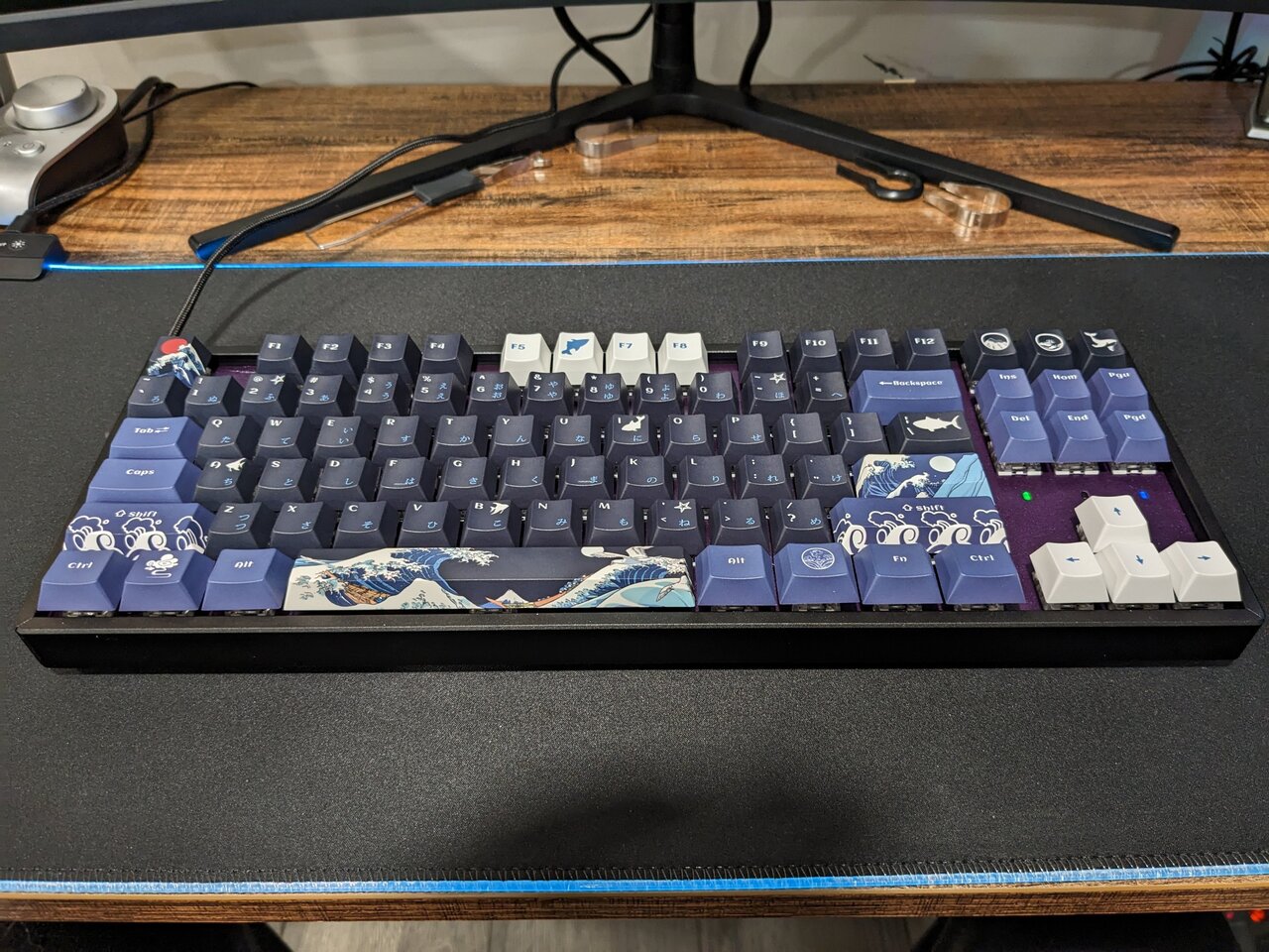

Anyway, I also built a new keyboard for my rig. Using it currently.
Keychron K8 Pro TKL, Kailh Box Navy switches, Captain O-ring blue o-rings, SDYZ Great Wave Off Kanagawa keycaps, custom Classic Muscle Car plum crazy plastidip on the top plate.

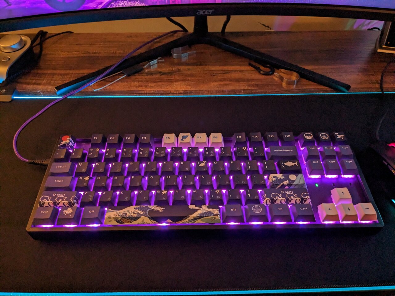

New keyboard for my build.

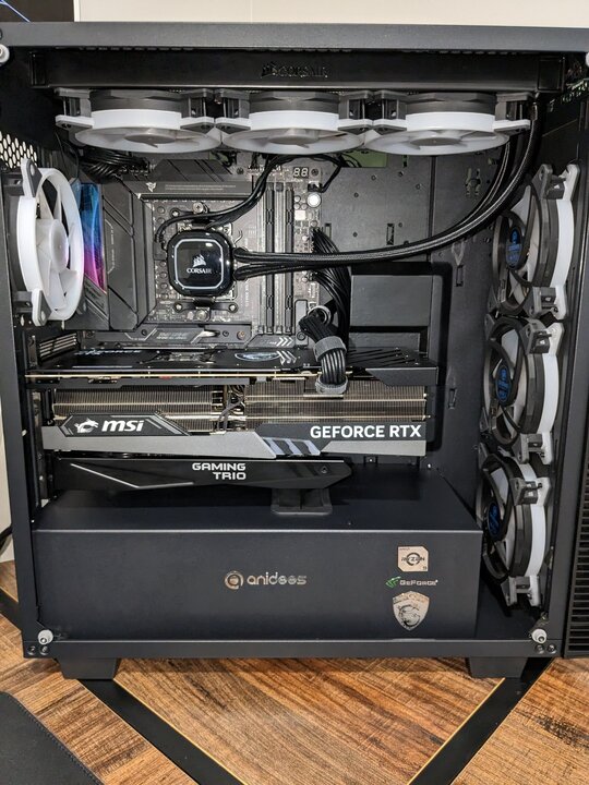

SEASONIC.COM
Alright, we got a new PSU and made sure not to have a bend in the 12VHPWR cable. Here's some photos. We need to get clamp style cable combs. (These cables are sleeved from the factory)
Ran the cable from above like UltraMega suggested.

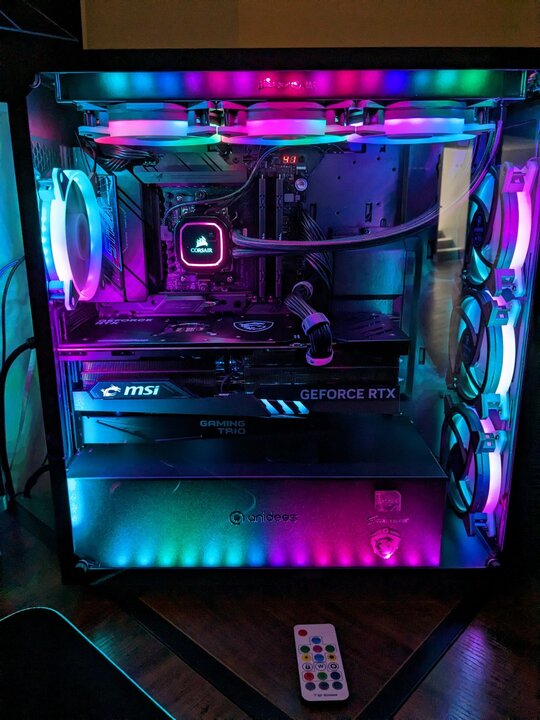

Found a way with my phone to better capture the correct colors of the LEDs in my rig. So here's a few pics.

Better video of the RGB lighting in my rig. Noise is from a dehumidifier near it:
Also got some cable combs coming tomorrow for the 12VHPWR and ATX 24 pin that we're going to put in.
