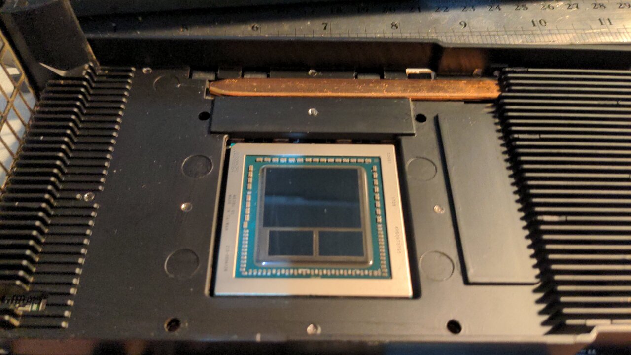

There's a couple guys selling a whole bunch of these old server cards on ebay. They are listed as buy-it-now for like $70-80, but one guy took my offer of $60 shipped. Not too bad since I sold an actual Vega 64 for $200 a couple months back. These server cards only have Linux drivers, but can be used with Windows if you flash it to WX9100, which also gives you output on the mini-display port. Thanks to a few guys at techpowerup for this idea.

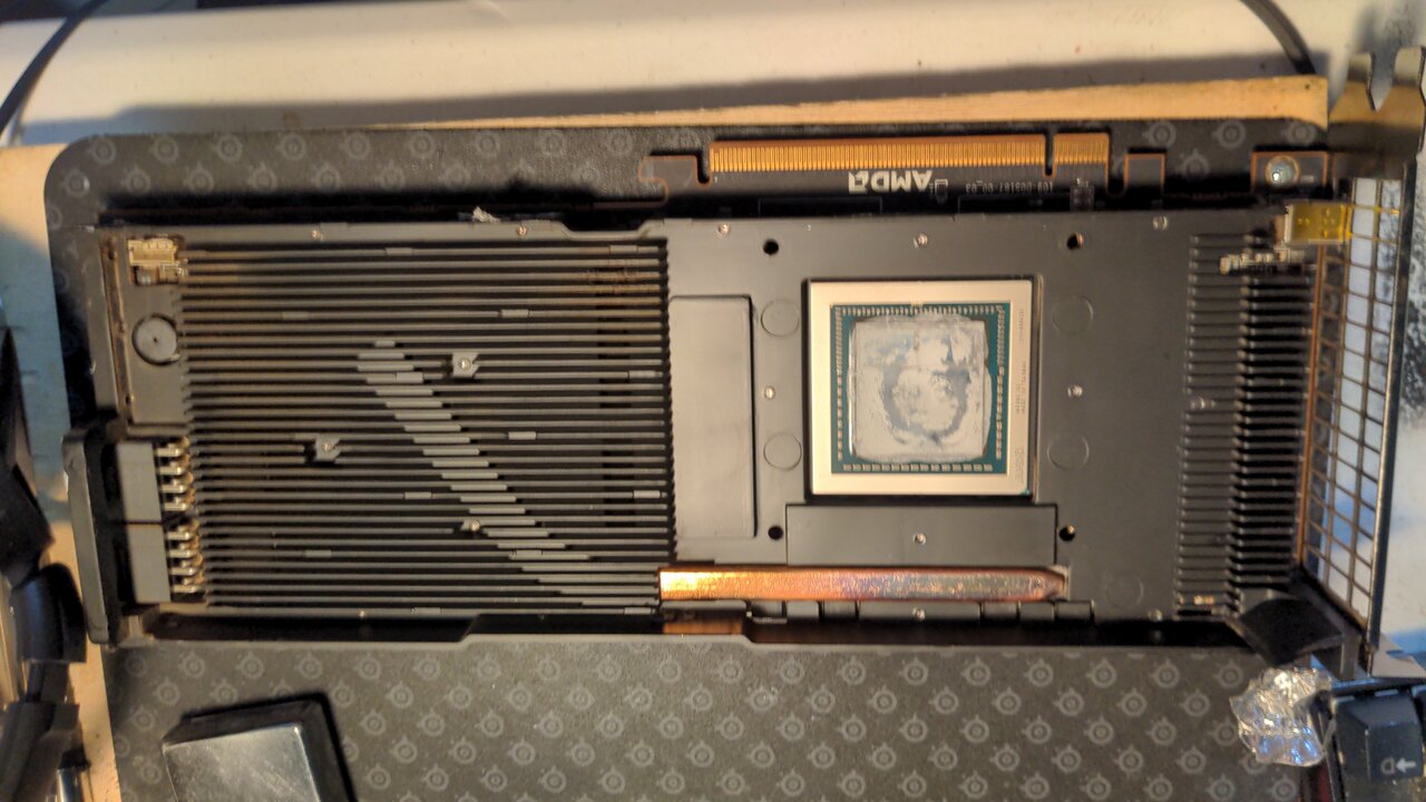

These cards have no fans, meant for high rpm server chassis fans to blow through. I saw some 3D printed adapters, but I happen to have a cheap universal water block I'm mounting. Going to need a little bit of metal cutting to get it to fit!
Had to cut out that tab on the base plate. Also that heat pipe was just laying there, not soldered or anything so I coated the backside with MX-4.

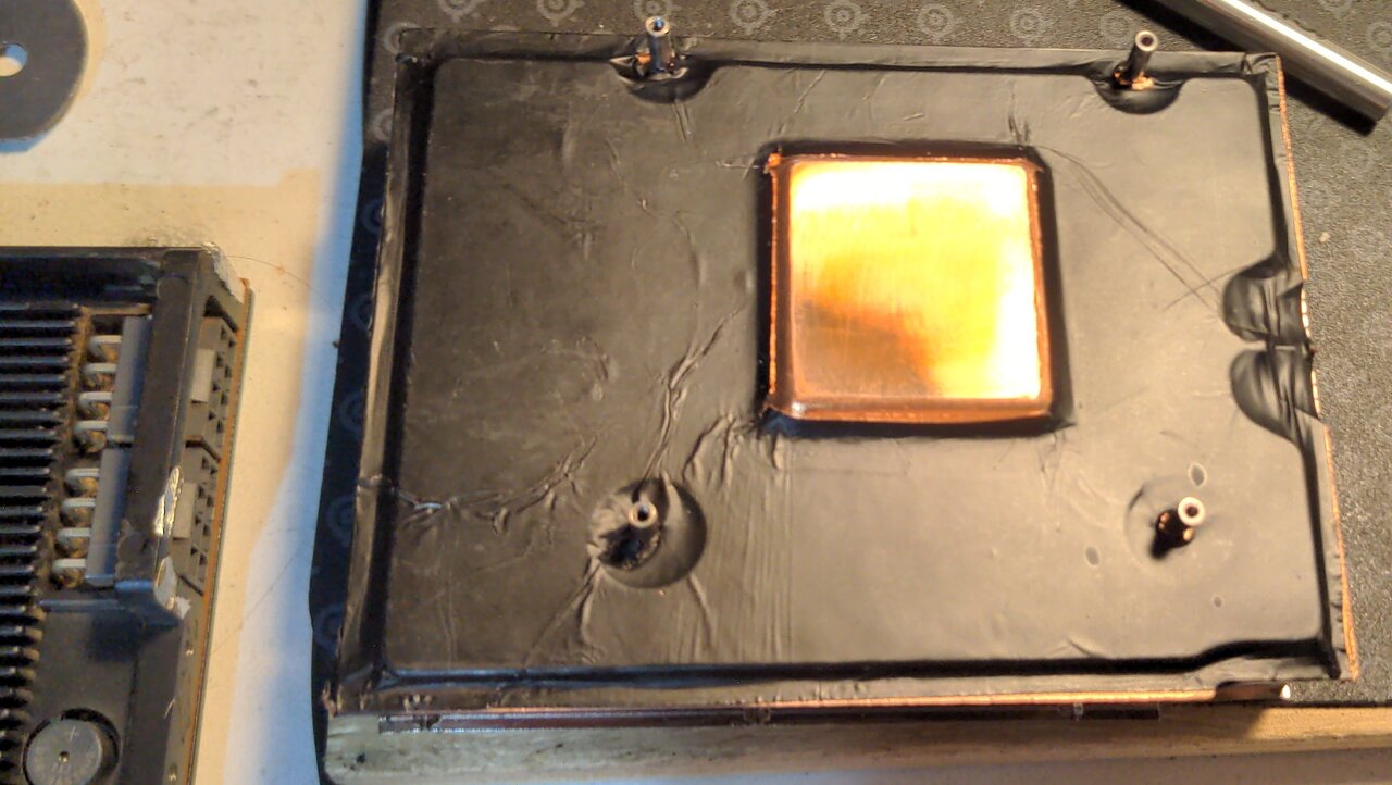

Cheap ebay GPU block fit the Vega die exactly. Looks like the tubes will have enough room.
I wanted to keep the base plate because it keeps the VRMs cooled. I reused the stock thermal pads since they were in good condition. Base plate also connects the back plate.

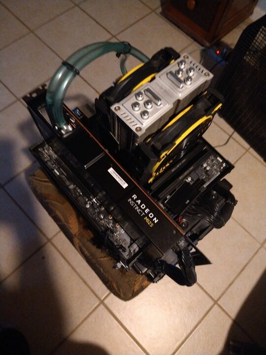

Looks good enough like this but I wonder if the shroud cover will also fit back on?
Yes just had to trim the aluminum. I need to sand down the edges and put some black polish on there.
So this is how it will look. Going to get it running this week on one of my folding benches.

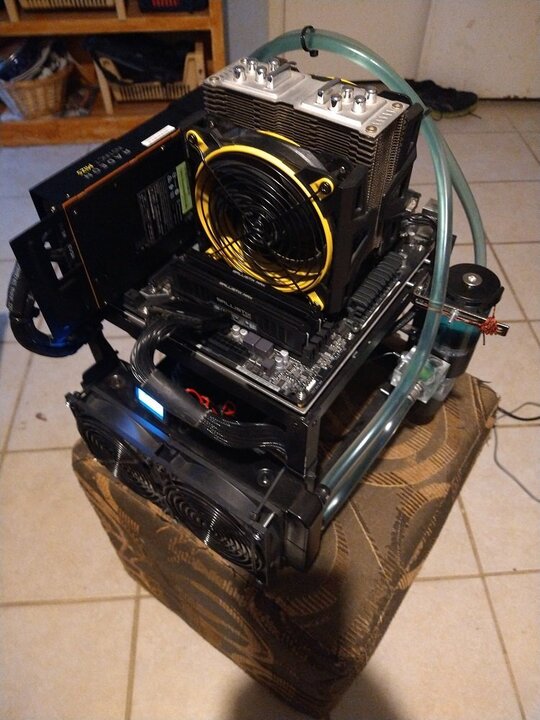

Filled the loop back up and letting the pump run overnight to check leaks and collect air bubbles.
That's a small cut I had to make on the shroud for the tubes 😄
I like the look of the shroud, but if VRM thermals are bad then it's coming off and I'll strap a fan onto the base plate.
It's only a 240mm cheap aluminum radiator. I imagine it will be fine, but we'll find out tomorrow when I run it hard.

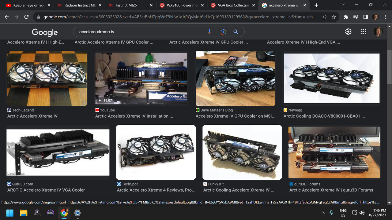

1. Can you please tell me what is the actual spacing for this block/screws (in inches if possible or mm)?
I have some cooling for gpus such as Accelero Xtreme IV (by Arctic), but it doesn't fit every gpu, in fact 3070 was already past their support, but MI25 is older, so I am keeping my fingers crossed. Cooler has adjustable screw holes, so I hope it can accommodate. Smallest one is 45mm x 45mm spacing:
WWW.ARCTIC.DE
High-efficiency cooling with a patented back side cooler which keeps the board including all sensitive components around the GPU on low temperature.
Fury, Vega, and VII's GPU+HBM Heatsink mounting pitch is 64mm x 64mm.
s far as I can research, that 64x64mm square mount is 'unique' to AMD's HBM-GCN/NCU cards (not sure about BC-160/V520/V540 HBM-Navi, though).

I did manage to non-physically verify that is the mount via both Aliexpress listings for coolers, and old Reddit Posts.
I too, have been on a quest to try and find an affordable air cooler that'll fit my MI25 -> WX9100.
I've almost bought 3 'for parts' Vega/Fury 'partner' cards that came w/ better coolers. Sadly, many completely delete the frontplate and have too big of a coldplate to just mount-on unmodified.
I want to keep the frontplate for VRM and board-component cooling, and I don't want to have to dismount it (potentially, ruining thermal pads).
So far, the 'best' option is just 'eating it' and buying a Morpheus II Core off Amazon. Unfortunately, that costs more than the card did...
So, you are on the quest too! HAHA! 😄
Awesome
I just confirmed by checking that Accelero cooler is 60mm at the largest hole position from screw to screw. So, it is not compatible with Vega 64, if MI25 matches the hole spacing it will be incompatible too. After we confirm ;- )
You are correct on the fact that Morpheus II Core does fit Vega 64, and indeed it is more expensive than MI25, if you can find one. Since they are discontinued, as far as I know.
