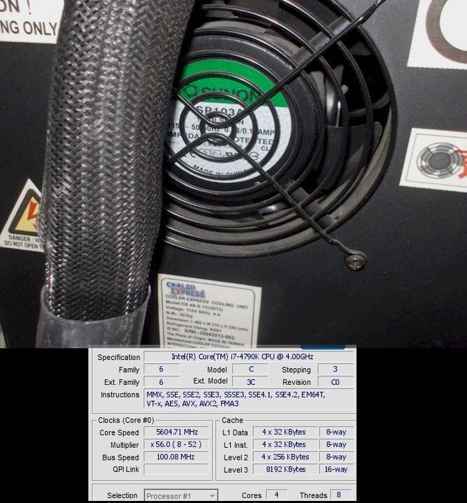

Absolutely. I was perfectly happy with my 4790k and GTX 980 until I upgraded off of 1080p.
These days:
Good ol' days 🤭
These days:
Good ol' days 🤭
Wow - nice OC with the chiller!
