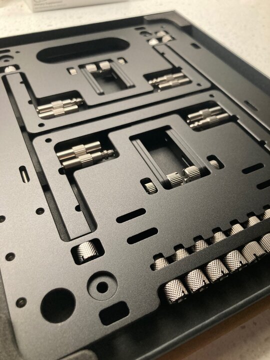

Took a chance and ordered a black BC1 Mini V2 along side a power / reset button direct. Seems to cost very similar to Terra but offer more flexibility and functionality. Debated on silver but I think black would be more practical with most components. ETA 7-12 days. Thank you both for your feedback 🙂

Nice that was a quick decission… i think you will not regrett it. Just be carefull with the assembly…

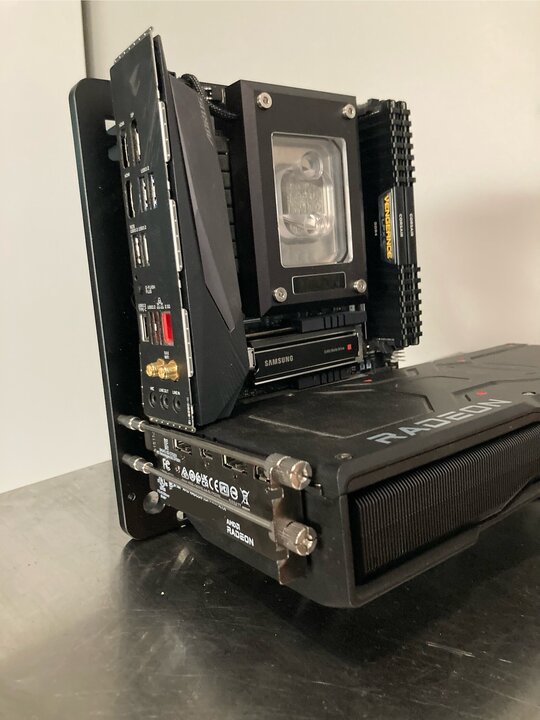

I started to test fit the components. GPU is too heavy to have the bench stand up vertically without toppling forward.
See how it goes with an air cooler but likely won’t stand up.
I mounted the TechN block just to temporarily cover the CPUz
Another small update: Old Xigmatek definitely won’t fit with its included mount, too short to modify. It’s AM2 / AM3 style.
