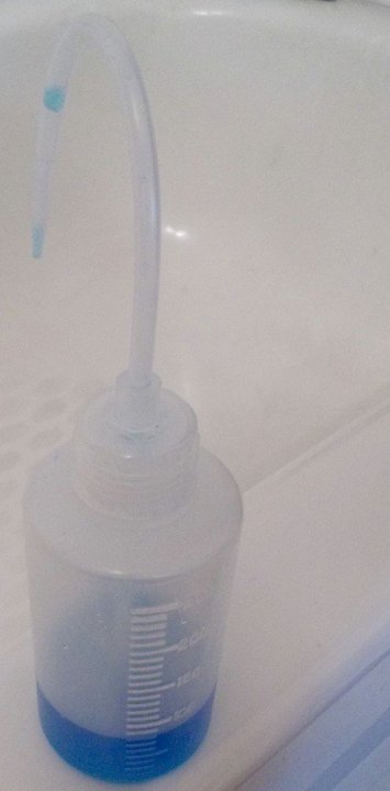

Did some basic maintenance on the workstation yesterday, such as checking fluids for both loops (5x 360/55 rads...). Fluids look like new even after 22 months...all told, I only had to top up with 20 ml over that whole period...

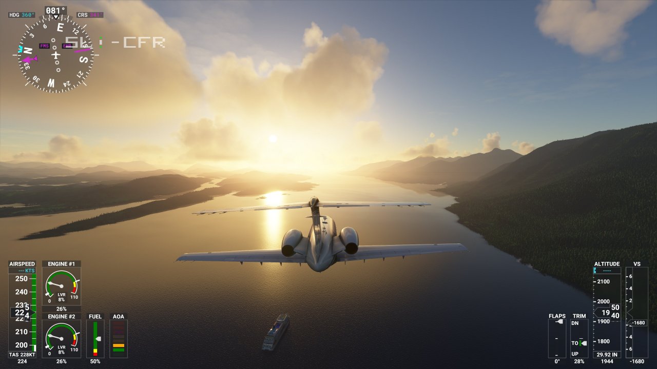

...debating if / when to upgrade...but so far, no real need via new use cases...and this 'work'station has even learned how to fly ?
Time does fly, just like that 'work'station :classic_laugh:
What sort of fluid do you use?
1/3rd distilled water, 2/3rds Thermaltake '1000' - not sexy, but I have very positive experience with it over multiple builds and many years...rated for multi-metal use as well
