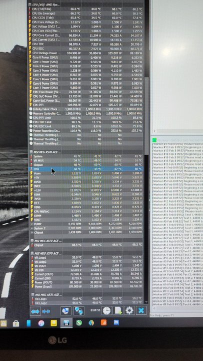

I got it figured out. My heat plate fins were oriented in the same position as my jet plate. I had placed the mounting plate wrong, fixed it, and forgot to check that. 20 mins p95.
The flow is really good now. I can now get into that oc.

Temps dropped 10C when I started tweaking the PBO too. I even got them lower which I'll post below. I guess the defaults in PBO pump 5950x power through the chip? Still working on getting those settings stable and balanced. +200 Mhz right now. Geekbench went up 1200 points on single core performance.

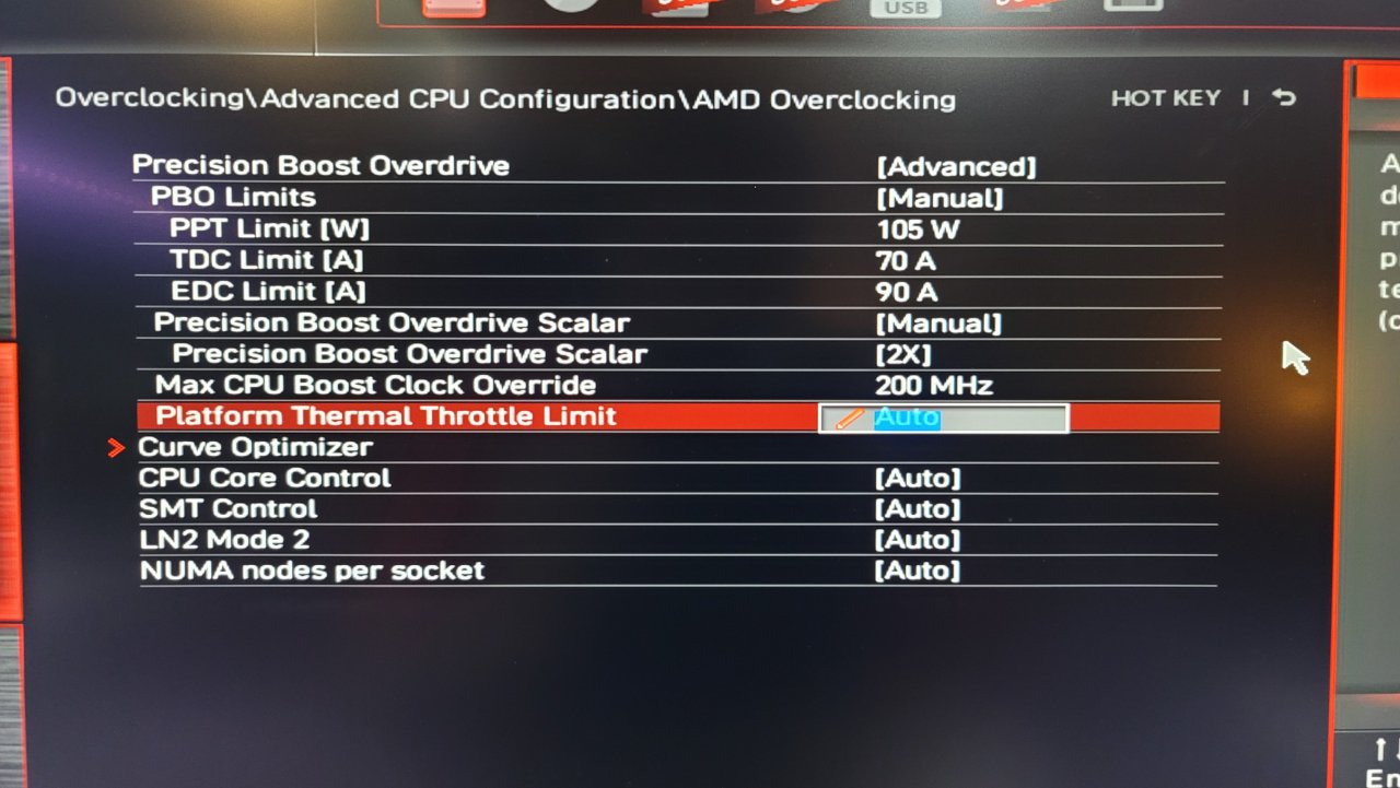

Alright, I've played around with the PBO and All Core Overclocks quite a bit. I'm figuring it out, but when I use PBO, and AMD Overclocking Auto Voltage, the voltage is a bit ridiculous! 22% usage and 2 cores boosted and it's averaging 1.465v.
My MSI MEG x570 Ace turns off boost if I manually set the voltage, so what's the key to reducing max voltage?
Hmmm but you dont want to disable the boost element otherwise CTR would not function, so leave voltage alone I would think and just use CTR to adjust the voltages to avoid silly spikes.
