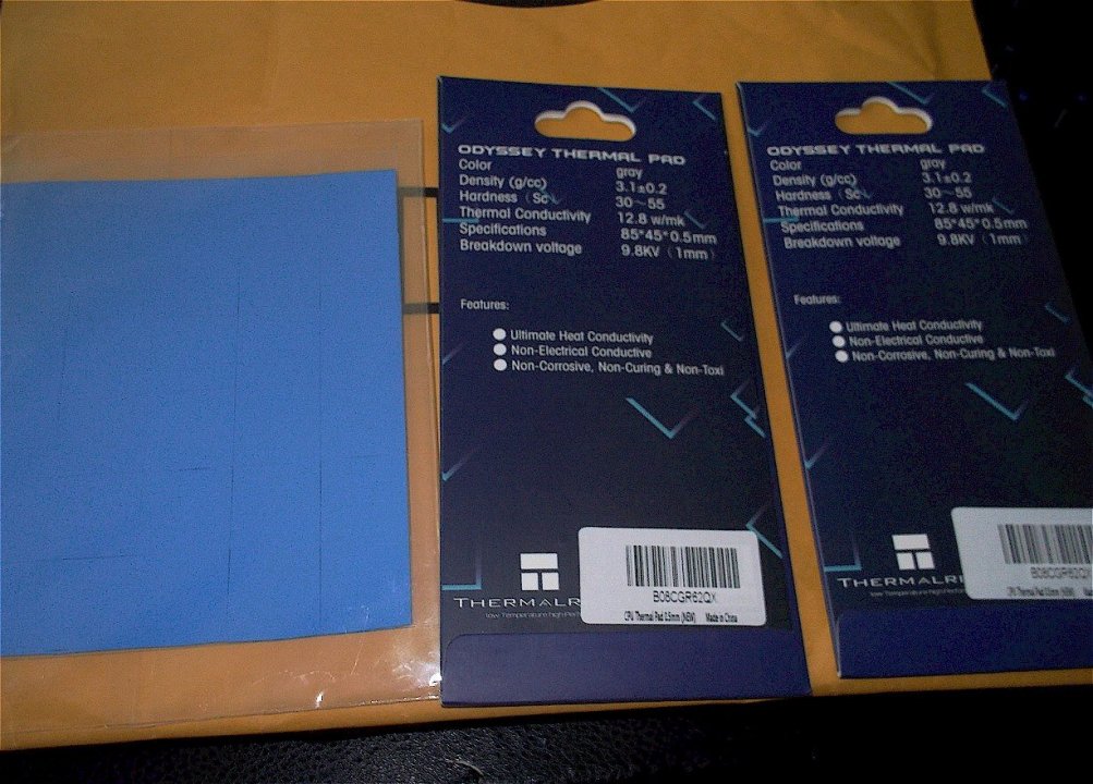

...well, lookie here what @ENTERPRISE 's cat dragged in just now - the first of multiple deliveries for  the next12 days or so for a big dual-loop build. That blue stuff on the left is also thermal material (but 1.5mm, slightly thicker) and pre-cut for VRAM...
...Enterprise is probably looking for his cat right now (which is actually on another continent...). Anyway, I fed it ?

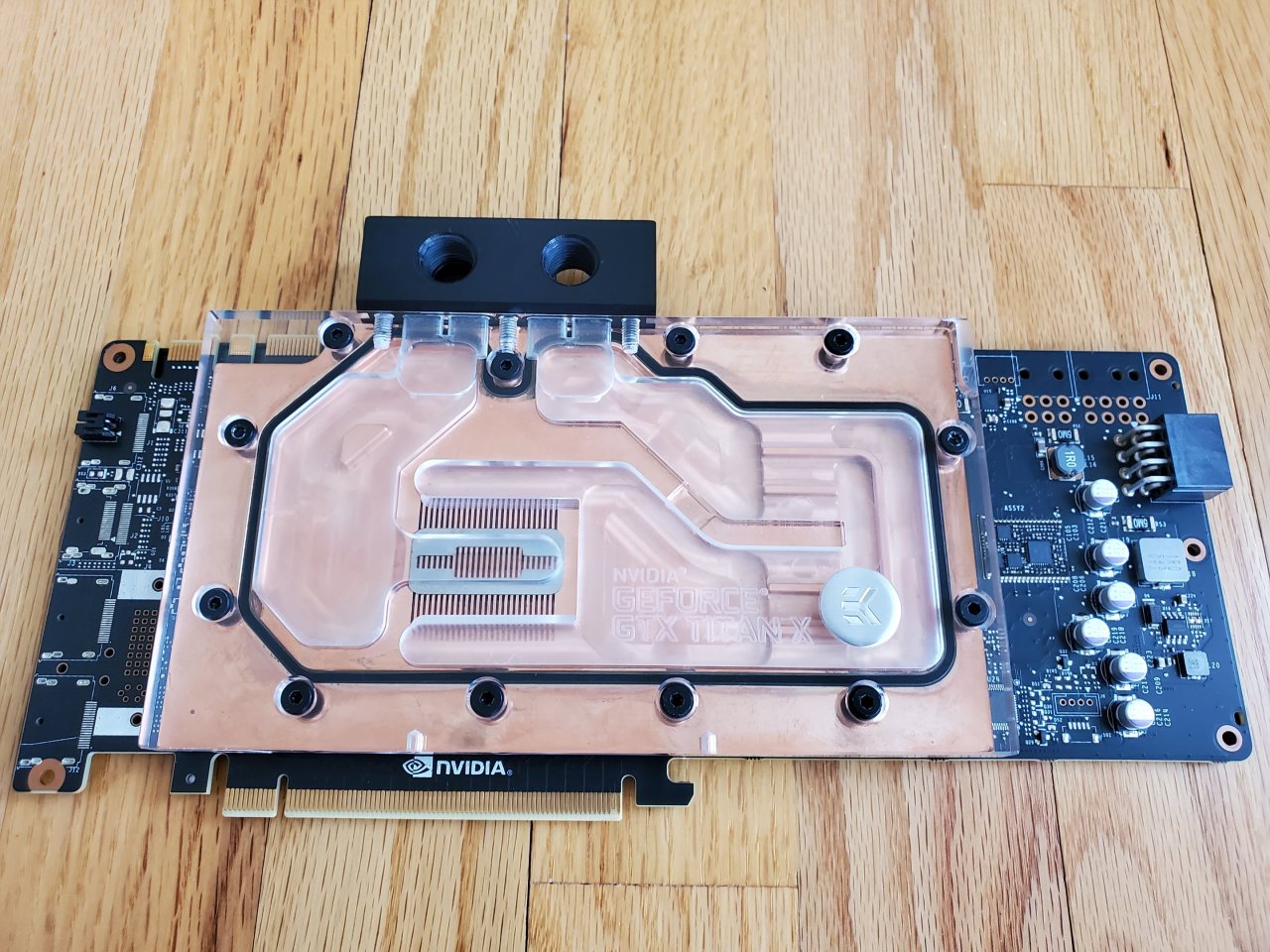

@ENTERPRISE Not 100% certain, but it looks like the GTX980Ti/Titan X waterblock will fit the M40's. I would absolutely love to make a massive watercooling project out of them, but the damn waterblocks cost more than the cards.  See Below
https://www.aliexpress.com/item/32967113974.html
https://www.performance-pcs.com/water-cooling/water-blocks/water-blocks-vga/watercool-heatkiller-iv-xl-for-gtx-980-ti-and-titan-x-pure-copper-ni-wc-15562-d.html
I love Watercool Heatkiller and like Bykski (have both, the latter as OEM). However, there's a fellow in another thread who has a Bykski block for his 3090 and after just a few months, the nickel plating is apparently flaking off in one area. This can happen (it did to EKWB years back), but it is obviously a sign of a quality control issue for that batch at least.

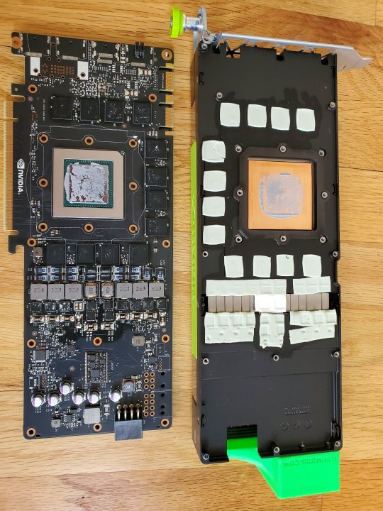

Here you go @ENTERPRISE looks like 1.5 or 2mm pads to me.
Now to see if this 980ti waterblock fits, if it does, I will be buying 4 more for a crazy project!
Nice one ! Thanks for letting me know bud. I will purchase some new pads soon with a view to "refurbing" the cards prior to their folding action.

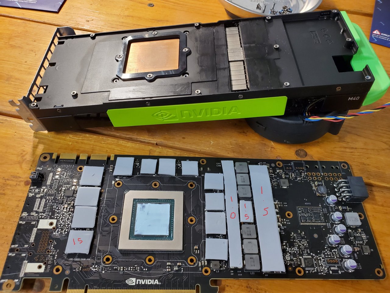

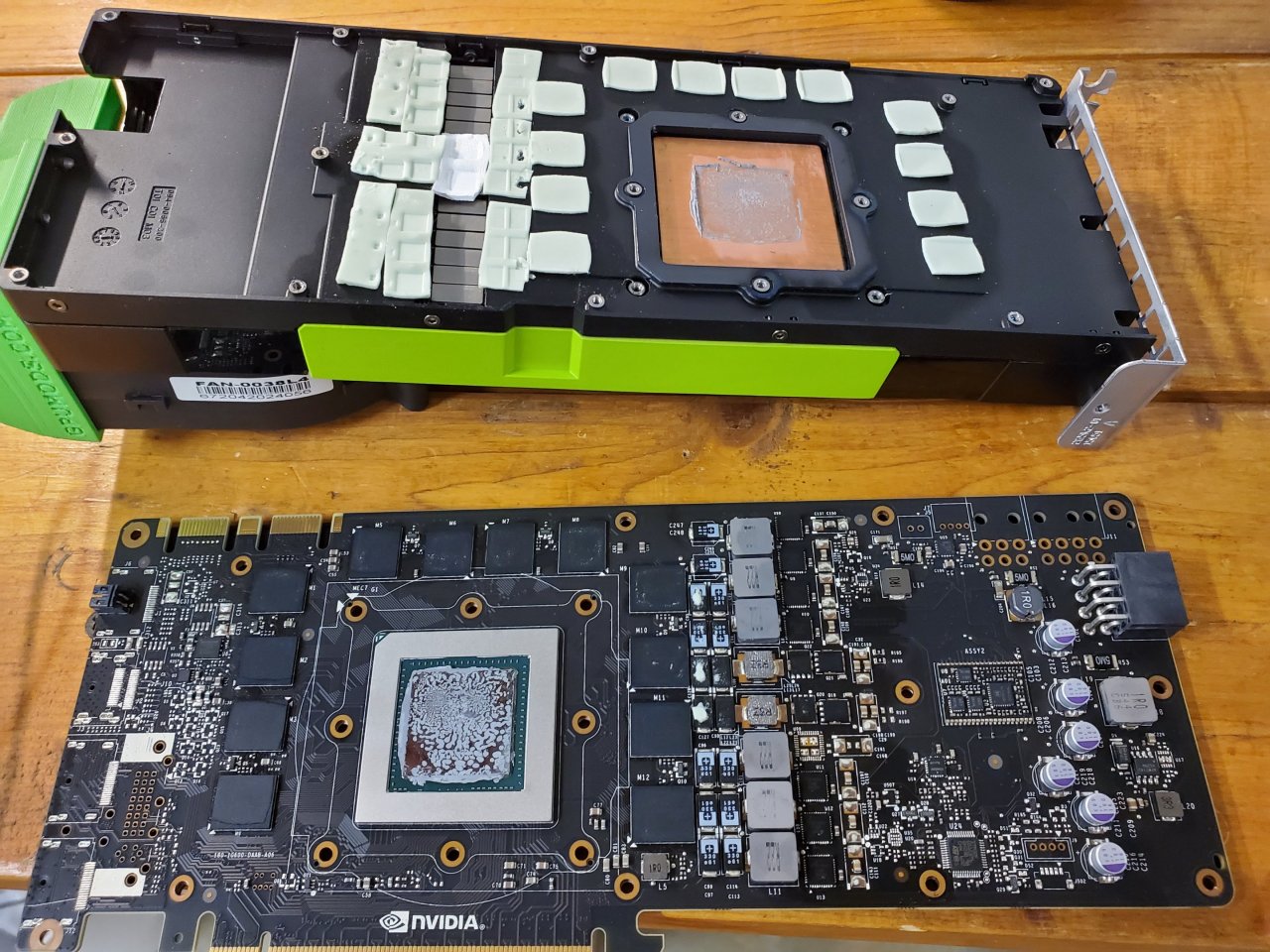

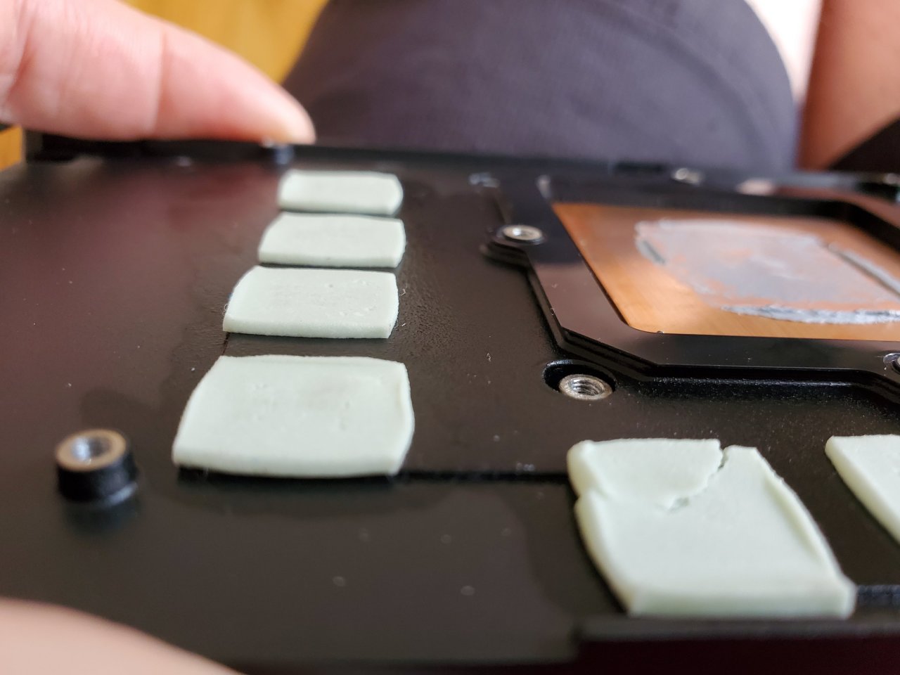

So projeck for the day is to get the 5 Tesla's that will be on air completely renewed. Looks like it takes 1 package of 1.5mm for each card @ENTERPRISE Takes about 20-30 minutes per card to do it right. I found that using a TIM spreader will take off the old thermal tape without scratching the cooler.
Old. The TIM was so dry that it cracked and caked off when I tried to remove it!
Renewed.
Renewed.

Nice ! Well that stops me from ordering unnecessary materials. Looks like I will be getting those 1.5mm pads for the M40's then. Better order it while I am thinking about it haha.
The otherside (Backplate side) takes 0.5mm on the 12 DIMM areas. I did not bother to replace them, but will at some point.
Ahh ok, good shout thanks.

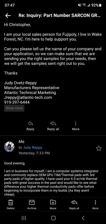

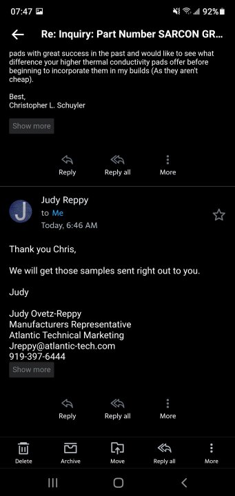

Thought this might be of interest to you guys. I took a shot in the dark and it worked! I was browsing the fujipoly site and saw an area to request free samples, so I thought, can't hurt to try right? This is the correspondence with my local Fujipoly rep. 17w/MK pads here I come, I also requested the thermal putty. We'll see what they send.
I mean technically I didn't lie. I work for myself and I am a "Systems integrator" and I do replace stock pads with 3rd party choices. I'm actually gitty inside. Never got anything free before computer wise.
