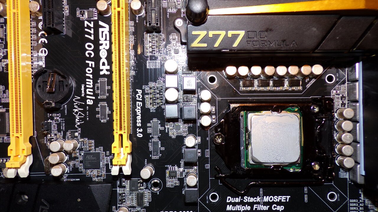

Speaking of boards, currently baking a Crosshair in the oven to dry it out for some Ln2 action later.
If this works to fix it's current issues about acting out I'll get some nice runs done. Don't worry guys - It's on the lowest setting the oven has (170f/83c) so it's not exceeding any thermal limits of the components.
Gonna just let it sit for awhile and let the heat do it's thing.

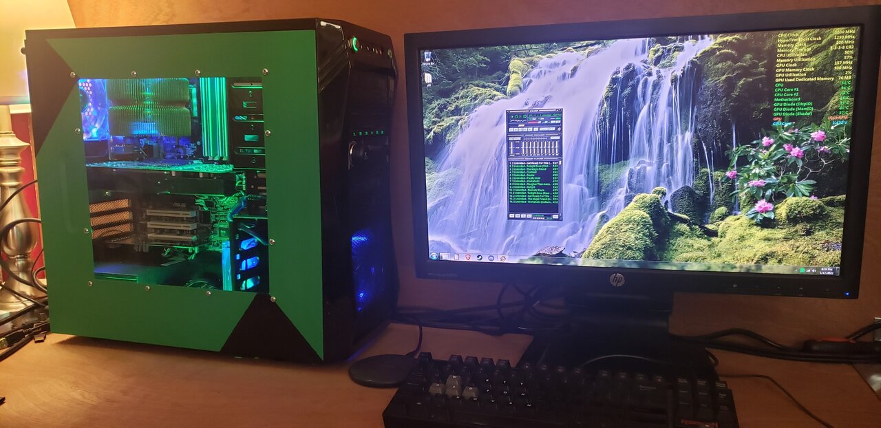

Alright, I've got MOST of the orders in now.  I can, in theory, finish the 939 build I have going, and I can now build the second SLI 939 build.  I'm missing 24pin to 20pin ATX adapters for the Socket A rigs (should've checked that), but those are on order.  Missing 2 sound cards, one LAN card, and a 60mm to 80mm fan adapter all for the Socket A rigs.  So once those arrive, I'll get busy.
First of the 2 Socket 939 rigs is up and 100% functional now. :wheee:
I'm currently trying to get the famed 3GHz stable on it right now.  Enjoying Winamp and the Xonar in it.  I think this is my new favorite machine to play music through! 😄
It hasn't changed much, but here's the specs.
  • AMD Opteron 180
  • A8N SLI
  • 4x1GB Corsair XMS DDR400
  • Sapphire HD5870 1GB
  • HP 64GB SSD
  • Seagate 2TB 2.5" HDD
  • eVGA BQ600 PSU
  • Zalman CNPS 9500 CPU cooler
  • Yate Loon fans all over it
  • 6 spot fan controller from UltraMega
  • Samsung DVDRW with Lightscribe
  • ZIP 250
  • Floppy
  • Asus Xonar DG Sound Card
  • TP Link Archer T4E Wireless NIC (onboard giga LAN is fine for LAN)
  • Windows 7 x64 on it right now
  • And of course, my Thermaltake cig lighter / ashtray / cupholder thingie
  • Custom painted / windowed Rosewill Challenger case
Overclock I'm trying to get stable:
  • 250 x 12 for 3GHz
  • HT Link at 1250MHz (stock 1000)
  • RAM at DDR400 (200MHz) because 939 defaults to 333 as fastest divider with 4 sticks
    EDIT:  I'm now down to HT Link at stock 1000 and RAM at 333.  This Opteron 180 isn't a great chip.  Seems to be good, but not great.
