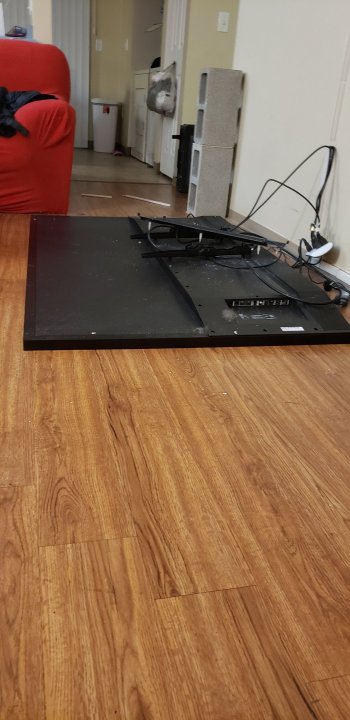

Here's a tech tip.......
DO NOT EVER USE DRYWALL ANCHORS!  ALWAYS FIND A STUD.  IF NO STUD, USE 2X4'S ON THE STUDS TO MAKE A PLATFORM.
Yes, I had to yell that.  This was a very VERY sad and expensive loss.  I never even got to watch a 4k movie on that.  75" TCL 6 series that I had owned less than a month.  It took it literally 5 hours to fall off the wall.  Was late at night, so I had absolutely no assistance to pull it down safely before it fell.
To answer the question at hand (sorry for double post, its intentional but so I can separate joke from actual help).......
If the TV is light enough in weight, honestly drywall anchors aren't so bad if you get good ones.  I've successfully had up to 50" TV's just fine on drywall anchors.  I personally wouldn't mount a big one again obviously with anchors, but anything under a 50" should be fine with anchors really.
Assuming its a smaller TV (under 50"), just get a monoprice bracket and use the included drywall anchors.  They're quite heavy duty (for drywall anchors).
If you're looking for some sort of an adapter to actually utilize the power box....don't.  You'd be better off using 2x4's on nearby studs to make a platform.
