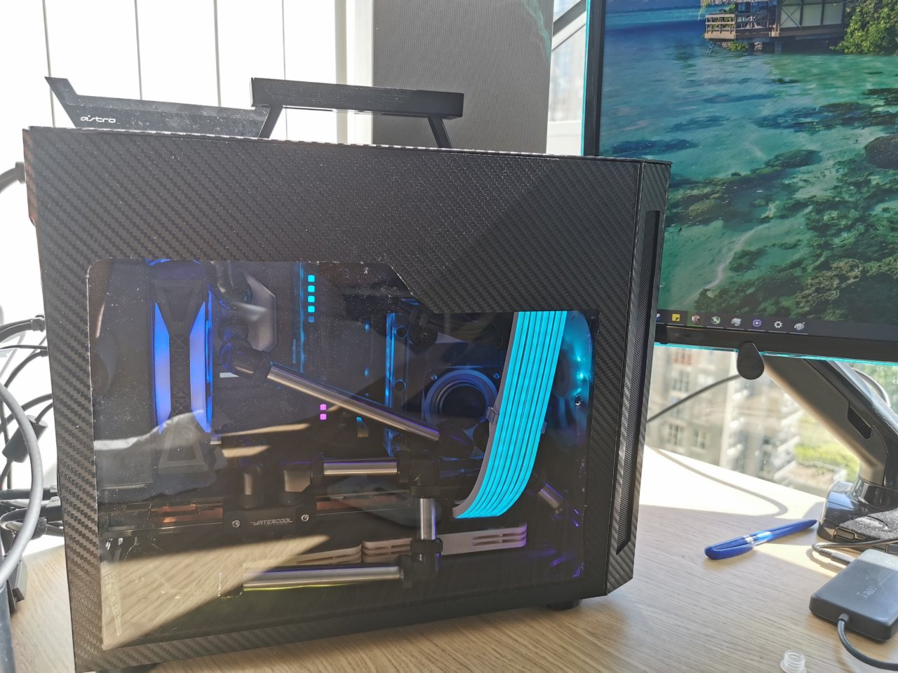

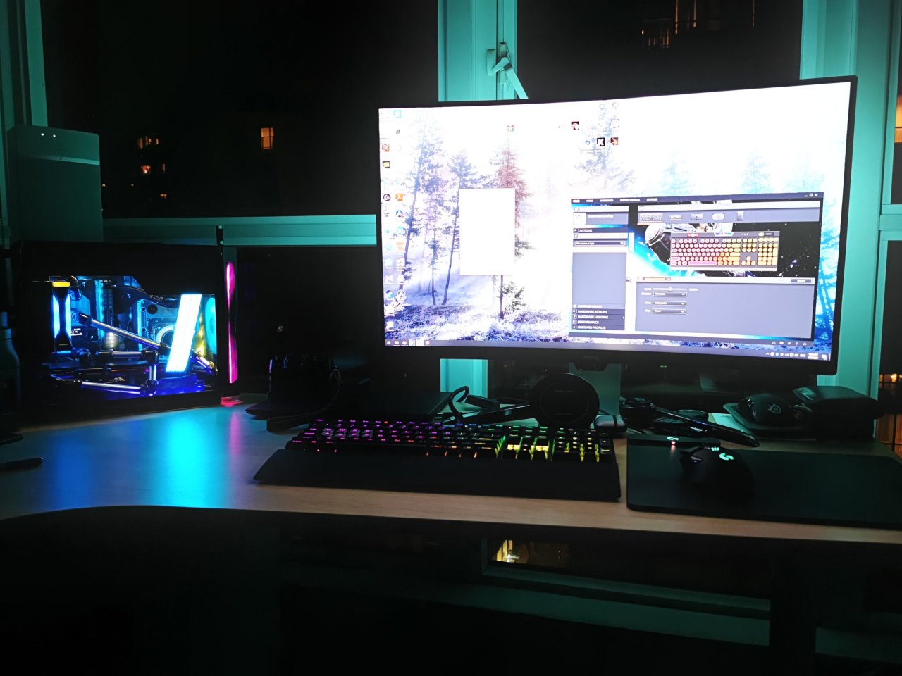

I attached some pictures of Flying Dutchamn

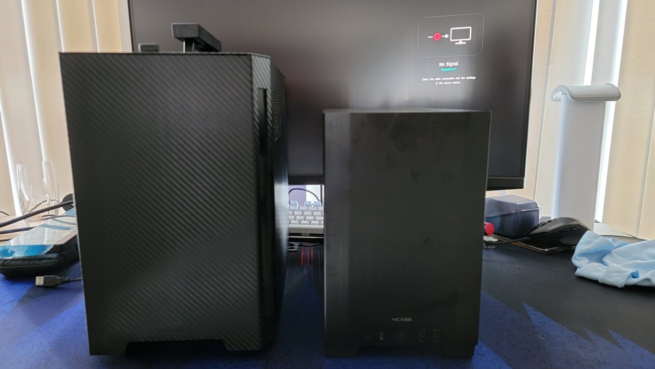

I got a case today, so some posing pictures tomorrow and comparing sizes

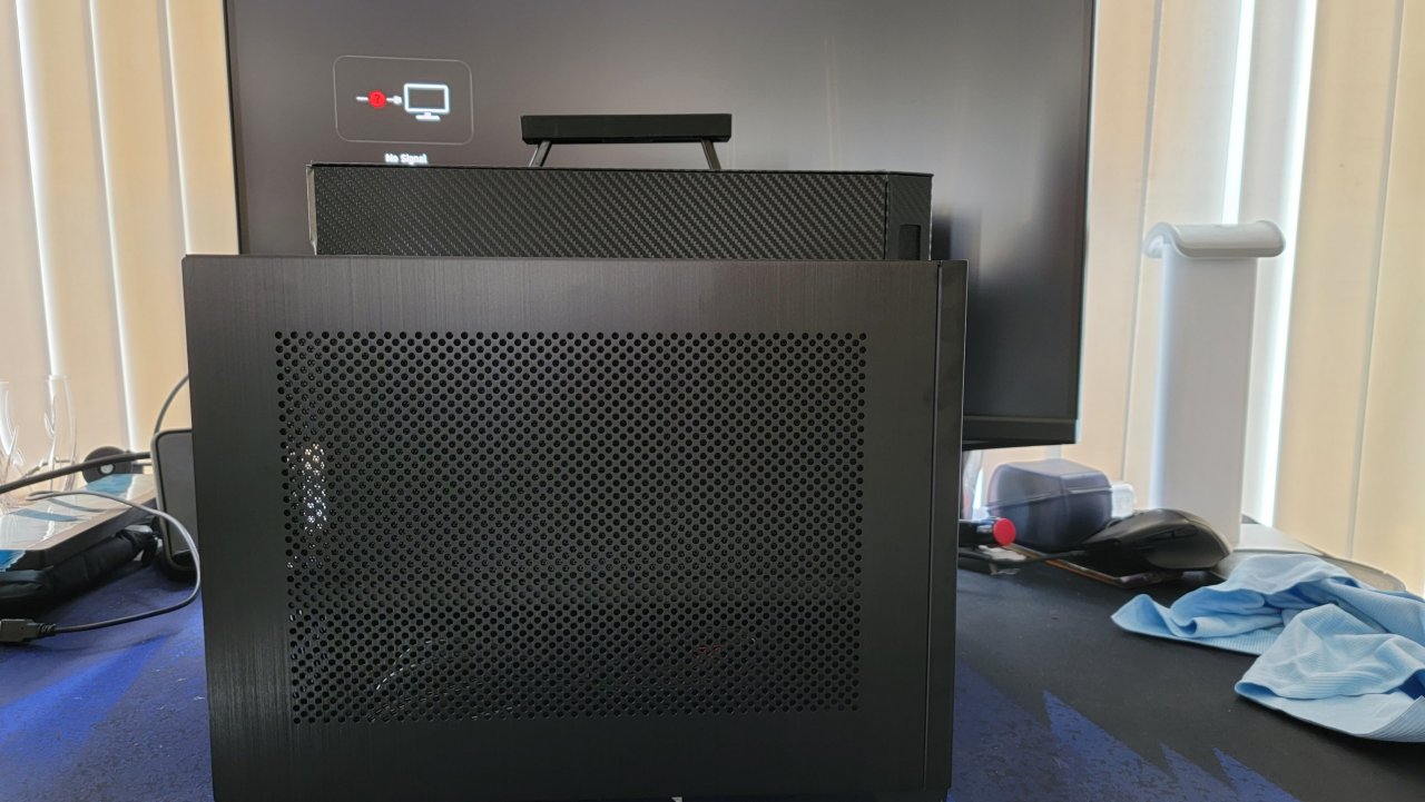

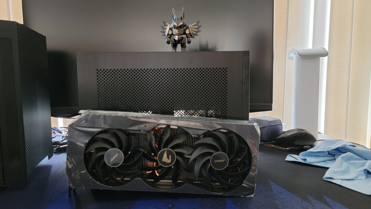

So since forum was down, some of you might of saw this pictures already, but at the same time , i didn't do much progress
Couple of updates,
I got new ram, Crucial Ballastix 32GB cl16, it finally came back in stock
I finished swapping gpu cooler  and ran a test run for size,
In the last picture, there is a little surprise that came this morning and it fits like a glove.

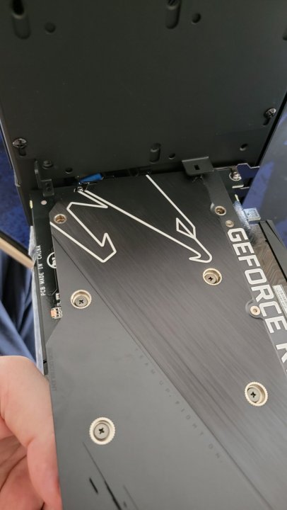

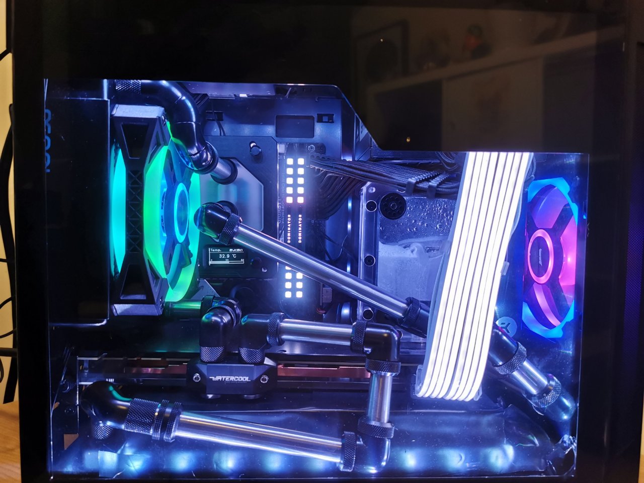

Small progress update before work. Tucked so many extra cable behind that rad. I also dig these barrow step fittings in a clutch with my gpu length.
Also heat shrink that front power button in 3 layers. Hopefully it won't move cause it will be pain in butt to repair
Last picture, I had to take io plate off in order to fit card inside....

Looking good. Those hard 90 extenders kill flow. I am surprised you didn't go with a dual or triple rotary, they are much easier on flow and extend roughly the same distance.
Issue is @Avacado
I need a step, half of the hole covered by gpu. Alternative is Koolance low profile 90, I have 4 of them, but I'm not sure if any will be left for spare.
I wish I had reference 3080, but beggers can't be choosers , so hopefully won't be that much of an issue. Thus said, I need now to either cut out bottom or grind of stop plug on gpu, otherwise terminal is tilting gpu at angle
