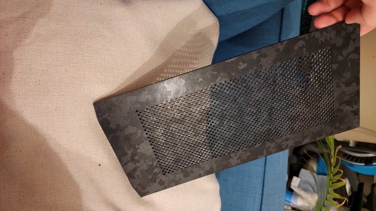

More tight fitting is being currently made before I cut last tube. I am hiding all cables and essentially cramming every last mm of space I have.
I was able to implement 92mm fan on the bottom back it will be partly chocked but it will drag hot air from bottom rad and pulling a bit of air from front of the case.

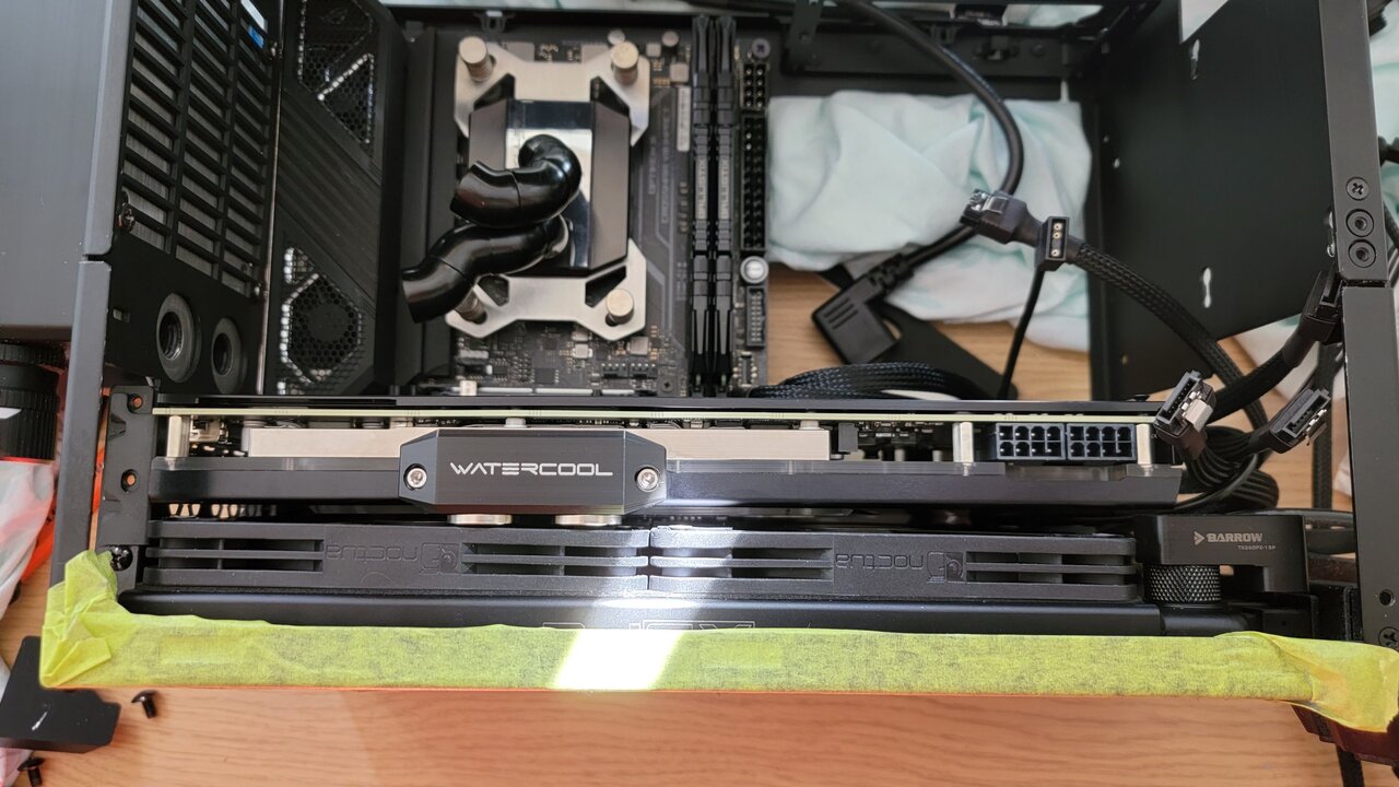

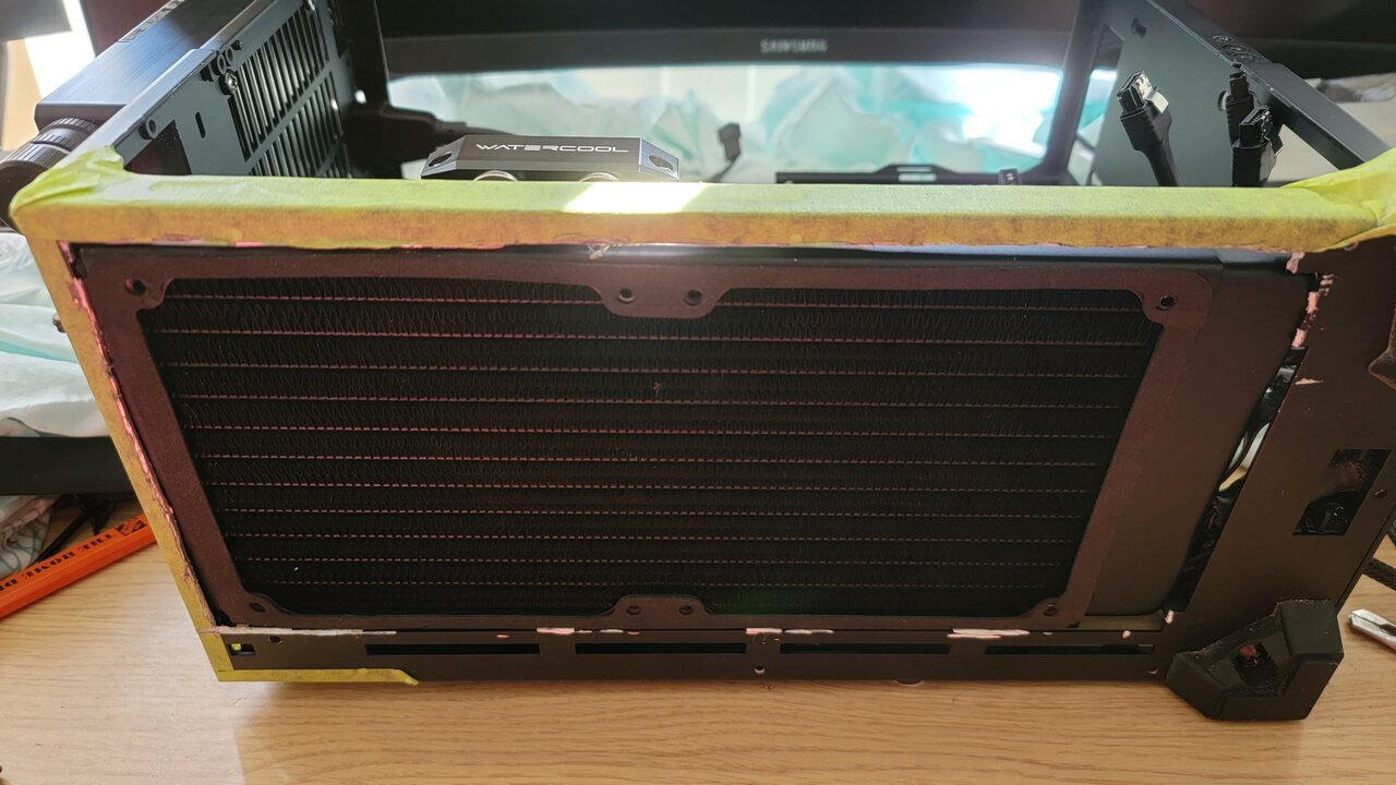

How is the bottom radiator attached now that there's no frame at the bottom of the case?
Actually, friction. I did cut hole that is smaller than radiator but big enough for main body(where you mount fans) to go past. And it rests on the feet of the case, small little let overs from case and pressed down by gpu, so it sits solid there. I only needed to sag it by like 2 mm or so since I also found a fitting that is about 1mm shorter than stock watercool blocks,  I think it is ekwb.
