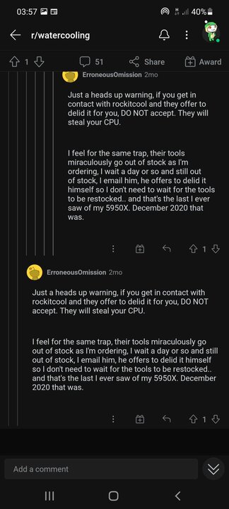

I was thinking of buying it but just saw this
And many review report not receiving anything 😐
i have the rockit cool tool and i also bought a practice G6900 celeron to delid before attempting it on my 12900KS and it was very straight forward.  I wouldnt ever send my cpu to anyone to have them touch it.  If my hands cant do it, then I wont bother with the project.  Ive learned to never rely on anyone but myself.  So with all that said, dont let the tool discourasge you from doing a delid. the tool works very well

If you are referring to Supercool Computer, both I and @iamjancohad the same experience. I created a Facebook account, which is against my religion LOL, and messaged them there. I also sent emails and created an account with that weird messaging app they use and getting the response was like pulling teeth. To say that their customer service is horrible would be an understatement. But both of us received the product. It took almost a month.

It is very straightforward with the delid tool. I own and used every version of the delid tools they sell, including the one for X299 processors. They all work well. I did send them a 5950X for the delid service since they did not offer the tool for sale, only the service. I got back the same CPU I sent and the service was timely. They did not send back the stock IHS and I had to email them to ask them to send it back to me. They assumed I did not want it since they installed the copper IHS.
They have very poor customer service in terms of being unresponsive to emails, which makes people feel very uncomfortable. I've exchanged emails with the owner a number of times. He is friendly enough, but doesn't give a whole lot of attention to unread emails. It seems like this is a trend among people in the fabrication business because the people at OptimusPC behave exactly the same. They probably are extremely busy and need to hire someone whose only job is customer service and support. Probably cannot afford to pay a salary for someone dedicated to that. I totally get that. I think all three companies do this as a side hustle because they want to support enthusiasts, but it's not their full-time occupation. OptimusPC and RockitCool are both owned by people that run a much larger custom fabrication and machine work business.
