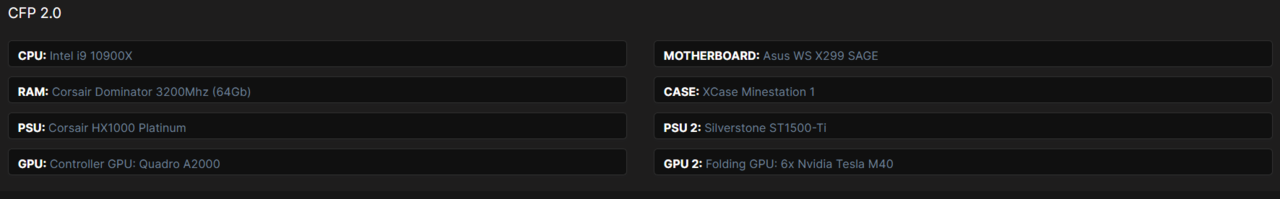

OK so the long show of it is I am looking to OC the CPU and RAM in the below RIG. Yes that is right, it is the CFP 2.0 rig. I have spent sometime re-working it recently so that I can use it for work and have it fold for the team. Granted the CPU & RAM OC will do little for F@H, however I want to get the best out of it for the more "Work" reasons.
The rig components are as below:

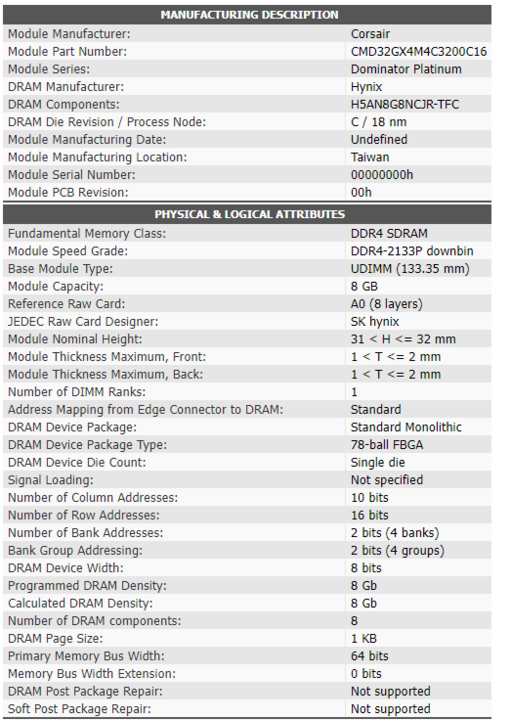

I ran Thaiphoon Burner and got the below results on the RAM.
Not sure how far I can take the RAM, with having 8x modules, the headroom will be limited by that, but I would imagine I can get more than the XMP rated speeds out of it.

When I moved my server from B-Die (16GB 3466 @ 4000) to Hynix C-Die (64GB 3200 @ 3400) I was too lazy do dial things in properly and just carried over my B-Die subs ¯\_(ツ)_/¯

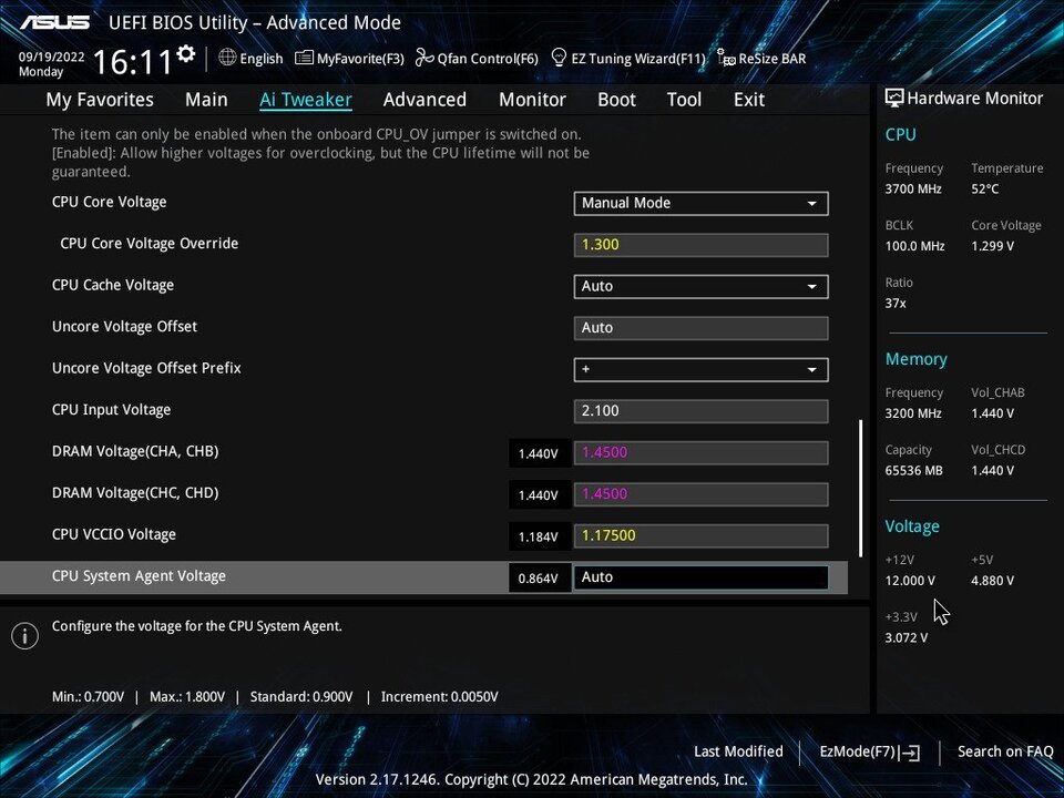

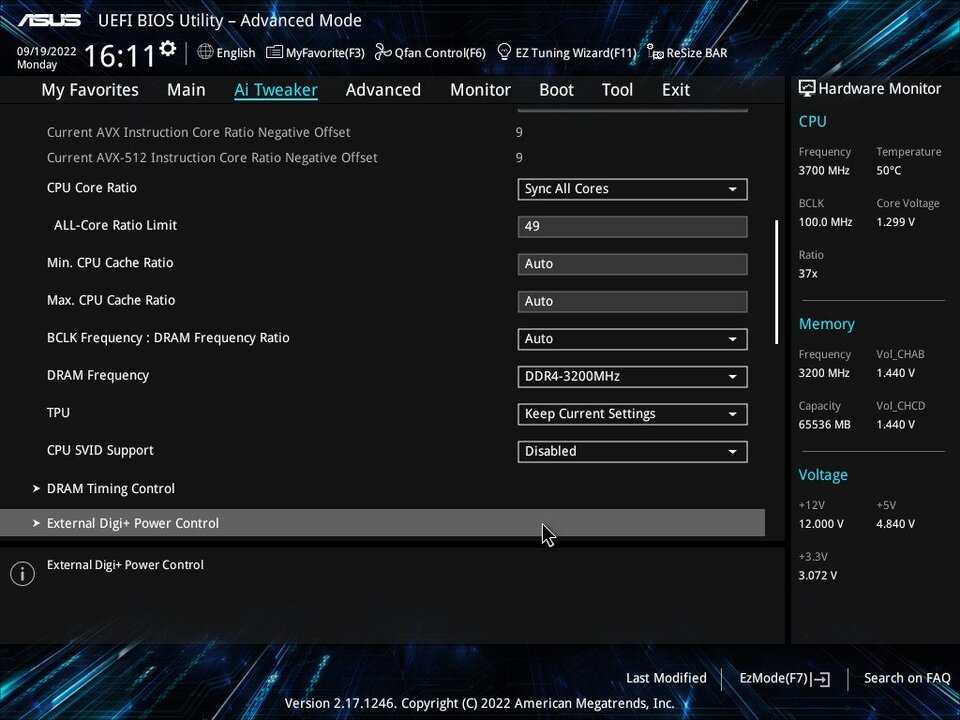

Hey guys,
So I tried my luck today with some Overclocking. I did not spend a huge amount of time on it and everything is fairly preliminary. I was trying to shoot for the 5Ghz range straight away (Trying my luck!), which may not be possible due to the silicon lottery. I was unable to keep 5Ghz Stable at 1.3 Vcore  when testing via OCCT and it may be a case I have to back off. I also dropped the AVX and AV-512 to their stock ratios as I wanted to make sure they were not getting in my way. I have no idea what is even a sensible ratio for these but I will get there later.
However before I start my next attempt. These are the settings I currently have plugged into the BIOS. Does anything stand out ? I also noted that while I could locate the VCCIO voltage, I could not locate the VCCSA voltages ? Anyone have any idea where that is hiding ? Motherboard is an Asus X299 Sage. On my next attempt I will back it off to 4.8Ghz and see if I can get that stable and go up from there.
Wish I could help E, but my last experience with Intel overclocking was a 4790k. I will say I found it far easier to work with than the 5900X. While all core OC on AMD did great with some multi-thread benchmarks, I found it hampered my single thread performance where PBO/CO could achieve higher single core clocks. I guess some newer BIOS versions let you get the best of both worlds now, but I haven't updated to try it out.
Contrast that to my 4790k system and it was as easy as setting a number while syncing all cores and bumping the voltage up if necessary and testing. Manually tuning Curve Optimizer on AMD on the other hand was extremely tedious.
I am not sure if Intel is as simple as it used to be given we have moved past the quad core era. But I guess I can just say good luck with your OCing endeavors. :eat_cheers:

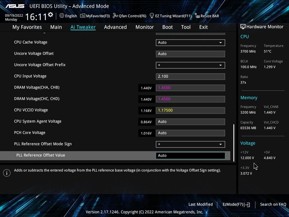

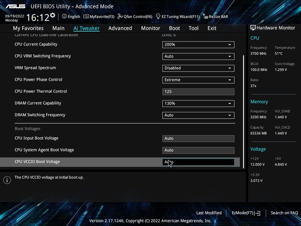

Here you have your VCCSA, AKA Voltage Common Collector System Agent 😄
I just love how every manufacturer decides to give something their own name, so you have to search for hours in a bios just to find out it was right under your nose..
All of the other settings seem to be correct, or at least how I would do it.

I agree with this as far as AMD vs older stuff goes, I don't have the same trouble with Intel though besides some funny things which are different between boards. In the end it's still boosting the BCLK or multiplier and upping a few voltages.
RAM frequency scales with CPU frequency. You should be able to achieve 3600 RAM clock at XMP with increased voltage. I would not be afraid to use 1.5v daily for DDR4 (With good airflow over the IC's). Agree with @Bastiaan_NL that you'll need a higher SA, anything less than 1.2v should be ok, but you should try to find what's stable less than 1.2v. Your AVX offset of 9 is a bit extreme (I get it for testing) and you should not have to do much more than 2-3 even at 5GHZ CPU frequency should you manage to achieve it. You could set min/max cache that would help your OC, but increased cache can lead to RAM instability at higher frequencies. -3 is usually a safe default I.E 4.9GHz all core CPU with 44/46 Cache min/max. The big question is "Safe" voltage for your chip. I have read through the 10900x datasheet, but couldn't find an exact voltage operating range for the CPU so 🤷‍♂️ If it were a 9900k, I wouldn't be afraid to run up to 1.36v daily under a good cooling solution. But as with anything, take it with a grain of salt and what you think your tech can handle.

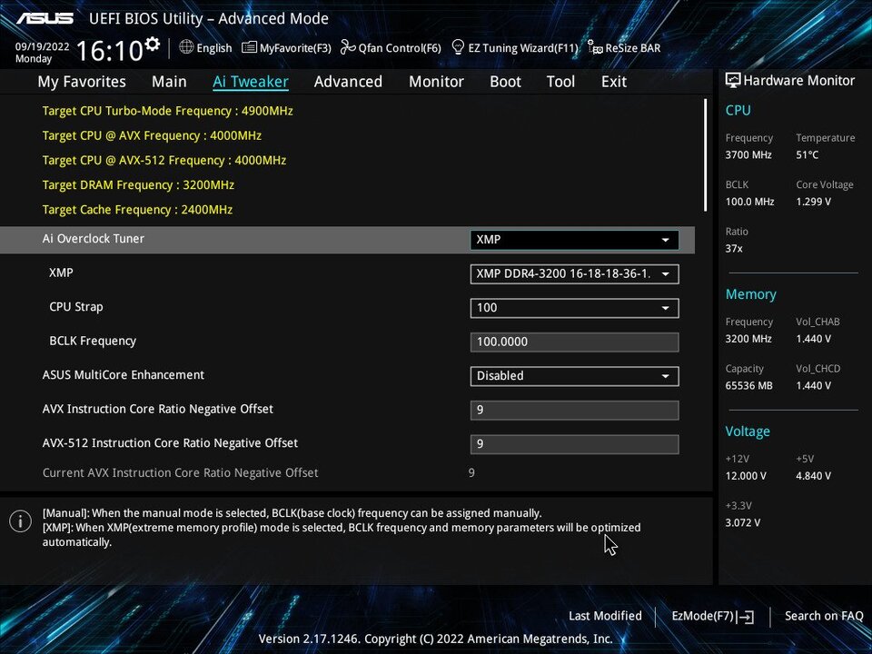

@ENTERPRISE increased the AVX offset to see if that was causing the instability. I think I ran no offset at all, cause yolo, but my voltage was higher (yolo again 😂).
As far as memory goes I think it should be able to clock a decent bit higher. I don't know what chips they are, but there is always something to gain. For now I would focus on the CPU though, 3200mem is fine for testing around 4.9ghz.
I've been reading about voltages some time ago when I was playing with mine and I found a lot of 'opinions' on the matter. The biggest issue is heat, 1.35 on this 10c20t will be pretty hot so finding a stable overclock at 1.3v is a nice goal and so is 1.2v VCCSA.

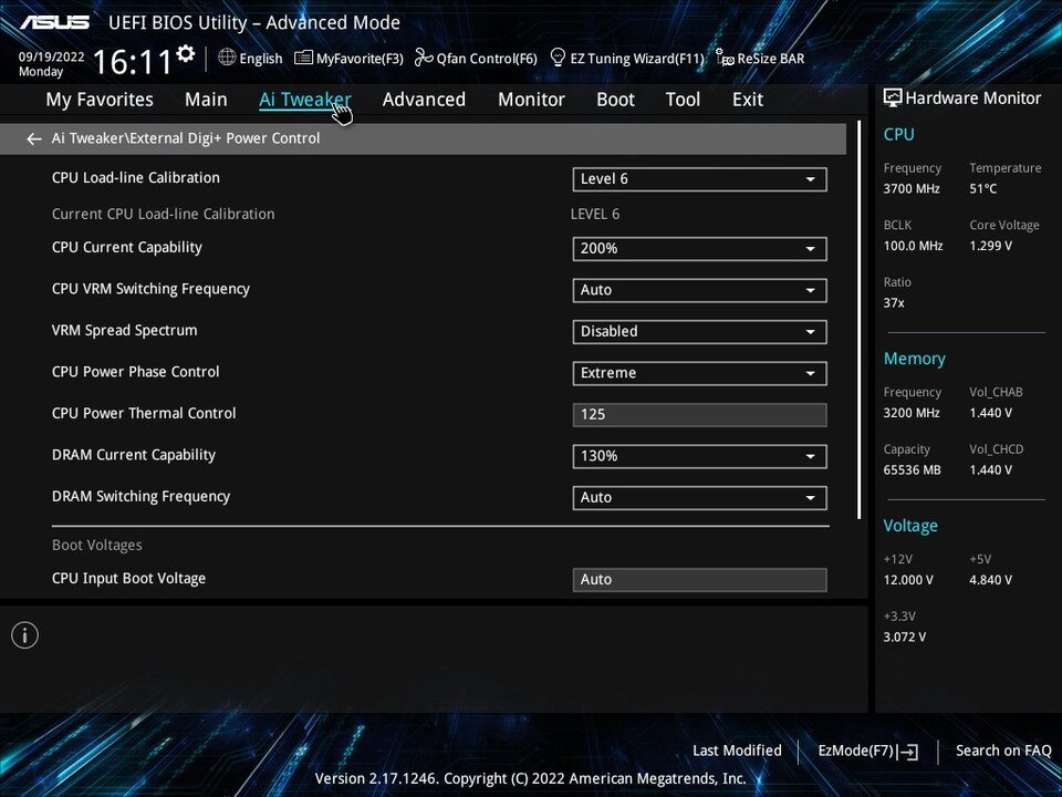

CPU VRM Switching Frequency -> max
DRAM Switching Frequency -> max
don't you need a golden chip for 5.0 with a 10900X? 4.9 with 1.3v is good for a 10900X. how are you testing for stability? you needing such a significant AVX offset makes me wonder 🙃
I knew it ! I Thought that System Agent might be it but I questioned it as they used the standard naming convention elsewhere, so dangerously assumed they would stick to one convention lol.
22 minutes ago, Avacado said:
RAM frequency scales with CPU frequency. You should should be able to achieve 3600 RAM clock at XMP with increased voltage. I would not be afraid to use 1.5v daily for DDR4 (With good airflow over the IC's). Agree with @Bastiaan_NL that you'll need a higher SA, anything less than 1.2v should be ok, but you should try to find what's stable less than 1.2v. Your AVX offset of 9 is a bit extreme (I get it for testing) and you should not have to do much more than 2-3 even at 5GHZ CPU frequency should you manage to achieve it. You could set min/max cache that would help your OC, but increased cache can lead to RAM instability at higher frequencies. -3 is usually a safe default I.E 4.9GHz all core CPU with 44/46 Cache min/max. The big question is "Safe" voltage for your chip. I have read through the 10900x datasheet, but couldn't find an exact voltage operating range for the CPU so 🤷‍♂️ If it were a 9900k, I wouldn't be afraid to run up to 1.36v daily under a good cooling solution. But as with anything, take it with a grain of salt and what you think your tech can handle.
Thanks for the insight, as it happens im leaving the RAM frequency alone for now until I get the CPU in a good place. Then I will start working on the RAM speeds and timings.
I will adjust my SA and change my AVX offset to something less extreme. As you say, I put it back to stock speeds as I wondered if it was the AVX OC causing me issues, however it looks as if it is a lack of Voltage on the System Agent.
I've been reading about voltages some time ago when I was playing with mine and I found a lot of 'opinions' on the matter. The biggest issue is heat, 1.35 on 10c20t will be pretty hot so finding a stable overclock at 1.3v is a nice goal and so is 1.2v VCCSA.
Yeah. I figure at 1.3v things will start to heat up. Easily will hit mid 90's especially as im just using an AIO rather than WC.
also don't you need a golden chip for 5.0 with a 10900X? even 4.9 with 1.3v is really good for a 10900X. how are you testing for stability? you needing such a significant AVX offset makes me wonder 🙃
Good shout on the CPU VRM and DRAM switching frequency.
Yeah, I think 5Ghz all core is for the cream of the crop chips. As I say, I was trying my luck with a dirty OC lol. Im thinking 4.8Ghz is more realistic.

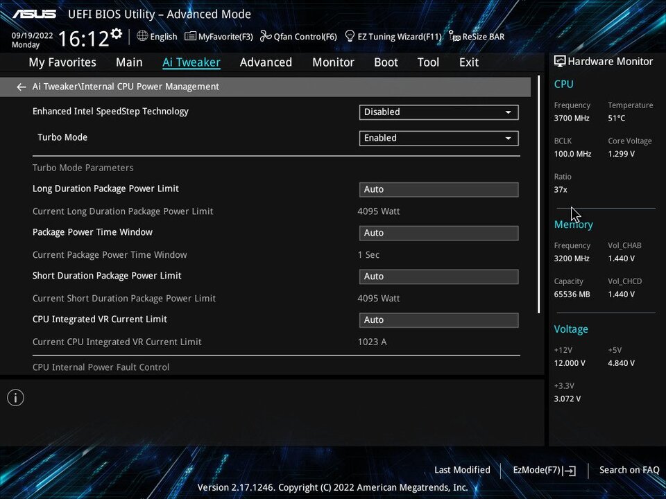

I'm pretty sure this board warns you about heat with the higher switching frequencies, the max frequency is way higher than on the ASUS Z690 board for example. I don't know how hot stuff gets around the CPU but some airflow over the board is not a bad idea if you go for that max.
I'm pretty sure this board warns you with the higher switching frequencies, the max frequency is way higher than on the ASUS Z690 board for example. I don't know how hot stuff gets around the CPU but some airflow over the board is not a bad idea if you go for that max.
😐 how much is way higher?
1Khz has been the max on VRM switching frequency my last few Asus boards, assumed that was the norm. going from stock (300hz?) to max on my 10900K didn't really have much of an effect on temperatures for me though.

I think it was 800 on the z690 and for the X299 I can't check it, pretty sure it was over 1k.
Some airflow over this board is not a bad thing anyways though 🙂
Yeah I will see about popping some fans over the VRM's for sure!
