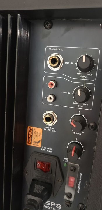

So, I'm trying to help a local church out with their technology needs, and they've got an interesting idea but I've never done it before.
Is there a way to connect speakers wirelessly, screens wirelessly (4, all displaying the same thing is fine), AND microphones (to go through the speakers) wirelessly to a Samsung Galaxy View SM-T670?
I was thinking maybe get one of those wireless bluetooth to RCA adapters Parts Express sells and use bluetooth for the audio.  They sell those usually for wireless surround DIY options, is basically what I was thinking.  Not sure 110% if there's a bluetooth option, but I'm sure there's something out there that's a bluetooth DAC basically.  I know Amazon sells some decent 3 packs of wireless microphones that come with a USB receiver that they talk to (I'd need to either find a Micro-B receiver / mic pair or convert).  Although I am curious what your guys' thoughts are on what the appropriate type of mic would be suitable for the situation.  So that handles KINDA audio, at least in theory?
But how can I get the 4 HDMI cables we have coming down the wall, and get those wirelessly into the tablet and duplicate the display on 4 monitors too?  Would I use like a Roku type device, or maybe a PC with appropriate Windows 10 capabilities of using wireless display tech or something?  Would that even work?  A $30 Roku sitting perhaps even up in the ceiling connected to the 4 TV's would probably be a lot easier to wireless
Picture very much related, its the back of his speakers (he has 2 just like this).  TLDR:  We're trying to get these + mics + 4x HDMI outs, wirelessly, from a Galaxy View with USB Micro-B, Bluetooth / Wifi.

Okay, I think I see a potential plus with that setup.  The mics could plug directly into the wireless DAC (which then goes to speakers) and bypass the tablet entirely for mics.  THAT wouldn't be too bad of an idea actually.  Then tablet can just send audio over BT (for videos), and video content over wifi to a Chromecast, Firestick or Roku, into the splitter, out to the 4 TV's.  Yay!  That'll work!
