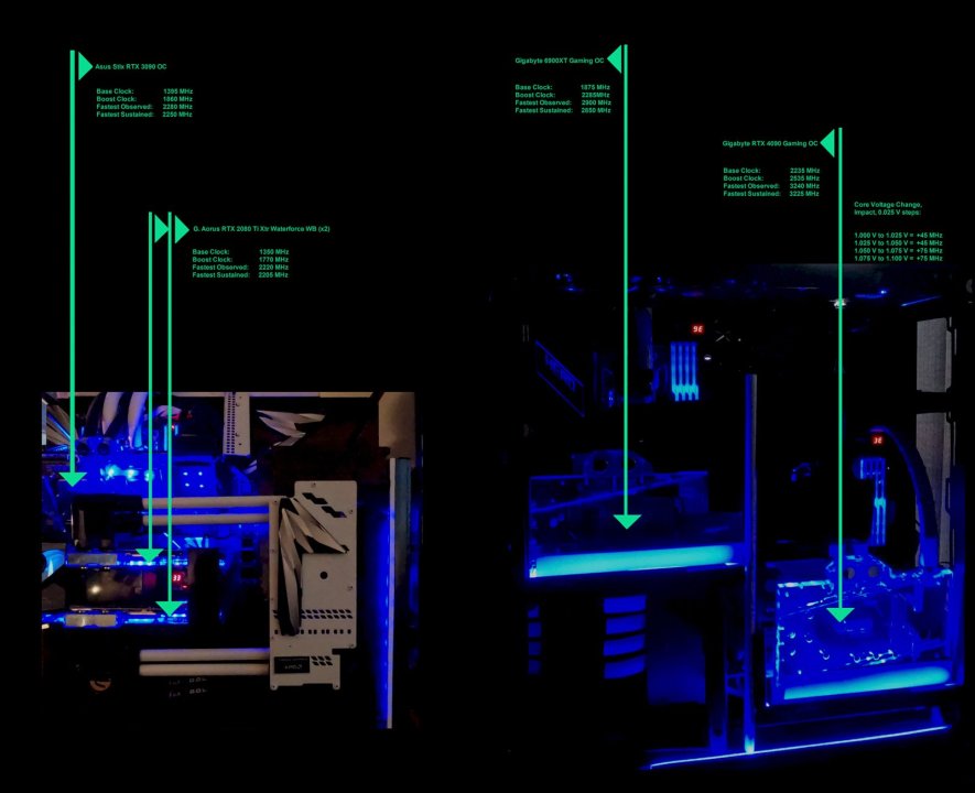

I run various system for work (including ML at times) and play - and certainly try to find the sustainable (error-free) limits, per screenie below on just my current work-play builds. I have used both AMD and NVidia cards for well over a decade, and AMD and NVidia are very different in how they handle the vbios-driver relationship, especially on power and voltages. It even affects your CPU OC at the limits (ie. for HWBot) as one GPU type requires a touch more CPU voltages at the limit.
