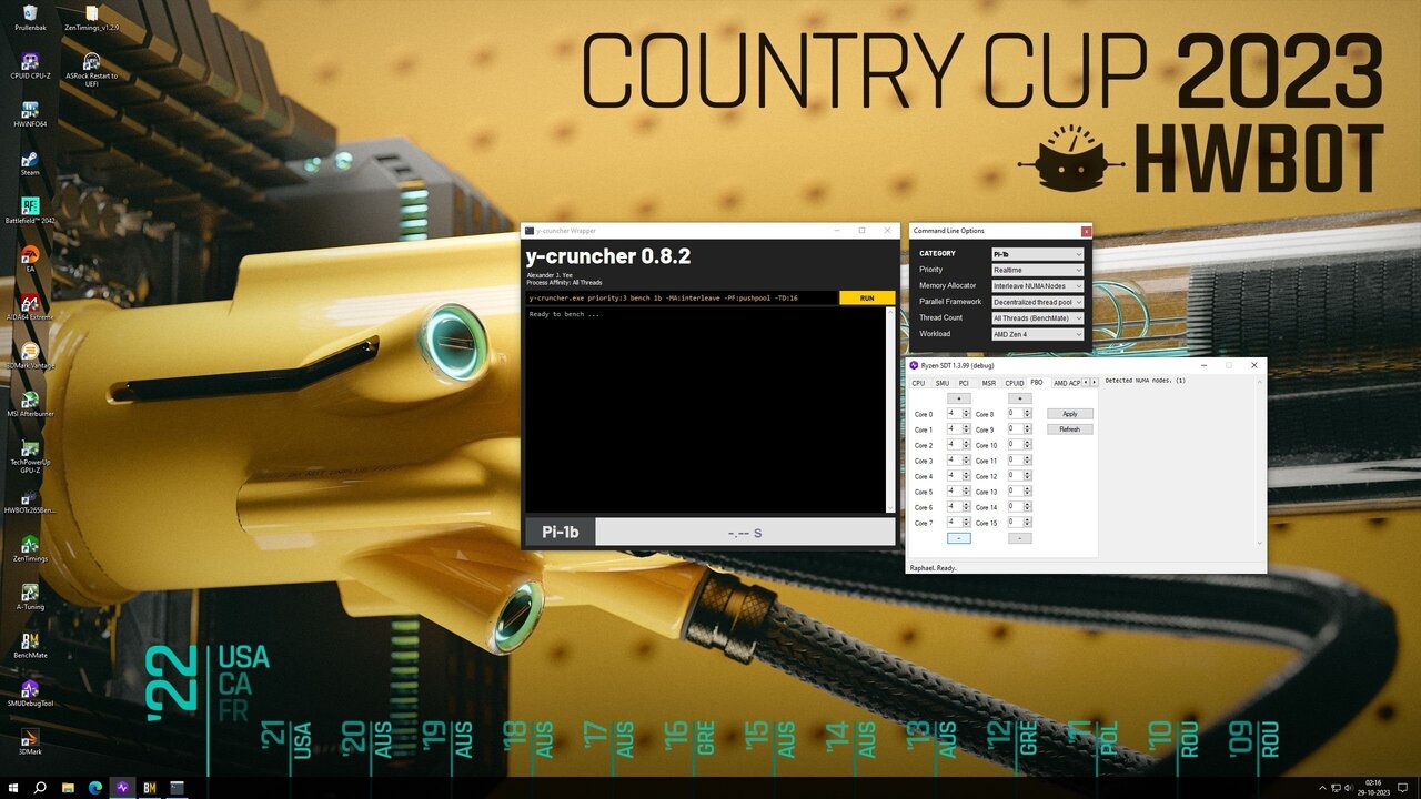

What i do to test my Curves is use this program : SMUDebugtool 1.3.4 , found it somewhere on overclocknet. It lets you play with PBO in windows. Then to test it, i run Ycruncher (something really heavy on the CPU and RAM) and lower the curve alltogether.
then start tweaking core by core. After it is done set the whole curve 2 or 4 points higher just to make sure. This isnt waterproof but 10x faster and way more reliable!

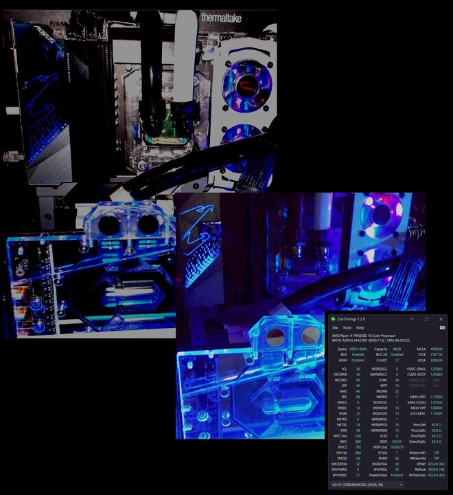

The DDR5 RAM was already pretty well cooled with an Arctic P12 pst fan right above it in my 670E setup, but I was rummaging around in some older boxes and found this genuine GSkill RAM cooler with dual fans, complete with blue LEDs 😃.  Believe it or not, it lowered RAM temps another 4 C - 5 C during longer RAM stress tests. Also, tightened tRDRD and tWRWR just a bit. The rest are still my 24/7 daily 8000 timings.

This is what I am currently testing, just with respect to how far I can push the FCLK. This includes all the AUTO values for things like ProcODT etc etc.
So while 2167 FCLK appeared stable after stress tests, it evidently was not as Linpack Extreme 8GB chunk cycles, using the standard 5 cycle benchmark would yield in progressively dropping Gflops as shown below.  (Running at 6600 Memclock)
However the 2133 seems to be rock solid stable  or at least far more stable as after stress tests and then running Linpack, the Gflops through 5 cycles remained consistent.  (Running at 6600 Memclock)
So I will stick at 2133 which is still an improvement thanks to this latest BIOS release with AGESA 1.0.0.8.

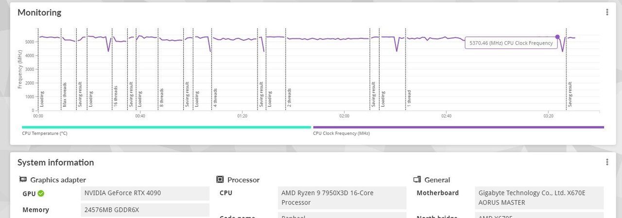

After 'eclk' and stock bclk tuning, I did some more custom bclk and custom CO; single core on CCD0 VCache can now hit 5370...hasn't failed  single test yet but I don't want to push the CPU over the edge, either...
More voltage always does the trick.

This is a 7950X3D, essentially voltage-locked 'upwards' - stork voltages in my earlier post (confirmed by HWInfo)
