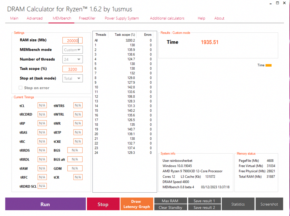

I really hope it's stable, going to run the memtest feature in the old Ryzen DRAM Calculator to 3200% coverage and see if it crashes, first I'm going to try Horizon 5 benchmark mode though to see how it handles games.
Memtest passed to 3200%!
Though since this is getting benched for hwbot eventually, I'll know for sure whether it's stable or not after that.
I'm over the moon though, look at the difference:
