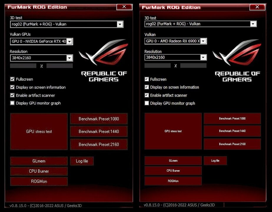

Addendum:  Also per earlier discussions, there are some up-to-date, quick tests to check and scan for artifacts (ie. below)...s.th. like that should be built into 3DM SystemInfo (which takes forever these days anyways 😡) for any card and model to make it a level playing field...
