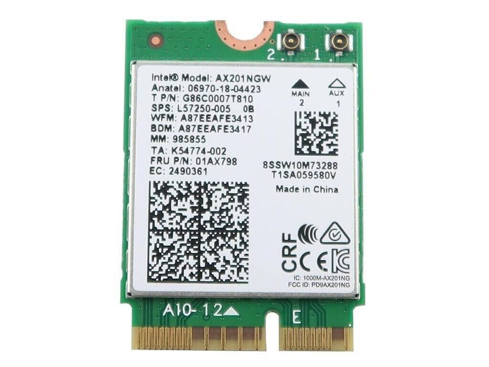

The Intel Chip is NGFF Key E. So long as the slot on the motherboard supports that, you should be fine. Also assuming this is going in a Laptop, that laptop will already have Antennae cables, you can re-use those as the connection points are a set standard so far as I recall.

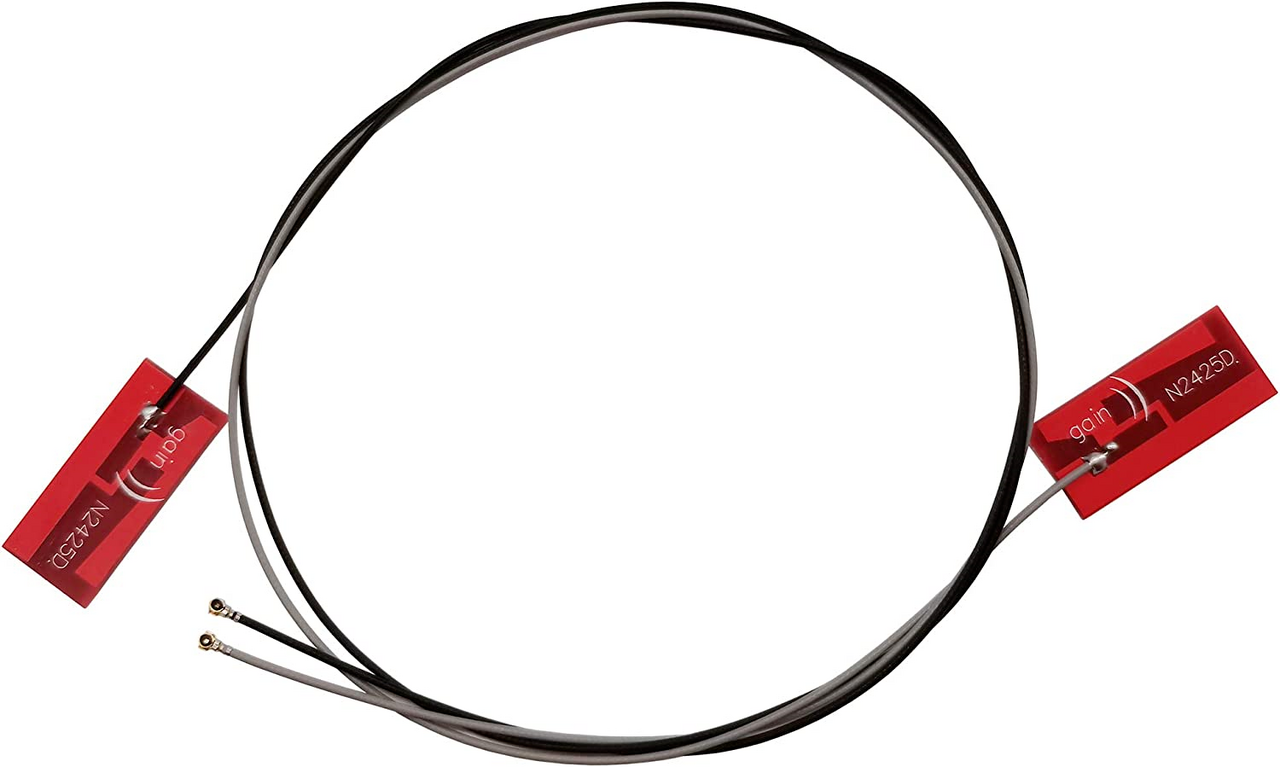

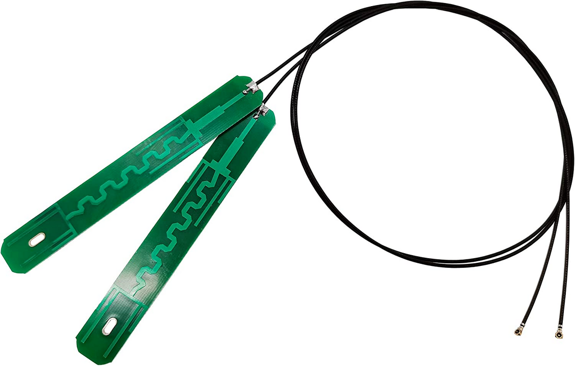

Thanks.  Well since the REALTEK RTL8821CE only has 1 antenna connection, my Mini PC only has 1 antenna.  So I need to buy some high gain antennas.  I found these, and I hope they will work.  I checked the dimensions of my mini pc and the dimensions of the antenna's and i think they will fit.
WWW.EBAY.COM
Find many great new & used options and get the best deals for IPEX MHF4 Antenna 2.4GHz 5GHz 3dBi Internal Laptop WiFi Antenna for M.2 NGFF at the best online prices at eBay! Free shipping for many...
WWW.EBAY.COM
Find many great new & used options and get the best deals for 2 X 8Dbi 2.4Ghz 5.8Ghz Dual Band Wifi Antenna IPEX MHF4 Internal Antenna with 50 at the best online prices at eBay! Free shipping for many...
1.thumb.png.ce2122734937ad36df4e80feb11a4244.png2.thumb.png.68c299a69c2854bd52f87dc22b2f3d2f.png3.thumb.png.68a59f3deac783cfe723a59788c4538f.png
Interesting, looks like the connection for the Antenna does actually differ, you learn something new everyday!
Good luck with your testing 🙂

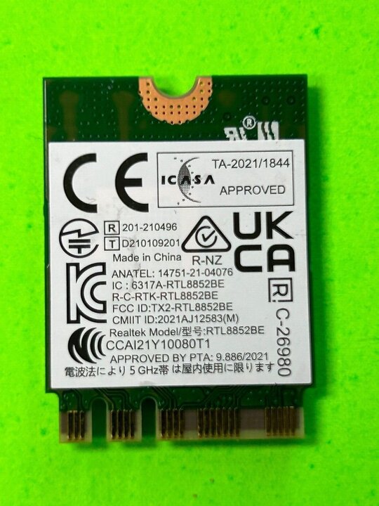

The Realtek RTL8852BE Wifi 6 adapter?
The AX201 is Intel only. However it is also dependent on the CPU as well. It won't work on every Intel platform. Because CNVio2 isn't compatibie with the older CVNio standard.
Basically avoid Intel cards that end with a 1. AX201/211/411 will not work with AMD. AX200/210 will work with AMD.
I would recommend AX200 wifi6 or AX210 wifi6e. Which should work with any platform. 6e is backwards compatible with 6.

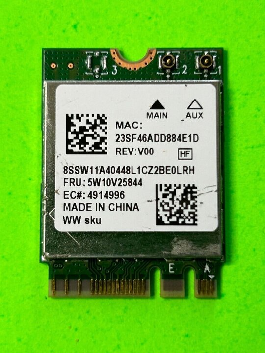

I got the RTL8852BE in & the antenna leads are smaller than the RTL8821CE.  What is the specification for smaller than RTL8821CE?
Looks like the 8821CE uses this connector
Ant. conn: U.FL
This is what I found :
  • Chipset: Realtek RTL8852BE
  • Antenna: 2 x IPEX MHF4 connectors, 2T2R
  • Interface: PCIe: WLAN
  • Output Power up to 19dBm
  • Support: Windows/Linux/Android

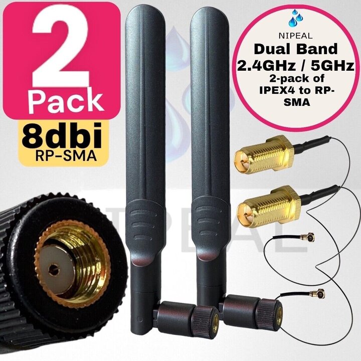

Will this antenna work?
2packdualbandwifi2.4ghz5ghz5.8ghz8dBiMIMORP-SMAMaleAntennaIPEX4.thumb.jpg.0404169913722341d55b9319a0a57663.jpg

I finally got my antennas and the RTL8852BE Wifi 6 ax adapter and man the signal strength is so nice & the speeds I'm getting are so freakin fast compared to before it's amazing.
