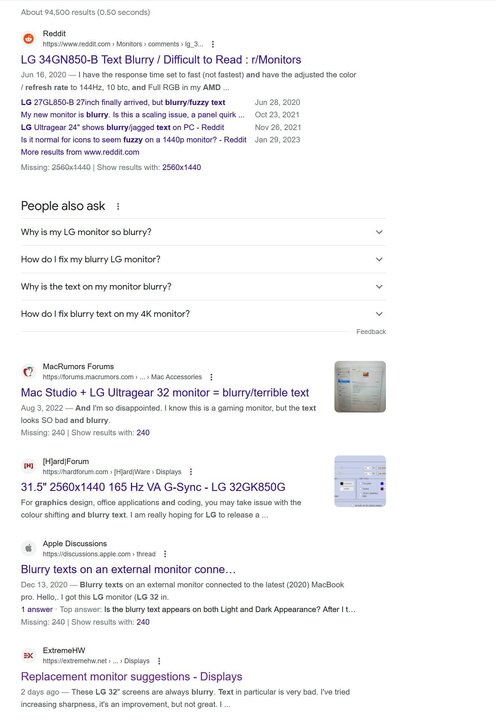

I've got 2 LG 32" 2560x1440 240 hz monitors.  I wish I could keep them, but I am experiencing eye strain.  Yesterday 10 minutes of desktop use resulted in blurry vision for hours, and eye irritation for 6-8 hours.
These LG 32" screens are always blurry.  Text in particular is very bad.  I've tried increasing sharpness, it's an improvement,  but not great.
I think my eye strain comes from forcing my eyes to look for detail that isn't there.  I'm not sure if it's a low PPI issue, or how LG decided to use rWbg instead of sRBG.  I almost switched to LG's 27" OLED, but it turns out that monitor has really bad text clarity as well.  Something about rWbg not being very good for text.

I am now using 2x Gigabyte M32U (32" 4K 144hz) monitors, and I'm debating returning them and getting Gigabyte M27U (27" 4K 150/160hz overclocked) monitors.  The smaller screen size might be preferable to me for a sharper image/text clarity.  I'll probably fire up cleartext and see how that goes for the next week or so before making a decision.  From what I read, the LG monitors don't play well with clear text, it was designed for sRGB/BGR, not rWbg.  The gigabyte panels should be fine, but the LG panels are unsupported.  With the prevalence of LG OLED panels hitting the market, it will be interesting to see if windows adds support for rWbg.

The 32" monitors I was using are LG 32GQ850-B.  I question how much of the issue is a text issue, vs a screen/panel lighting issue.  Before finally purchasing new monitors, I noticed that watching video for 10 minutes would bother my eyes.  The final straw was when I was looking at my blue windows login screen and realized, my eyes are bothered.  That was within 30 seconds of firing up my computer.  Since the monitor swap, I do still have some eye trouble, but it is significantly reduced.  I feel like I can recover in this situation, vs before when things were only getting worse.
For now, I'll be avoiding LG panels due to the unsupported rWbg, which includes companies like Corsair who use LG panels.  I'm extremely disappointed that all the new OLED panels fall into this category, especially considering they are the only panels that still use glass.
