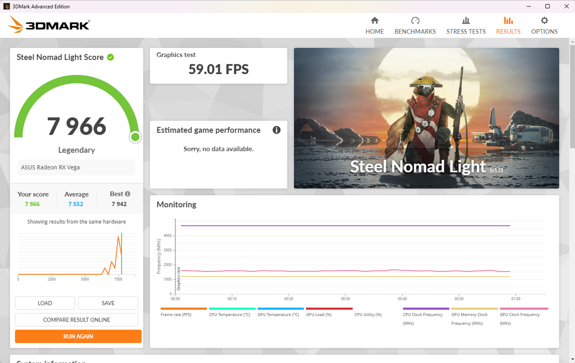

If anyone is interested I can help them flash the Powercolor Red Devil Vega 64 BIOS to their Vega 56 & Performance shall soar with my SPPT registry modifications.
So far I waxed the Vega 64's on Steel Nomad Light on 3dMark with my Powercolor Red Dragon Vega 56 on Red Devil Vega 64 BIOS with SPPT registry modifications & OverdriveNTool.
1710Mhz Core 1 Volt
1190Mhz HBM2
Fans go full speed at 40C so the Hotspot falls below 79C at full tilt with a 250W power limit & 250A current limit.

AMD Ryzen 7 3700X, AMD Radeon RX Vega 64 x 1, 32768 MB, 64-bit Windows 11}

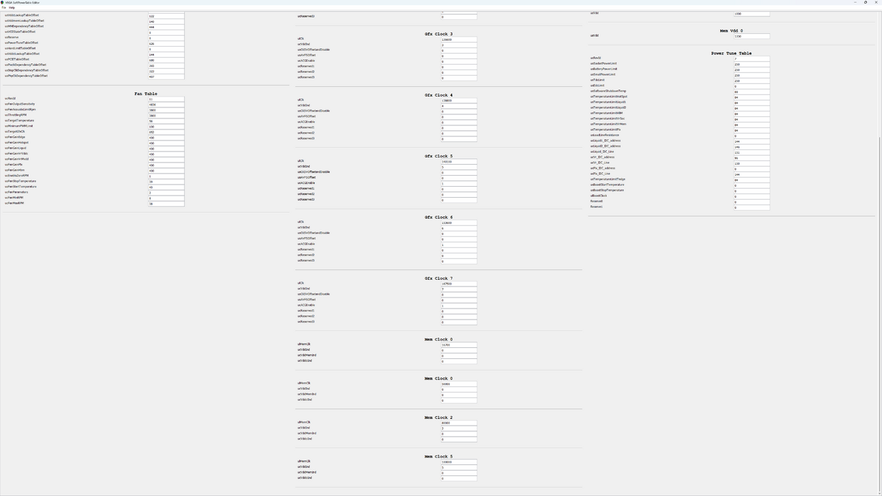

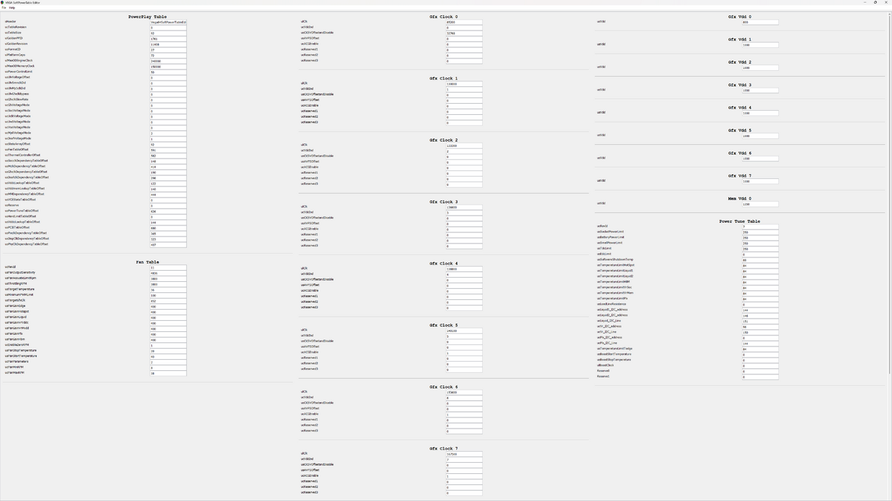

Yes sir.  I can provide my SPPT tables registry files.  I have found max undervolt is 900mv at 1500mhz max & 1710mhz core is possible at 1 volt with up to 1190mhz HBM2.
This archive contains everything from the atiflash293 for flashing the BIOS from vega 56 to red devil vega 64 as I tested the liquid devil bios and it had issues so i stick with   the red devil vega 64 bios.  The command is in there too to flash the BIOS first then you can use the modded SPPT tables.

Here's a video show casing one of my registry SPPT files.  Ask which one to use because I threw my whole folder in that archive which may contain unstable SPPT for 4K idk I'd have to look again, i guess when im not feeling lazy i'll post a description for each SPPT reg file.

Here's one I made recently it achieves stability with Topaz Labs suites & also performs top notch in game.
1675Mhz core from 1630Mhz stock Red Devil Vega 64 BIOS (PS - It can achieve maximum 1710Mhz for benchmarks but may gimp the fps to 15 so leaving the Core at 1675Mhz and HBM2 at 1000Mhz is optimal).
1000Mhz HBM2 is the max allowable writable in the SPPT.  That's 512GB/s.  Otherwise on 1080p benchmarks, 1190Mhz is possible.  Usually peak stability in game is 1172Mhz ie 600GB/s.
Down from 1200mV to 1000mV.  -200mV reduction.  84C temp limits with 88C shutdown for safety at the maximum extent.
Fans go full speed at 40C, so the Hotspot remains throttle free below 84C.
250W 250A is optimal on the Powercolor Red Dragon Vega 56 Cooler using the Vega 64 Red Devil BIOS.  Just to let you know you must open OverdriveNTool and reset and apply to get the reduction in voltage or do it within Radeon Settings Tuning.

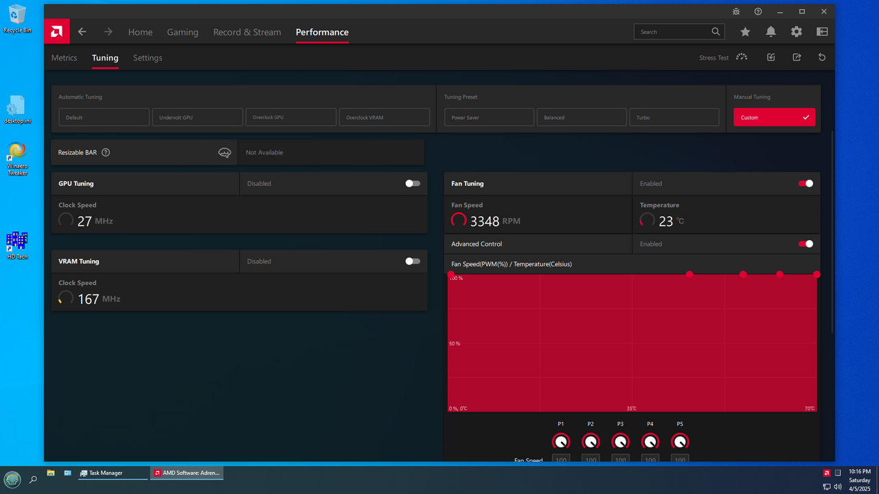

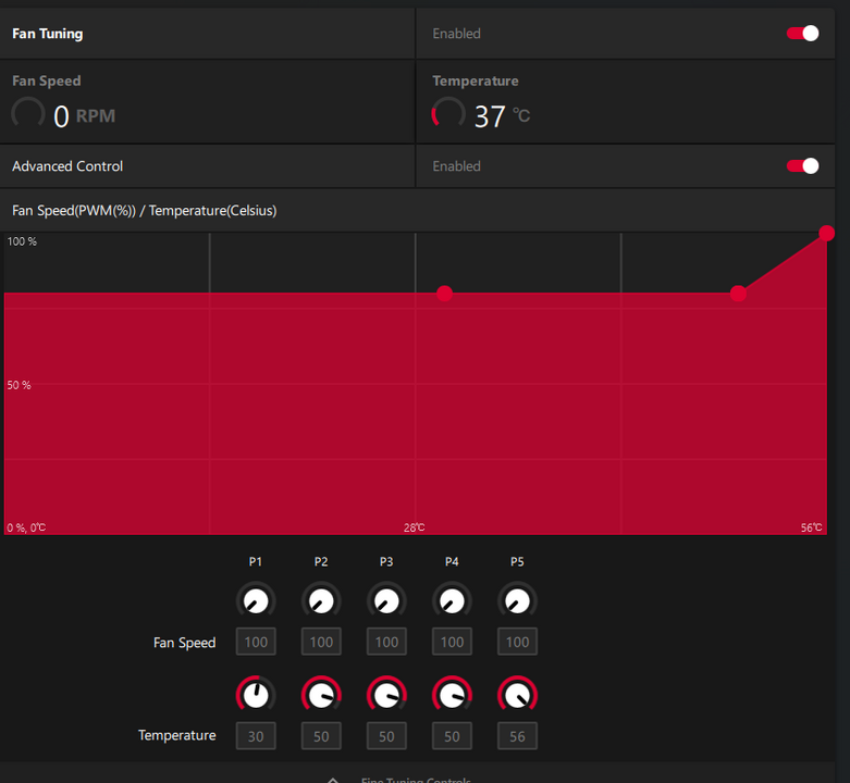

How many rpm does it turn @ 100% fan, go to amd radeon settings & crank to 100% & send me the rpm value.
@kithylinThis is a blind mod, because I didn't know the max achievable rpm.  Let me know what you think.  Post a video telling all about it, if you would, on YouTube?
~Be mindful of the long filename~
Simply save in safe location, double click, restart, good to go.  Let me know all about it.  Check AMD Radeon settings for changes.
Sapphire_Nitro_Vega_64_45c_stop_50c_start_zero_fan_on_2800rpm_acoustic_3300rpm_max_1225mv_200%_88c_shutdown_84c_operational_250W_250A_fan_tune.rom.zip
